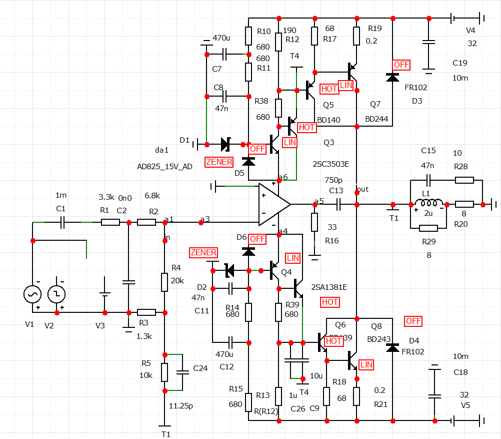

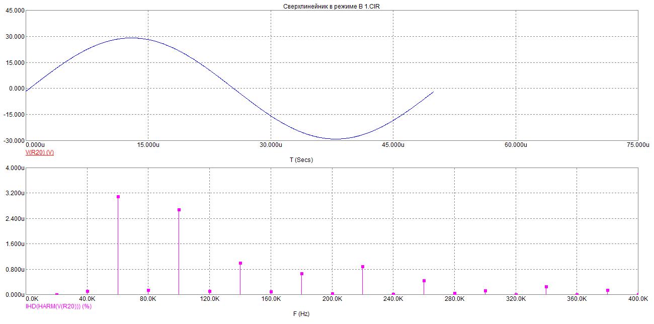

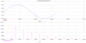

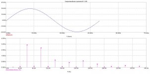

The power amplifier in the mode B.
Compact power amplifier in mode B. Is it worth doing or not ? Your opinion ?

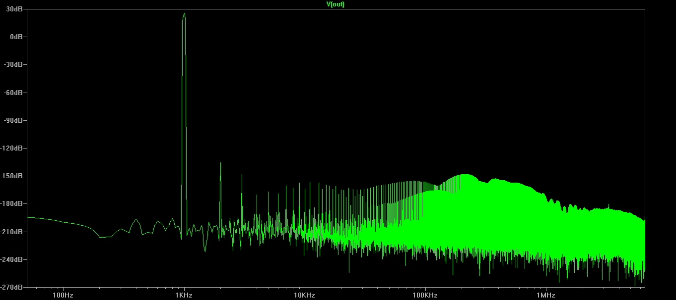

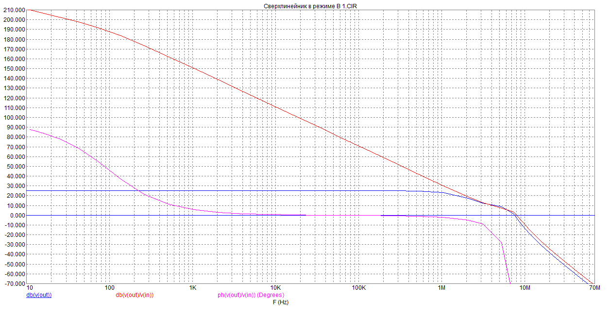

My Class-B amp (rated 150W/4R, 3mA idle current per output pair), simulated 100W/4R.
What do you say, is it good enough ?
(H2 160dB below fundamental)
How do you maintain 1ma bias on each output with thermal variation.
I still wonder what these 10 ohms in series with the input opamp supply are for, particularly the negative is decoupled by 1nF but not the positive.
Why both opamps are not AD825?
The quiescent current is maintained by local feedback in the output stage of the op-amp. There is no thermal stabilization.At low quiescent current, self-heating of transistors does not occur.I forgot to draw the 1NF capacitor .When modeling it is necessary to use full opamp models

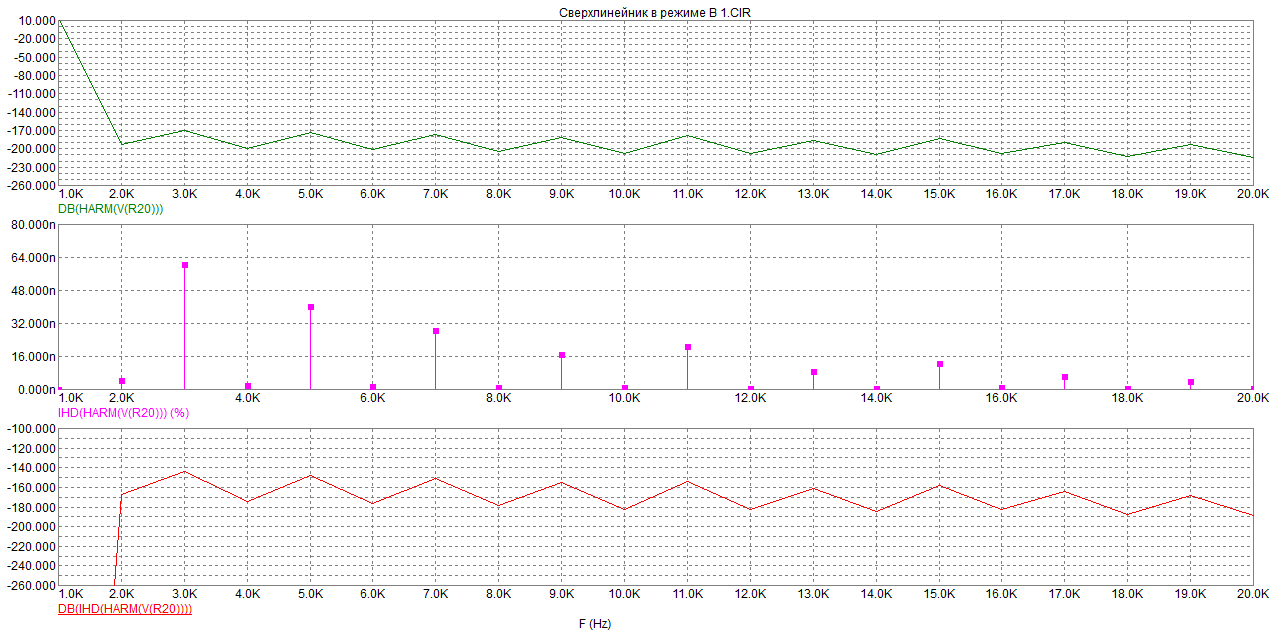

What are the good thd numbers ? -120dB at 20kHz ?
and these numbers ?
THD 0.1W/4R
1k -190dB
10k -137dB
20k -117dB
THD 1W/4R
1k -180dB
10k -137dB
20k -120dB
THD 10W/4R
1k -170dB
10k -136dB
20k -120dB
THD 100W/4R
1k -160dB
10k -134dB
20k -119dB
It is difficult to compare data from different simulators. Besides not knowing your scheme.Better tell us about the distortion on a small signal, where the influence of a small quiescent current is more noticeable.

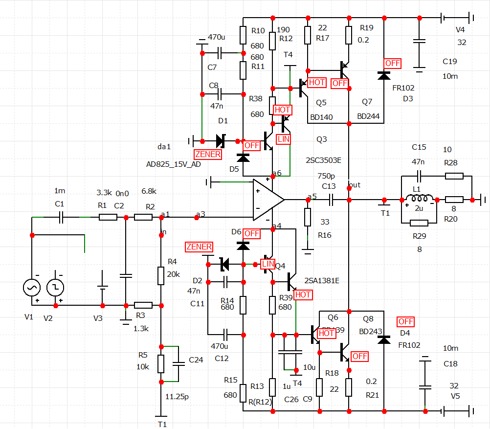

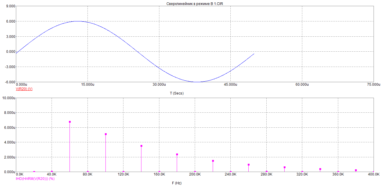

Graph of the distortion at low power . The quiescent current is 0.4 Ma per pair

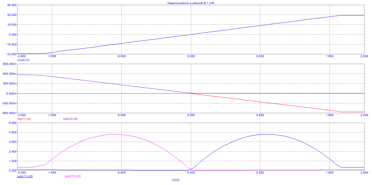

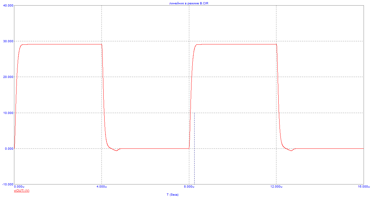

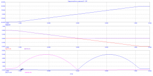

Continue. The scheme is based on the scheme from the old Soviet magazine "Radio" No. 1 for the distant 1989 year.The accumulated experience allowed it to be upgraded by eliminating the causes of possible malfunctions.The scheme can work in two classes AB+B and pure class B. The MS-12 graphs show the modes of active elements and the dependence and spectrum of Kg distortions at different power levels.So so on this forum it is customary to remove distortion at a frequency of 1 kHz ,then all measurements are made at this frequency.
In the distortion measurement archive.
