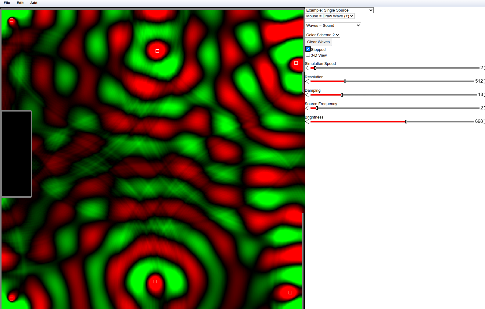

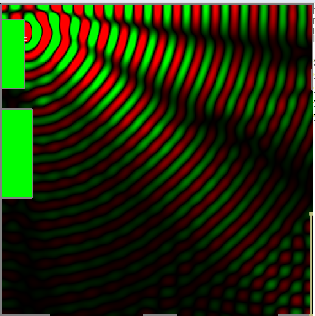

Currently, I'm working on designing a 40-400Hz woofer for my unity-based horn setup, and I've been experimenting with a ripple tank simulator (check it out here: https://www.falstad.com/ripple/) to simulate low-frequency room interactions and different configurations.

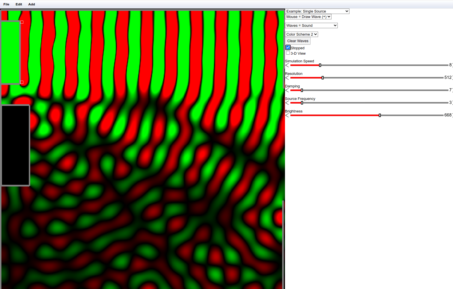

What I've noticed is that regardless of the subwoofer type, a single point source in the corner generates an initial wave followed by the entire room being excited. This leads to room modes dominating the sound we hear. However, when using multiple point sources across the room, I observed the excitement of every room mode, showcasing the complexity of bass propagation.

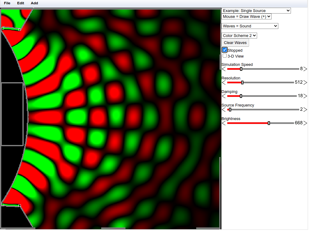

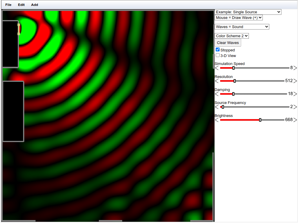

Now, let's investigate dipoles with baffle. They seem to produce a constant wave until they intersect, creating room-mode-like ripples.

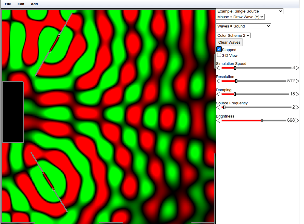

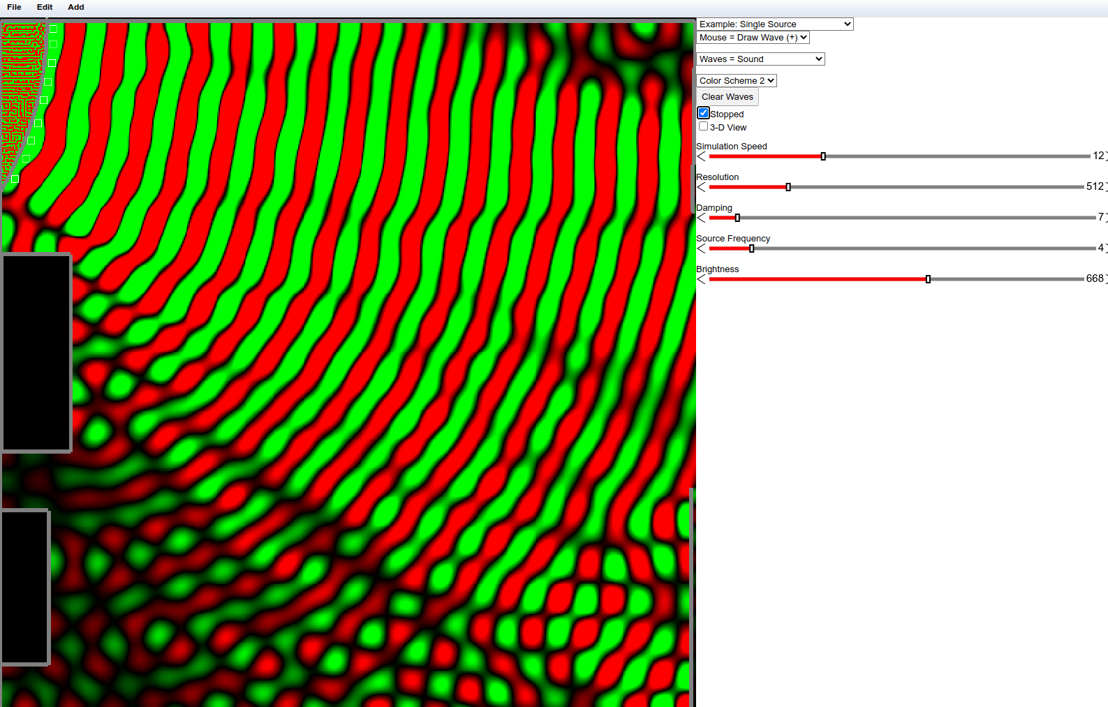

But what if we replace that with a larger, continuous radiating source, like a wide-mouth horn? The result is a more directional sound wave along the wall, possibly explaining the "dynamic" sound of bass horns.

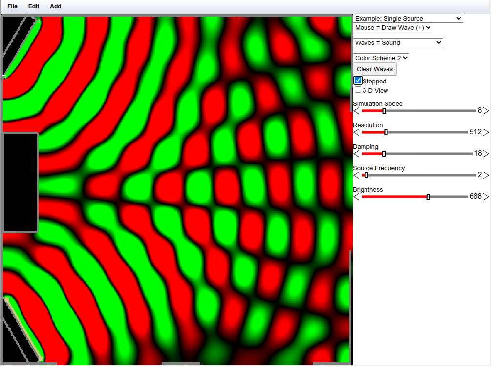

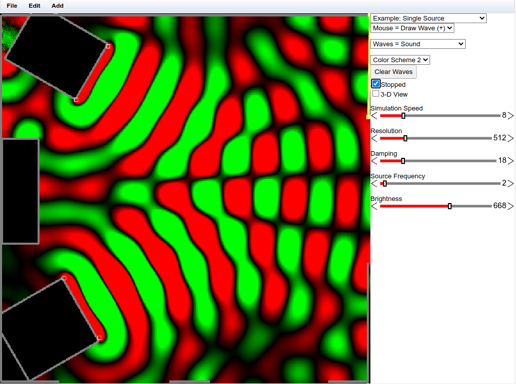

By angling the horns toward the listening position, interference can occur in the middle.
However, placing them further into the room, where the physical size of the horn positions the exit more towards the center, the direct waves seem to still dominate over room reflections. Note that this effect is particularly noticeable in the listening position in the center of the room.

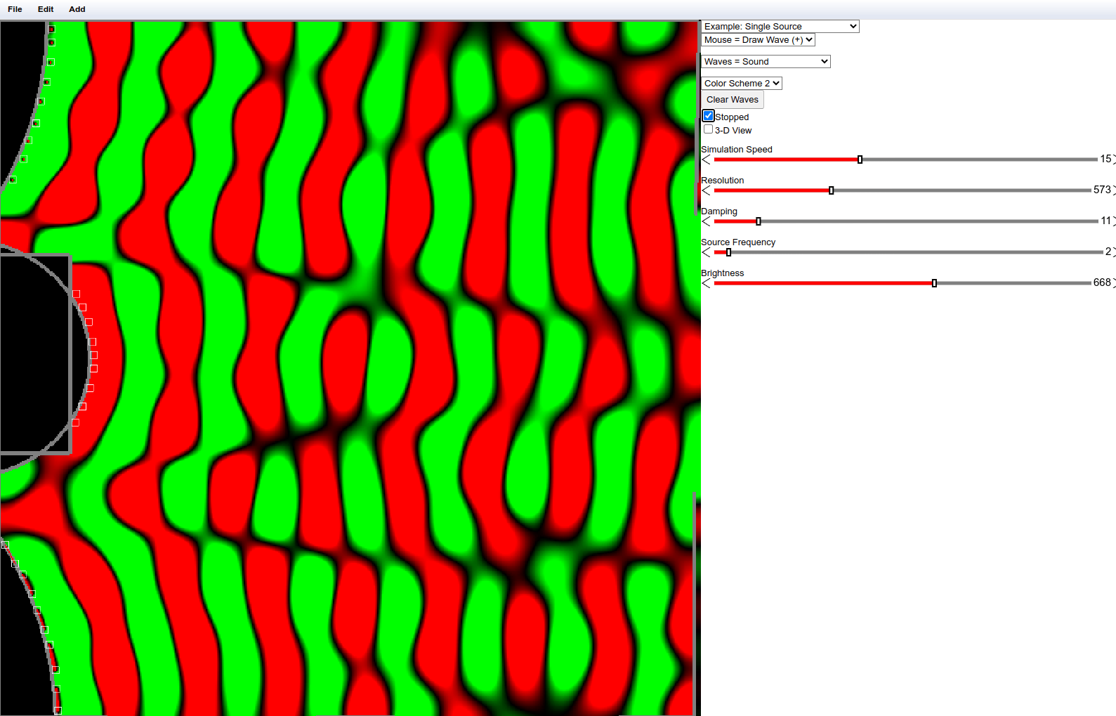

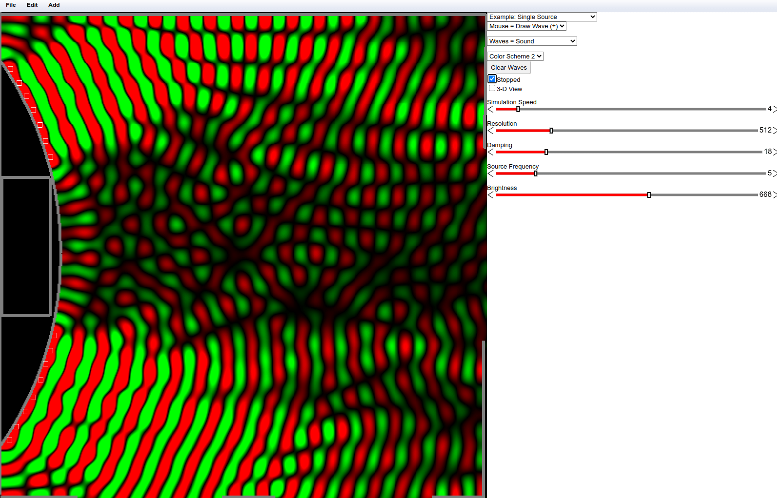

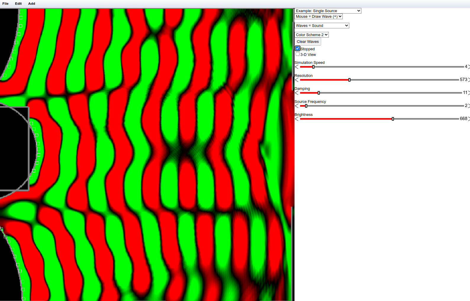

What if we explore a CBT (Constant Beamwidth Transducer) dedicated to low frequencies? Here's the idea: using a circular arc, I applied a series of point sources along with a single one strategically placed in the corner. The wall is then used to mirror the circular arc, inspired by Don Keele's CBT half-array against the wall. (frequency was accidentally adjusted higher, but you'll get the point)
Upon modeling a stereo pair configuration, I was pleasantly surprised to witness the consistent wavefront even in the presence of room modes. The simulation is pretty impressive, and I'm contemplating using a series of low-cost 6.5" woofers on a CBT array, positioned close to the floor to minimize speaker floor bounce. Another intriguing idea is to create two rows of CBT speakers, allowing for beam steering away from the floor by introducing delays.

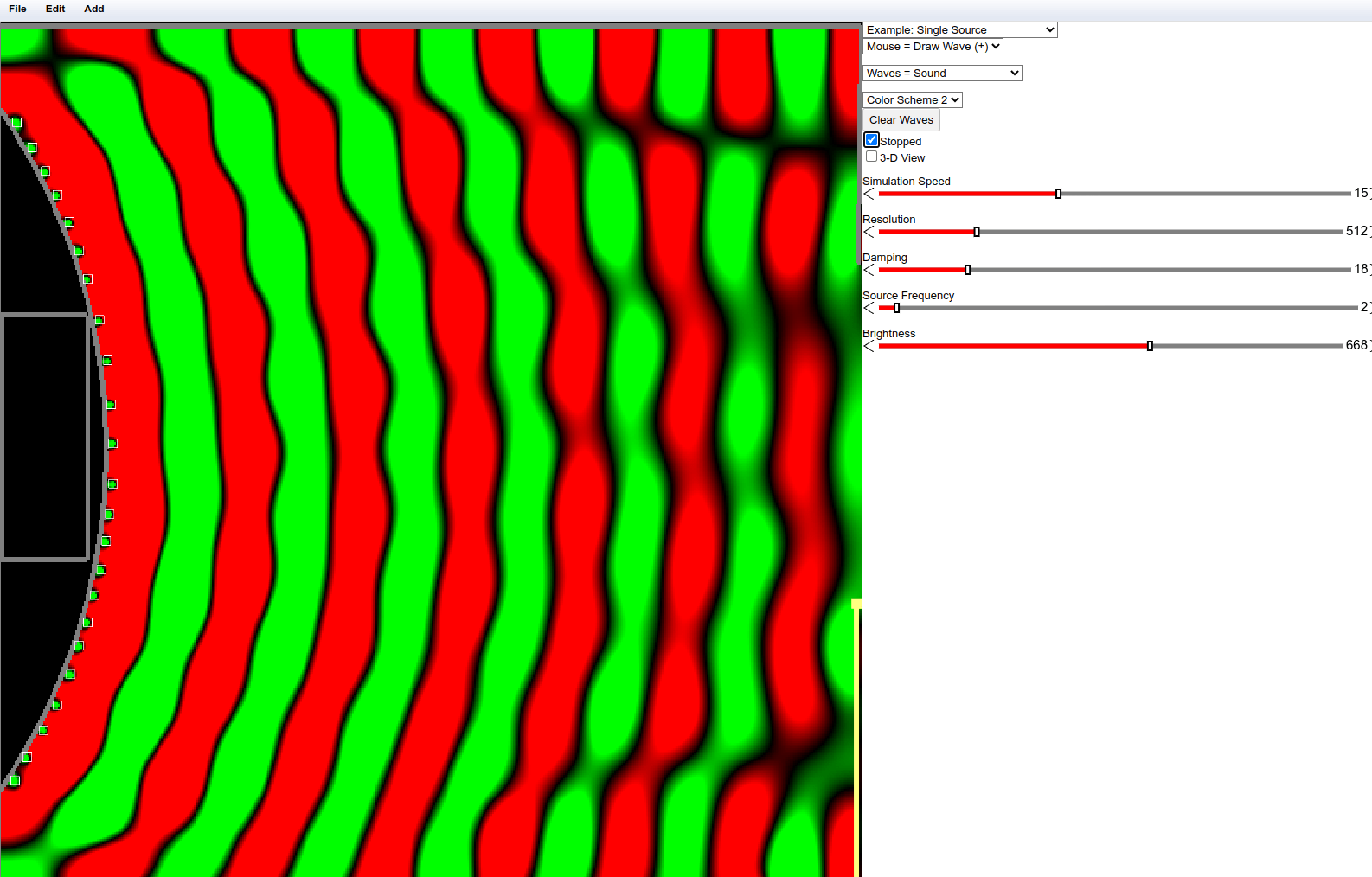

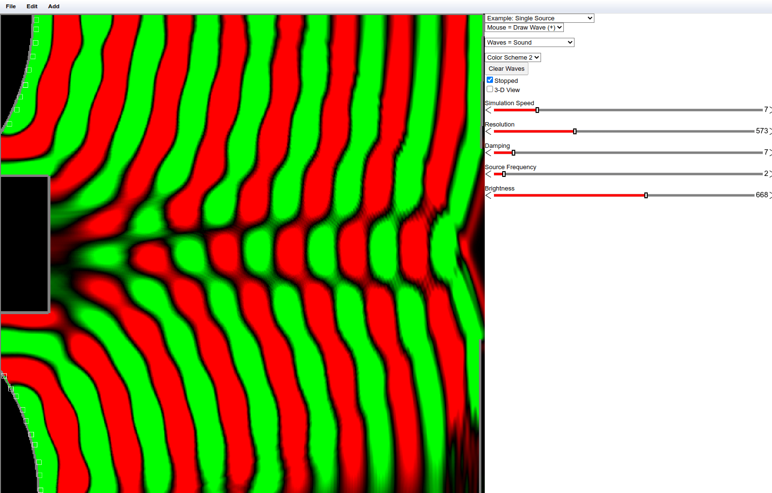

But why stop there? I modeled the fireplace in the middle and wondered about the possibility of extending the continuous array across the entire room. The result was an entire wavefront that seemed to dominate the room modes. Seems impressive!
