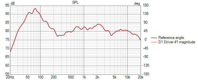

Regarding your point about the midbass dip and the differences from Paul's simulation, it’s important to recognize the limitations of simulation tools. Software like XSim and PCD can give highly accurate predictions if the inputs (FRD/ZMA files, acoustic offsets, and driver alignment) are perfectly captured. But in reality, even slight differences in mic placement, box stuffing, cabinet diffraction, or measurement techniques can lead to discrepancies of several dB. It’s not uncommon for DIY builders to see variances in the 3–6 dB range depending on their build precision and measurement setup. A 10 dB midbass null, while definitely significant, could also stem from room interaction or even mic distance—not necessarily an error in the original design.
You mentioned swapping the tweeter and running the system active—which is great if that got you closer to your preferred sound. But it also means the result is no longer representative of the original design. Different tweeters have different sensitivities, dispersion characteristics, and baffle interactions. Naturally, a crossover that was optimized for one dome will not work optimally with another. Likewise, moving the port, changing its diameter and location, or altering cabinet dimensions will affect both tuning frequency and cabinet resonances. These changes may well yield better results for your room and ears, but that doesn’t necessarily mean the original design was poor—just that it wasn’t tailored to your specific use case.

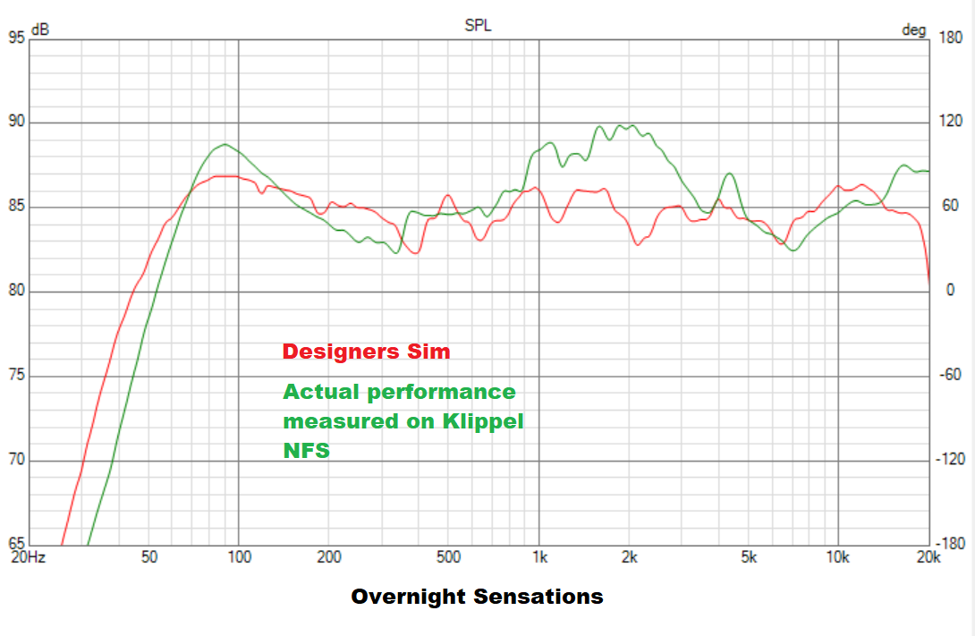

As for the Overnight Sensations and PE’s marketing graphs—while I agree that transparency matters, we also have to remember that the OS is a wildly popular entry-level kit, created over a decade ago, and never intended to be a measurement reference. It was designed as an affordable and great-sounding first build for many hobbyists. And for that purpose, it has succeeded immensely. Expectations should be aligned with that context.

He also measures the pit vipers after completion and gets a much closer measured response to Paul's than yours.
