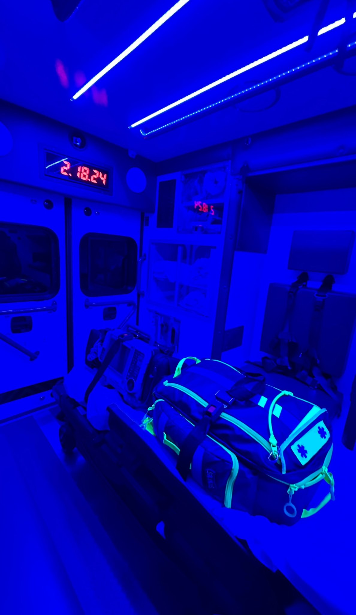

My kid is an EMT and took that photo during the ride to emergency site. Not for effect. Maybe they can see biological stains/blood spills better so they can wipe it down and sterilize it after they are done?I'm thinking that was added for effect. Judging by the glowing straps on the bag I'd say it's a blacklight with a lot of purple content.

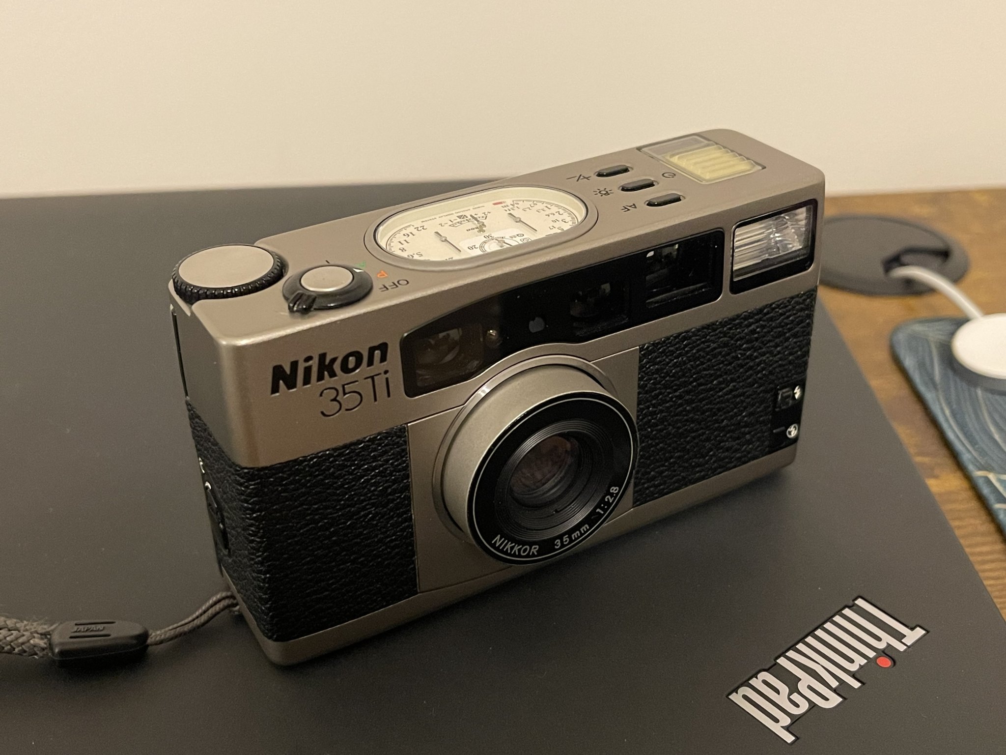

Haha. Yes, it was, and still is a special camera. Lovely sharp 35mm F/2.8 lens with in lens shutter. Matrix metering. Slow sync fill flash works at any shutter speed since in lens shutter. Nice bright VF. The analog needle pointer top dial is unmatched with the cool factor by any other camera though. Especially when the incandescent bulb back light is turned on.Your Nikon Ti35 is not a typical point & shoot camera 😎

Here’s a cool photo we don’t often see, this is what the inside of a state of the art ambulance looks like. My question is what’s with the blue lighting? Must be a medical or safety reason for it.
Not good for eyes though.

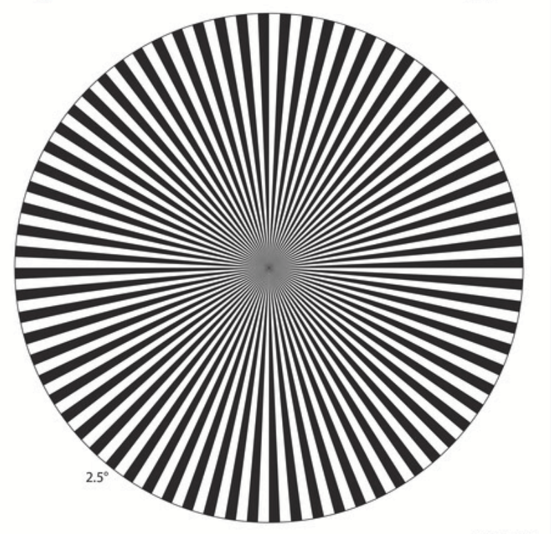

Not lately but I do have them drawn up in CAD so I can make any size or groups I want. For corner sharpness I'm more apt to use Siemen star targets.Anyone else use the USAF Lens Resolution Charts?
Ah! That makes sense. Blacklight is UV light, which can be used both to find fluid stains and to kill bacteria.Maybe they can see biological stains/blood spills better so they can wipe it down and sterilize it after they are done?
But yeah.... Not good for the eyes.

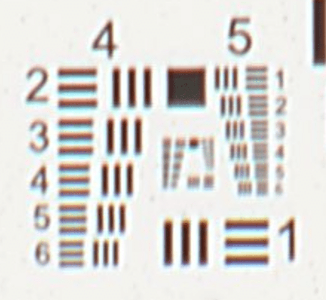

Epson V850 Flat Bed Scanner -- test slide -- how do you read this:
I'd need to know more about how you made this. I read that as being terrible. Looks like it was shot through a plastic bag. The chromatic aberrations on it are bad, but they can be partially fixed in software. This is not at all sharp.
I guess that's just a very small part of a test slide ...I read that as being terrible.
It's the SilverFast slide from some of the software packaged with the scanner. Looks like 5,3 pr 5,4, but not 5,5. 5,4 is 2290 ppi.
I can probably do better with a macro lens.
Silverfast is on plastic film. I have a glass slide from Edmund Scientific but it's at another location.
