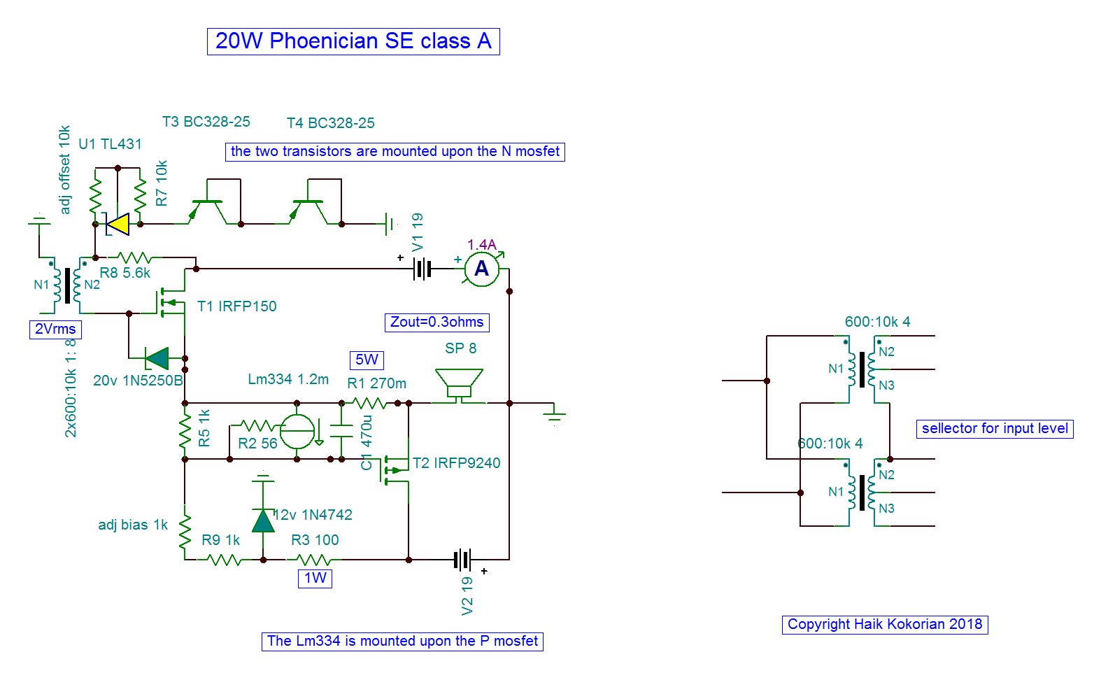

A Phoenician is a negative impedance load.
http://www.diyaudio.com/forums/chip-amps/302190-30watt-class-phoenician-amplifier.html
Here ,the Phoenician loads -RL/2 . It measures the output current and provides the same to the load , doubling the output power , decreasing the output impedance and subtracting the even order harmonic distortion with it's own.

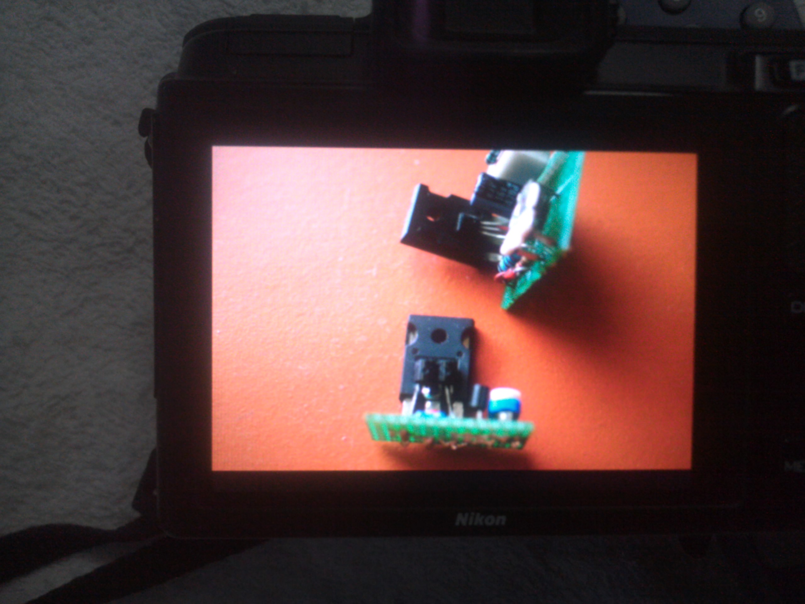

Each mosfet has it's thermal drift compensation of 4mv/C° to be mounted upon it with thermal compound after scraping off the writings . A piece of metal holds the sensors planked by the screw of the mosfet.
The input transformers I used are the following
https://www.aliexpress.com/item/600-10K-audio-cattle-imports-permalloy-audio-transformer-audio-balance-unbalanced-conversion/32800663069.html?spm=2114.search0104.3.20.4b5444171PdG1o&ws_ab_test=searchweb0_0,searchweb201602_2_10152_10151_10065_10344_10068_10547_10342_10343_10340_10341_10084_10083_10618_10307_5711213_10313_10059_10534_100031_10103_10627_10626_10624_10623_10622_5711315_10621_10620_5722413,searchweb201603_25,ppcSwitch_5&algo_expid=94f80244-499f-434e-b542-bd581d0aedc7-3&algo_pvid=94f80244-499f-434e-b542-bd581d0aedc7&transAbTest=ae803_5&priceBeautifyAB=0
The heat sink measures 20cm wide 10cm high 3.5cm thick made of 21 wings cools the mosfets 72C° at 30C° ambient .
It has a soft, noiseless start at 1.2A with offset 200mv , within a minute it is 1.3A with offset 70mv and passes gradually in 7 minutes to definitive 1.4A. It shuts down in silence.
This amplifier has HO compound (colorless , odorless , tasteless transparent) sound , makes it first choice amp for proximity studio monitor.
Distortion and frequency responce (50khz) are mainly due to the input transformers.
