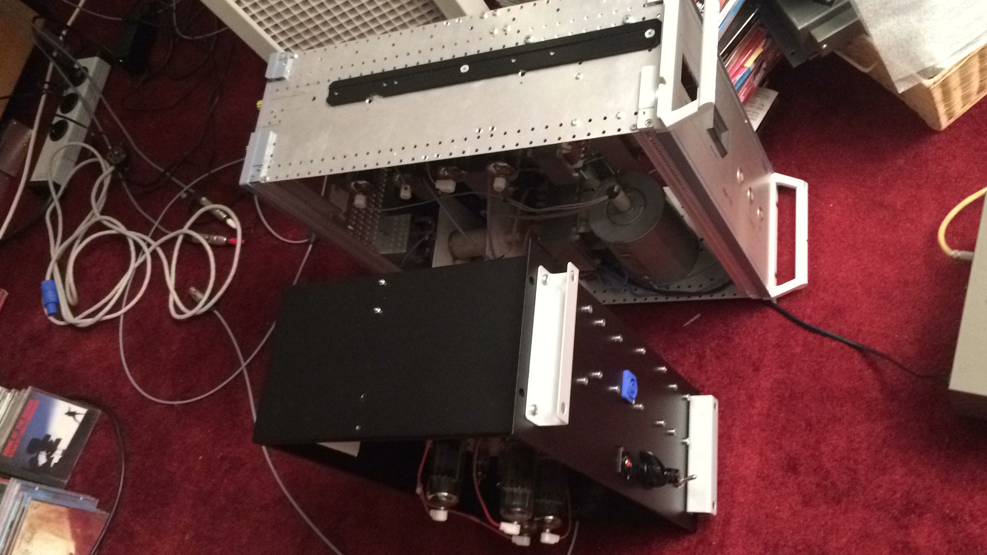

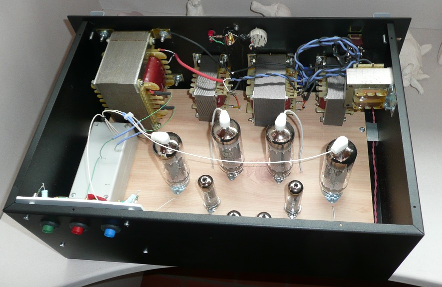

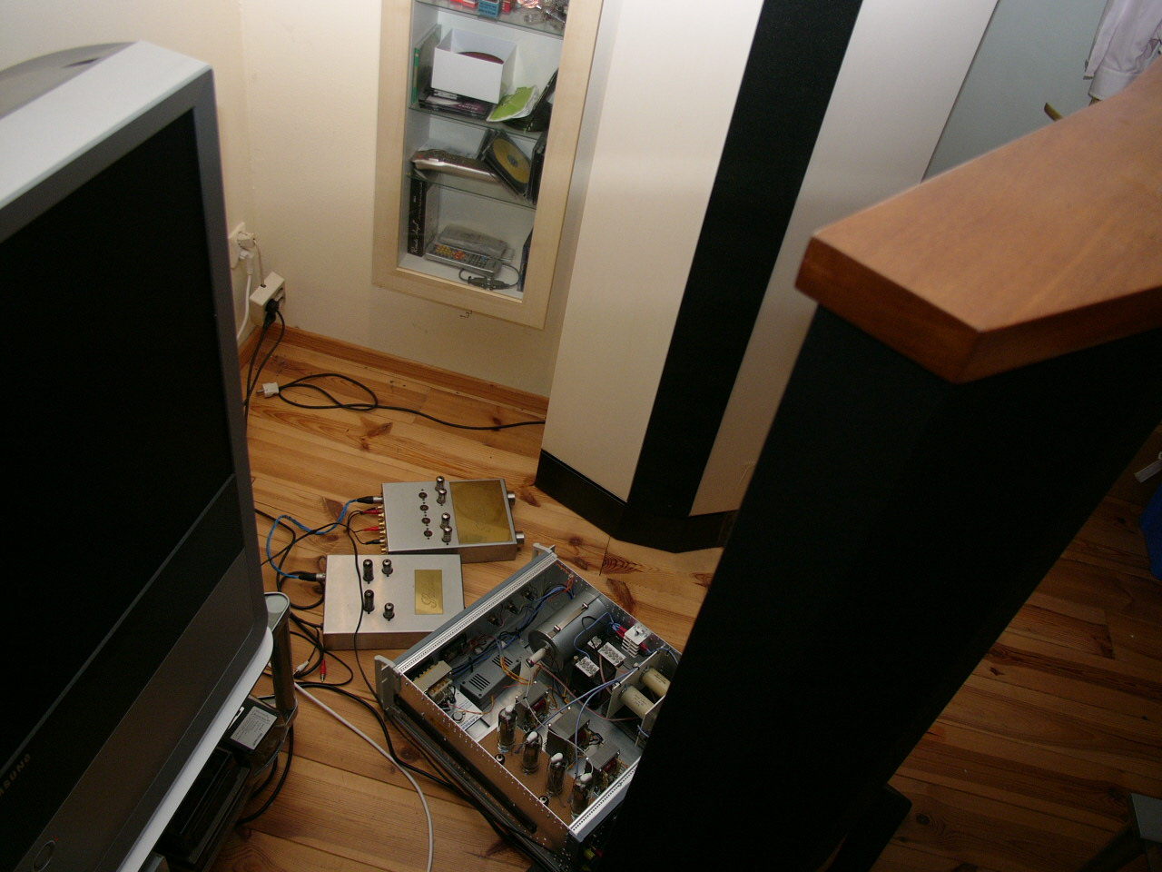

The issue with DIY ESL's i have is that i am not sure how long they will perform well. This issue can be found with commercial versions also. I found that Acoustat made some very reliable panels and therefore i do not need to make them myself. Only if someone here has enough experience in building long lasting ESL panels i would try building some myself.
The electronics part is not as difficult to master but the voltages need to be respected at all times !
