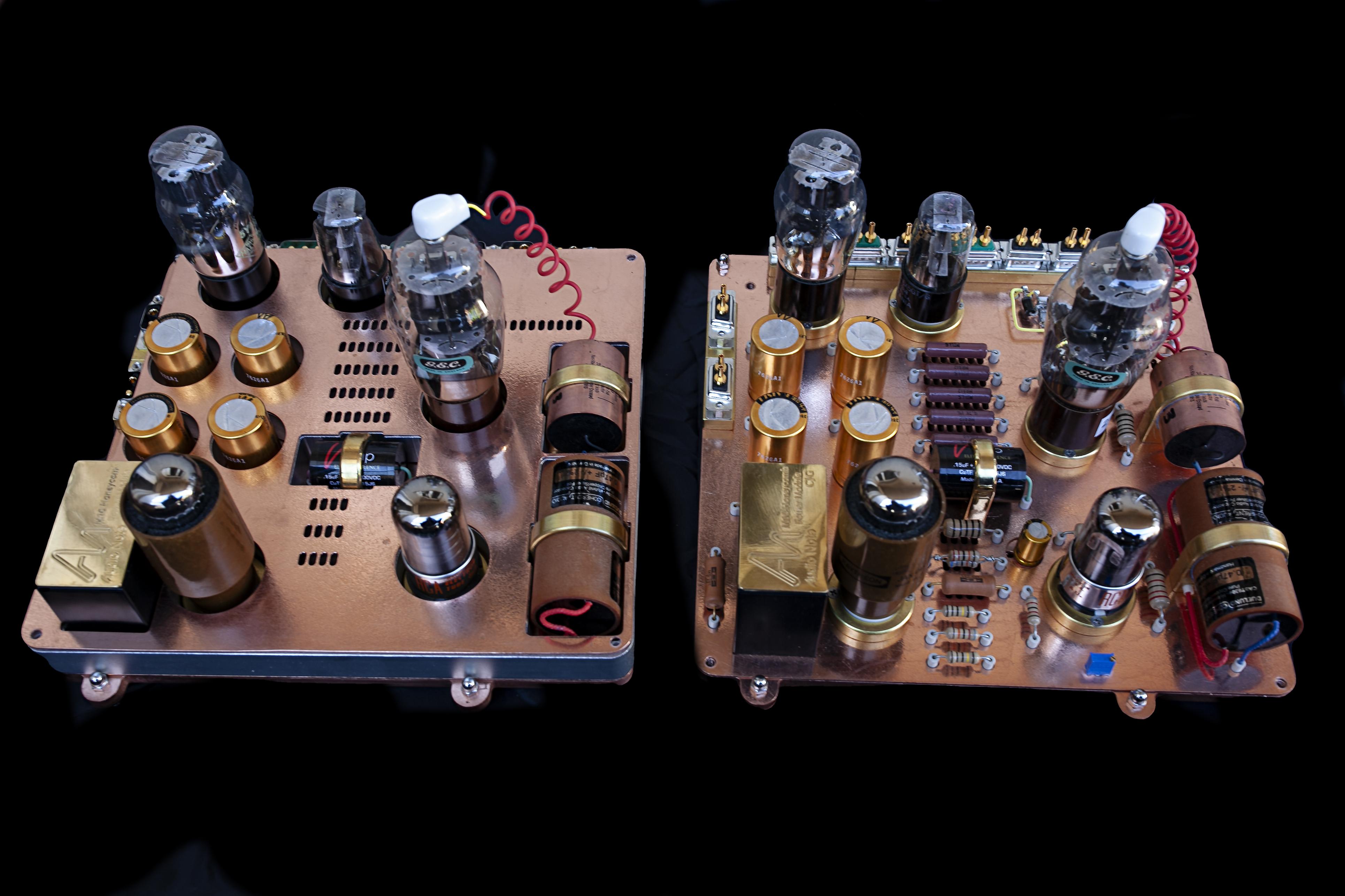

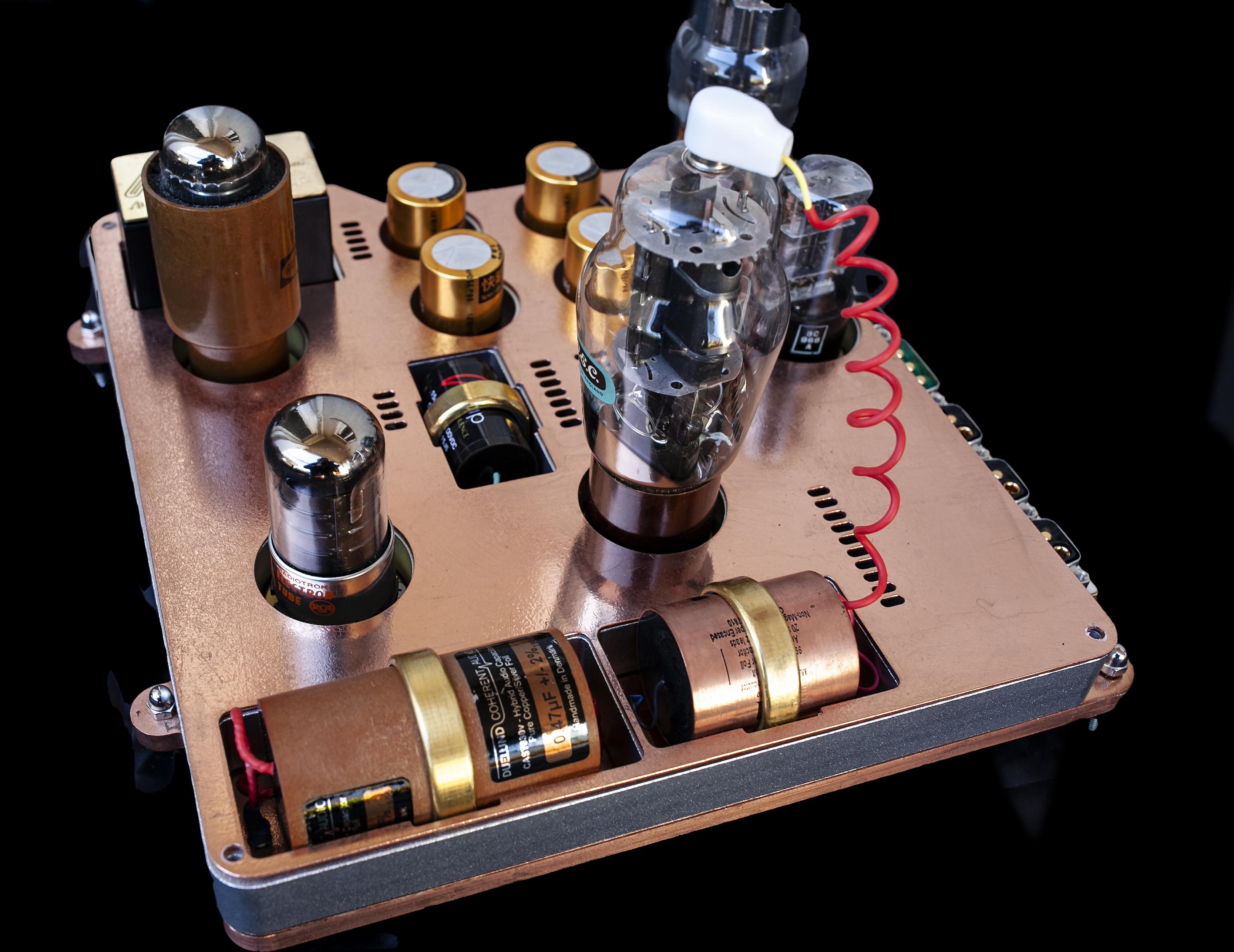

In my spare time for two years, I DIY the power module and amplifier module of the tube preamplifier
Amplification module
Power module
Power module

Fantastically excellent and wonderful.
You can describe it to us in terms of design and the tubes ?🙂
What is the frequency response of this amp as it has a lot of shielding adding capacitance to each connection?
It looks to me that this amp was not build to perform well only to look good.
Hello, Lampie519, this is the audio note m10 signature price, re-engraving the circuit DIYWhat is the frequency response of this amp as it has a lot of shielding adding capacitance to each connection?
You won the bet. Many people think that this design will shield high frequencies and various problems. When I tested it, I was shocked by its sound. The background is very quiet, the treble is floating, the sound field is open, and the sense of space is strongWell it looks good, I’ll bet it performs well too. Nice build
In the past, my DIY circuit boards were made of insulating boards. Compared with it, the sound has been greatly improved, the sound is clear, and there is no sound of electric current.

It's mostly true with semiconductor circuits as they have huge open loop gain and tons of feedback.With tubes even if it has feedback , the open loop/closed loop ratio is very small and bigger capacitances are allowed...tubes internal capacitances are also very small compared to most audio range silicon components...You can OVERDO circuts with lesser drwbacks when working with tubes.If no global feedback than the more shielding the better as bandwidth won't suffer too much anyway...What is the frequency response of this amp as it has a lot of shielding adding capacitance to each connection?

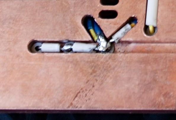

it seems care has been taken to insulate wires and joints with spacers etc. But Isn't it risky having high voltages solder joints in carved out slots of copper sheet ?

I think it's is beautiful. Having just re read the description, as a preamp and power supply the construction does not seem inappropriate. If it was me I would be a little more generous with the creepage and clearance but whatever. I don't know if you were aiming for a steampunk type of look??

A bit bonkers design wise but it does look nice, not really my bag with all the fancy caps showing their knickers but fair play to you for effort and thinking out of the box. Must have taken ages to fabricate, could we see the schematic?
In one of your pics of the bottom with all the routing/tunneling going through the copper it looks like there's quite a few spots where arching has occurred, a possible problem stressing the PSU? Can't see any mains earth, the lads at Elf & Safety or the Spanish equivalent might be having caniptions if they got their hands on it. Not having a go, am attempting constructive criticism.
