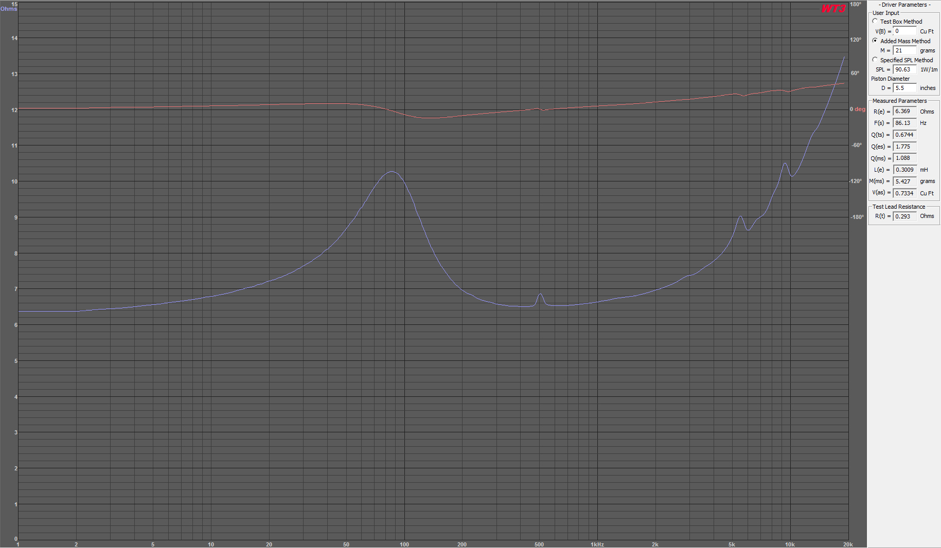

Another main driver worth considering?
Having spoken to Dave at DC Gold Audio, he indicates that his initial (not thorough) test of the 7" driver produced very positive results when walsh aligned. Note the spread cast basket and steep angle of the driver. These are full range drivers usually meant for aquatic use or for other harsh environments. I do not have the driver specs for these but I am sure he will provide them if asked. He quotes:
Size - 7", Power handling - 80W cont / 300 W max, Efficiency @ 1W / 1m - 92 db, Freq. +/-3d - 35Hz - 19kHz. They seem like the ideal test driver for this application. Unfortunately, they are not cheap and if they aren't good as inverted cones, well I suppose if you have a boat...
Web site= not so hot, the actual driver picture can be found on the home page and you see these on the auction sites. I don't have nearly $600 on hand at the moment for this project, but hope to at the start of the year. DC Gold Audio : N7C [N7C] - $ 279.11
The price of the DC Gold N7C drivers is per pair.
Here is some data you might find useful.
I have found that a Zobel consisting of 12 ohms and 3.1uF does a very respectable job of smoothing the top end.
As a woofer these things are capable of some ridiculous bottom end for their size.
In a two way they can be crossed over much higher than a normal 7"driver thus avoiding a x-over point in the critical area of 1-3k.
As a full range driver they do very well also, however, for this purpose the N7R is very worth the extra money.
Is that trace for real?
Thanks for the post, I am impressed. The physical driver size (elongated) and wide claimed FR seemed to indicate the potential. Nice find. Does the Zobel network reduce the efficiency of this driver? I noted the high R in the trace.
Juspur,
If you are listening to the back side of the woofer it needs to be wired in reverse or it is playing out of phase. It would be very easy for you to wire both drivers in reverse where the woofer would be in phase and the tweeter would be out. This is a common trick to smooth a tweeter in a 1st order x-over arrangement.
My estimation is that with only a 2.7uF cap your x-over point is going to be in the 7.8khz range. I highly recommend putting a zoebel across the woofer, 8.2uF and 5.6 ohm is a pretty good place to start.
