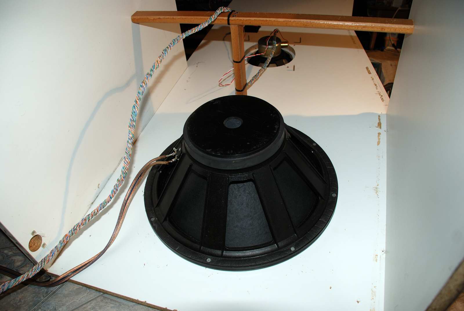

Yes it is an Eminence 18"
I don't know too much about it yet.
I asked Eminence info, lets see, what they say about it.

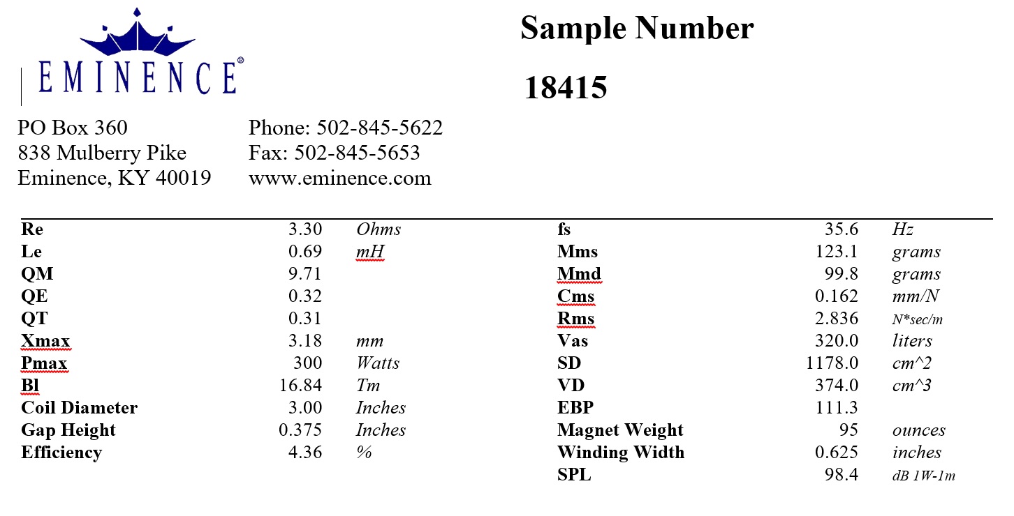

Due to kindness of Lucas Anthony at Eminence I have got T/S parameters.
See below.
In truth the seller said, speakers are refurbished, during it 4 ohm voice coils changed to 8 ohm.
I have measured 5.6 and 5.7 Ohm DC resistance and 8.9 and 9 Ohm impedance at 1 kHz respectively.
Also measured inductance these were 1.37 and 1.32 mH.
I'm quite sure these are more efficient than my previously used Eminence Beta 15.
These has a much bulkier bass.
At the same time Betas more fast, obviously due to much lower Mms.
So you must to believe to Papa, if he say something to good, then it is good.
At least what is regarding audio. :)
