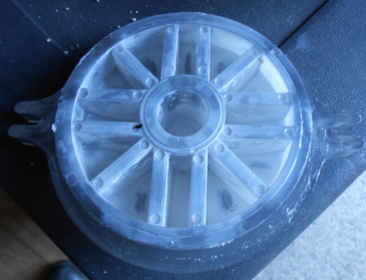

Youngest fckr here switched on the pool pump without checking the valve setting.
Without a cooling water flow, the air in the impeller-diffuser cavity reached such a high temperature that the interior surface of the pump housing started to melt.
Goes to show how much heat air friction can generate, even the strainer cover turned from transparent to all-milky.
Rejuvenating the electric motor and new seals didn't help, not enough pressure build-up to generate a flow, only with an open exhaust.
Fortunately a new pump assembly was under $600.

if impeller , then it's friction , not air friction
rubber to housing
in case of air friction ( centrifugal pump ) , new seals will solve the problem
