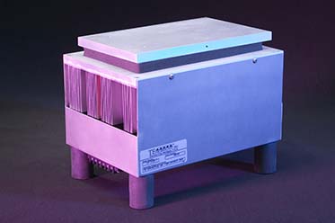

Never mind liquid cooling -- closed loop temperature control with solid state heat pumps (Peltier effect) is the way to go 🙂
Thermoelectric - Peltier Cold Plate Coolers for Direct Contact Cooling, Temperature Controllers, Air Coolers - TE Technology

Peltier's are not good, they require a huge heat sink to keep the cold side cold, plus they are MAJOR current hogg.!
Oh, I dunno, as over-engineered solutions go they have their attractive points. There are no messy fluids to leak, for starters. All fluids leak sooner or later 🙂 Also, due to closed loop control, you can maintain the cold plate temp to within +/- a degree C or better. Regulation of junction temperature is therefore much better than with a passive heat sink. Even to temperatures below ambient.
As for the downsides, I never said they were efficient or inexpensive. More problematic, IMHO, is the potential for EMI with PWM controlled current to the Peltier devices.
