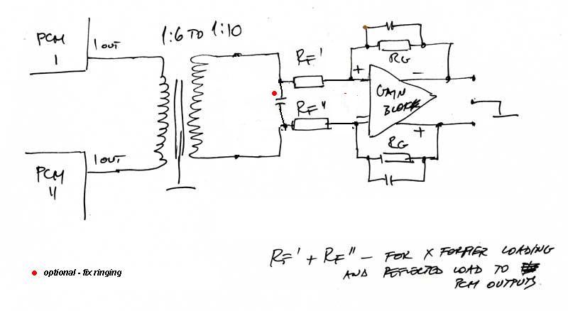

no buffer
OPA1632 anyway "like" lower impedance feedback network
look at picture and you'll know ........
xformer in case of Primare CD31 is old no name ( doesn't have any label) 1:10
secondary loading resistor is determined with freq. sweeps and CRO
then that value of xformer secondary loading is split in two , and these two resistors are used for input resistors of OPA1632
other two feedback resistors are calculated for needed amp. factor

Thanks. The load a DAC chip wants to see can be found in the datasheet correct. Is the idea to match impedance like in RF or provide lowest impedance possible. I believe I have read that 1K ohms is what most people shoot for in terms of load impedance. What is CRO?
CRO means cathode ray osciloscope
sweep with CRO check will tell what's proper loading impedance for DAC-xformer combo , for same output at low and high frequencies ..... or should I just say - shoot for frequency linearity

THanks. My trafo is 600ohm 1:1 off ebay that came out of high end mastering board. paid $20 for nickel core🙂
from my tests - mic xformer 1:10 is much better than 1:1
and I have some serious nickel toroid ones ........ still worse than 1:10 Beyerdynamic
I reckon that reason lies in greater inductance of Beyers
