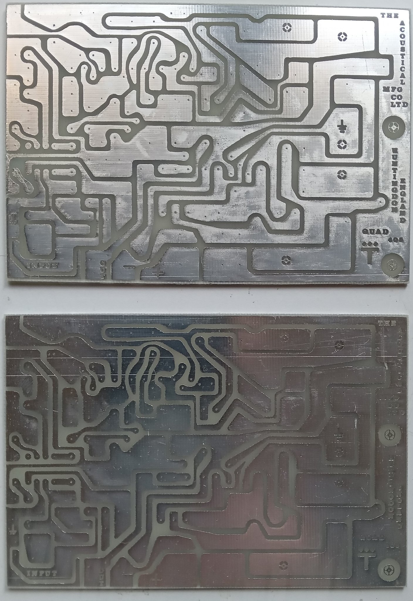

When I was young, everyone built Quad 405s, including me.
I was lucky because the DATASAAB D223 computer I was an operator of had a lot of 2N3773s in its peripherals.
They were in the MDS tape drives and, if I remember correctly, in the CDC 9762 80MB removable disk drives.
I prayed a little to the maintenance engineers and they brought me some real 2N3773 transistors. In fact, I got two National LM301AH op amps in TO-99-8 packages. I immediately ruined one of them because I put it in the wrong place. Youth, foolishness.
It's only gotten worse over the years.
I really should build one.
But I have so much other things to build.
