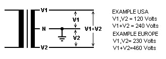

Ok, Whats the worst that could happen? I'll try it. The fact that in Europe that they use "mono-phase" and we use "split-phase" wouldn't matter? Or would using same phase circuits be better, Hmm. Hee hee, I am not trying to melt the thing.
voltage between two wires is what counts , as long both wires are isolated from chassis .....and they are
so , amp is happy whatever you are calling these two wires (two phases, two neutrals , two grounds , two giraffes, two Jaccos) , as long it see 220Vac ......
Split-phase is very handy.

In Europe, or at least Sweden, almost every household has 3 phases a neutral and a ground. Ground and Neutral is actually the same down the line. Phase phase is 400 and Phase Neutral is 230. For eventual American baught ztuffz a step down 230-120 is the way.
in my neck of wood , only oldest houses are having just monophase , usually nulled , without safety ground ......
nulled means that there is short between neutral and safety gnd prong in wall socket
standard is 3-phase + neutral , with safety GND made locally , in most cases loooooong zinc-ed ferrite rod/tube laid in ground
nominally 230Vac per phase , so 400Vac between phases
in praxis , in most places 220Vac/380Vac , as per older standard
and yeah ...... 50Hz , so mu hum is 100Hz 🙂
