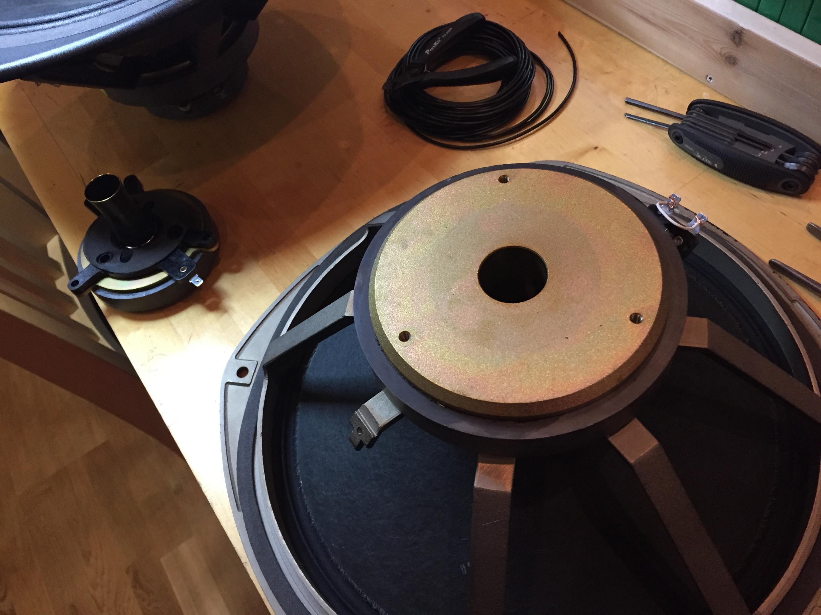

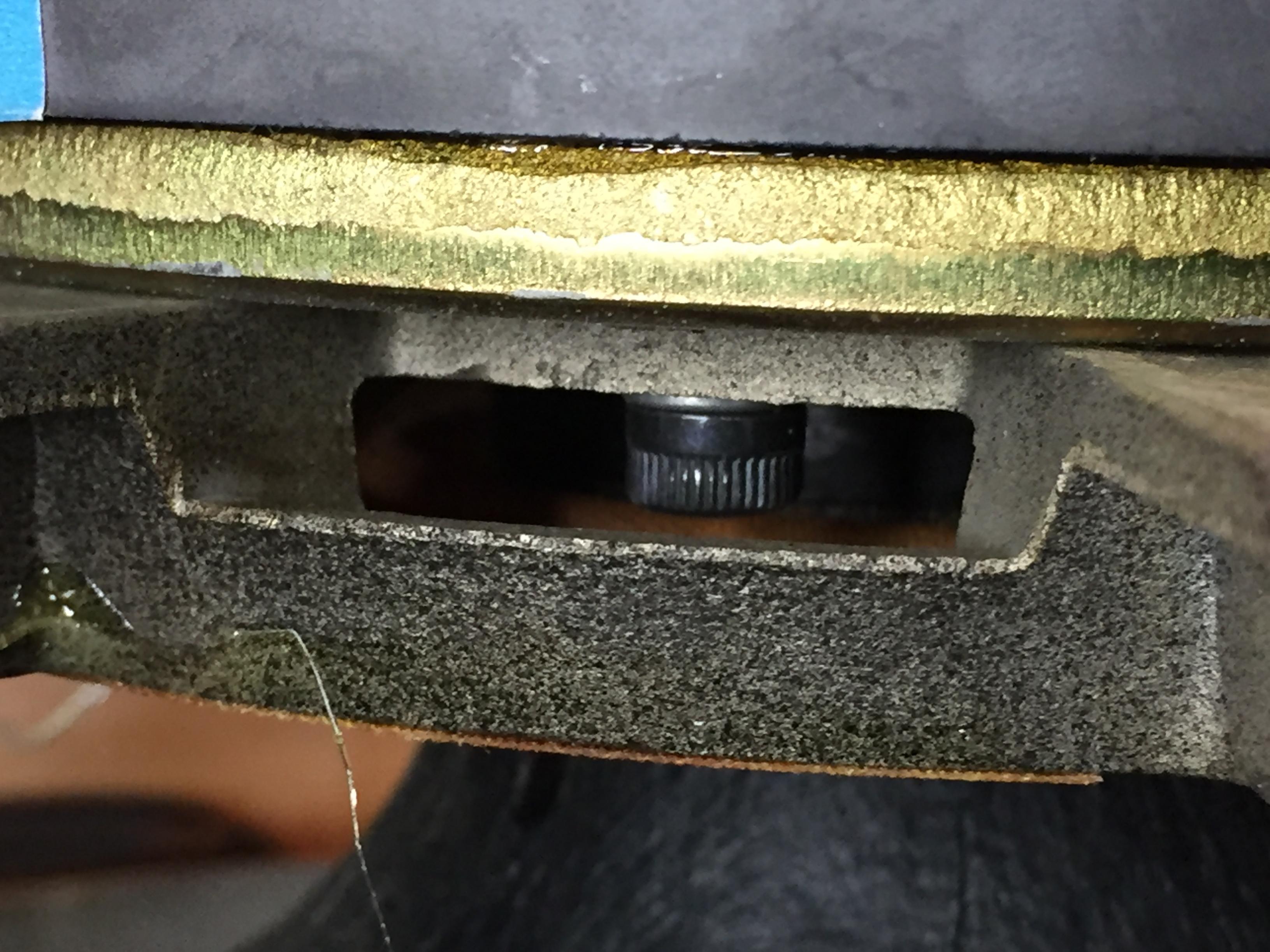

nope , ya dumbsuede , that's pole plate
so , now I'm pretty sure that pictures I put weren't usefull to you ..... simply because you didn't look them well
see : Tannoy 3833 & 3836 – cleaning da gap,painting da throat | Zen Mod Blog
look closely at pics in my blog , ya'll see how's constructed and what'ya need to do
in worst case - soak (either acetone or acetone mixed with nitro or just nitro) perimeter of spider , unglue it carefully , unscrew alen bolts , remove magnet assembly , clean , put it back , put shims to align VC , glue spider back , wait , remove shims , voila!
btw. it can be useful , sometimes , when you both read and look .........
