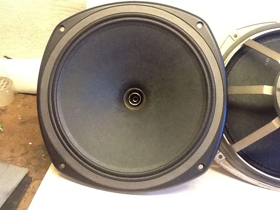

Whats the verdict on filter and boxing of a pair of 3804? Do I want to dig bass out of it or go 3-way
Go 3way.
Tannoy did with all there top of the range models like FSM, Dreadnaught, System 215 and Kingdoms.
I did with mine and the improvement in the mids once the DC does not have to do low bass duties is quite remarkable.
You can NOT use a waveguide HF crossover for a pepperpot driver. They are very different and different require eq in the high pass.

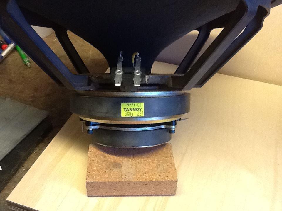

Thanks CD. I will most probably go 3-way, ie bass helper element. Xover suggestions from you? Any suggestions for a matching 15? Oldie legends are coolest but I can go for new prods also. A little into a horizontal tapped horn for LF under an open baffle with coax element atm. Got some successful constructors of THs in a swedish community site
PS. Havent got them elements in my hand yet but I dont beleave its pepperpots.

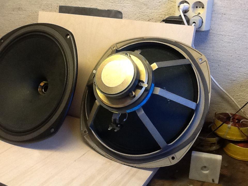

Sellers pix

Not being pepperpots makes things simpler.
The tulip (waveguide) tweeters only need the usual boost that all constant directivity horns require. The pepperpots needed an extra cut lower down to get rid of the 'horn honk'.
As for crossover frequency I'd go no lower than 175Hz so you can put the DC in a small sealed cab. I don't know about the 3804 specifically but all Tannoys I've ever simmed start to roll off at around 150-175Hz in a sealed cab.
Also you can get them to within 1/4 wavelength so as not to lose any of Tannoys point-sourciness.
I don't think you need a tapped horn for this. A good driver in a well built BR or T/L would be my preference. I also would run at least the extra woofer active and in case your Tannoys come without xovers I'd run the whole thing 3way active.
Haven't looked into 15" woofers to match DCs, mostly because I have 12s and my space is limited. Ended up with 12" Volts because I had the money and at the time I struggled to find paper-coned woofers that went low and loud enough.
Back then I was a bit more anal about cone materials and mixing them than I am now.
You live and learn...
