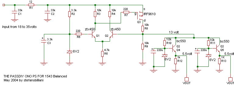

I have just defined the power supply and I am going to post the schematic based on the Passdiy ONO stage (tm).

Here we go with the power supply, heavily based on the Passdiy ONO(tm) design by Wayne and slightly modified for the occasion: I used 2 sub regulators for each TDA1543 and changed the output voltage of the discrete opamp.

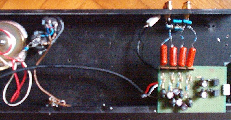

Now a fantastically bad picture of my dac (the bad picture covers some not elegant bi-used resistors) 😉
from the right there are the connector for the I2S signals , the 2 TDA1543 and then ... 2 sub regulators and the 4 D1 I/V stages.
4 philips 4.7uF MKT caps are used for the output.
The red/white shielded cable carries the +/- 30volts for the I/V and comes from outside the box since I have yet to find a small transformer for that purpose.
The inside toroid feeds the 1543s via the power supply schematic posted above .
The PS circuit is covered by the chassis. 😎
