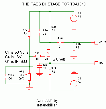

Thanks Andrea!!!!
So... it is ... here.
What can I say?
a: I didn't ask Nelson Pass for copyright problem but since the design is modified , they should not exist 😉 BTW Thanks Nelson!
b: leave out vref resistor
c: once set up is done , nothing changes if you change the VCC at the 1543;
d: like c , nothing changes if you decide to parallel the 1543; in this regard to obtain ,IMHO ,great results with 2 1543 in parallel is simple: great dynamics.
e: it sounds like a single TDA1543 would enjoy a bigger source resistor , but this is another matter.
f: IRF630 is used by me for comfort , and I believe IRF610 will pay better in performance.
g: cascode is not a gain stage.
I do not know if something is missing , but guys ... take a look at the schematic , isn't it simple?
I'd say... YES!!!
..here we are...
And now... some questions!
Did you compare it with passive i/v or other output stages?
Can it work with TDA1545 (which has different output current BTW)?
Did you use the D1 supply (don't know if its schematic is available but think so)?
Cheers
Andrea
Cheers
Andrea
- since the simplicity of the circuit is up to you decide what is your favourite , but Yes it is compared with the single resistor at the output ...
- YES but you may want to adjust the drain resistor for gain
- I use a power supply like BOSOZ but scaled down for +/- 30 Volt

Few questions- You have mentioned to leave out vref resistor. I don't see that one in schematic. Also what power supply did You use for powering TDA1543 chip (voltage also please).
regards
daniel
edit: One more thing- I think that TDA1543 like to have 0V at his output and not 2V?! Am I wrong?

But where's the cascode here 😕
I don't see a cascode in your circuit, nor in Pass Labs original D1 one (the second transistor is a buffer, not a cascode)

By "leave out the vref resistor" I meant just to let the pin 7 of 1543 disconnected.
You may use what power supply you want from 5 to 9 volts , the source pin will be stable at 2 volts ,regardless of the variations of voltage at pin 5 of tda1543.
BTW I am using 8 volts and 2 tda1543 in parallel / phase .In the sense that the dac is balanced at the moment and counts 4 dacs in total.I will post a block diagram of it soon if it is of interest.
The power supply is a discrete op amp -take a look at the Pearl ONO- followed by a current source or jfet source follower.I have an unregulated supply about 30 volts.
The discrete op amp is at 12volts . The current source eat up at least 4 volts . But i am still in making decisions about it.
For the TDA1541A you trim the source for 0 volts , and use the ORIGINAL PASSLABS circuit.
For the TDA1543 not 0volts but 2,0 or higher voltage .
I also will try soon the circuit with the 1545A.

The main difference (apart from the circuit refinement) is that the TDA1543 (and1545) use a single supply, while the TDA1541 uses a dual supply for the analog section.
Since the output section of these DACs is made of current sources/sinks it is not possible for the single supply chips to have 0V on their output (at least while working 😉 ).
Hope this clears things a little.

Bricolo said:But where's the cascode here 😕
Bricolo,
the DAC is looking for a virtual ground - the source of the mosfet .Than the signal is amplified in voltage by the mosfet that is in common gate mode .
If not cascode , than what?
Hello Stefano,
I hadn't noticed that...this way you switch off the internal current sources of the 1543 and feed its outputs (that now act only as current sinks if I understand right) through the Mosfet, which seems to be configured as a common gate.... the 3k3 sinks further 10mA to keep the fet well polarized and the current variations due to the DAC are reflected on the 680R resistor... very clever!
Did I get it right?

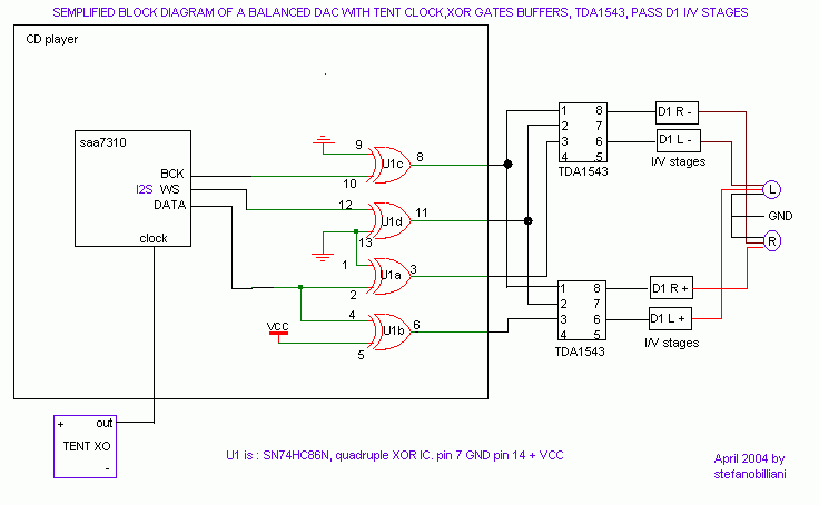

NO.Andypairo said:For the balanced are you still using the circuit posted some time ago?
I think I'll post tonight the arrangement, based on XOR gates that acts as buffers and inverters.

Balnced Arrangement
OK this is the actual balanced DAC arrangement .Of course it is simplified a lot in the sense that some care has to be taken for the shielded connections , the decoupling caps, ferrite beads and low noise power supplies.
Some thing can be of help BTW:
The buffers need its own PS or at list they can be attached at the DAC VCC but for the SN74HC86N the limit is 7V AND NOT 9V like the 1543.
The 1543 needs its own PS.
The buffers can be mounted close to the dacs , maybe it would be better maybe not.
The Tent clock needs its own PS of course.
The Passlabs D1 stages needs its own PS : +/- 30volts.
The I2S and cloock lines outside the player MUST be shielded .

Thanks mr. Bilianni!
It is very similar like in the D1 d/a converter (in fact the connection is the same). One more thing- because I have allways wondered about that- You connect everything together like in those schemtaics (that is not a problem to me) and how do You set this thing to work properly? I know that I should have 2 volts on input of the i/v and I know that it should be trimmed with VR1 but from which side do You start- from which value of the VR1. Please understand, I don't want to destroy my TDA chip and really I don't know very much about them so I must ask.
I don't know if my dac would live long enough for his i/v to get trimmed.
I would appreciate if nobody would laugh at me and if somebody would help me to understand.

Two idea's for improvements:
reclock all the data with FF's: use '74 so you don't need inverters and reclock with the tentclock. You will loose jitter created by the 7310 (don't know the timingrelation between 7310 I2S out and it's clock input but it should be possible). Maybe you need to invert the clock to the 7310.
Second, obvious (coming from me 😉 ): split left and right into two
I2S streams and use one dac for left and one for right.
