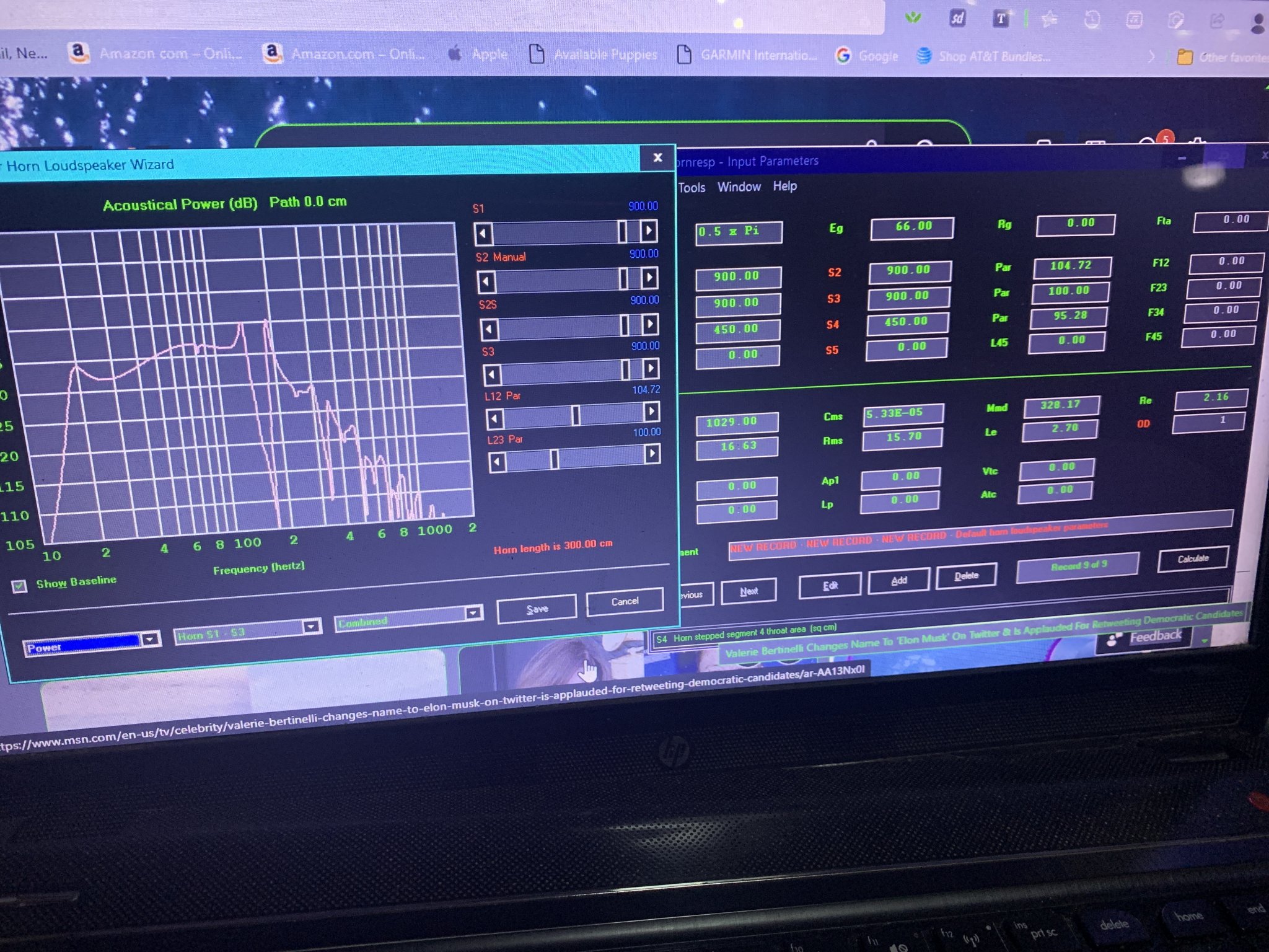

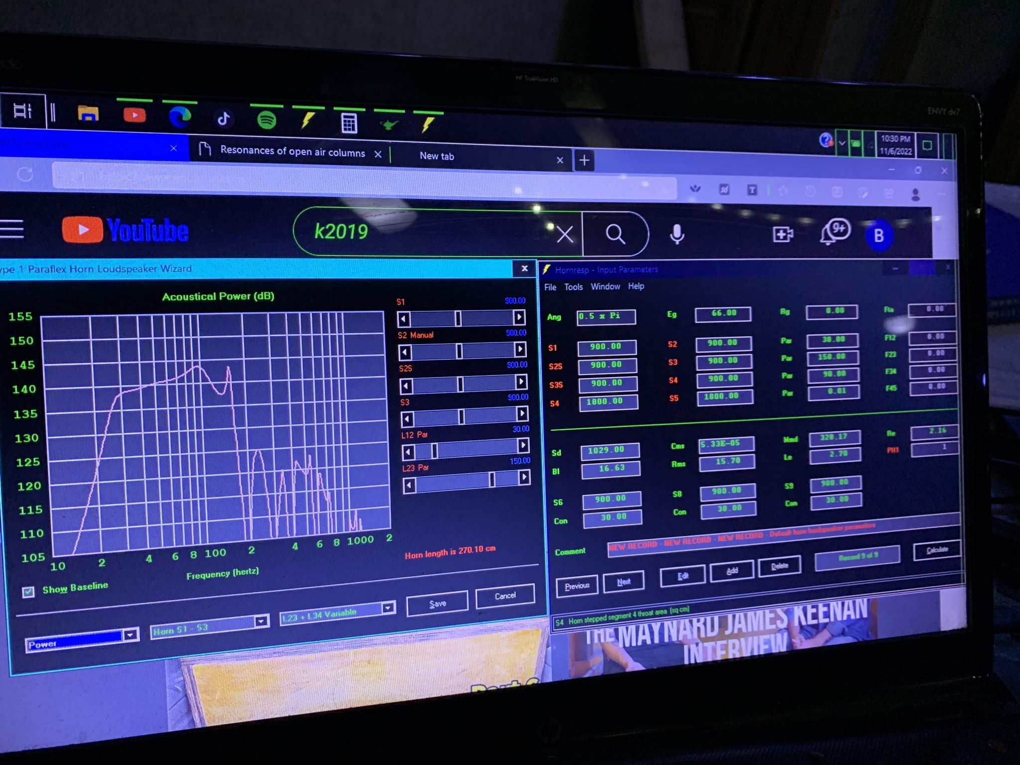

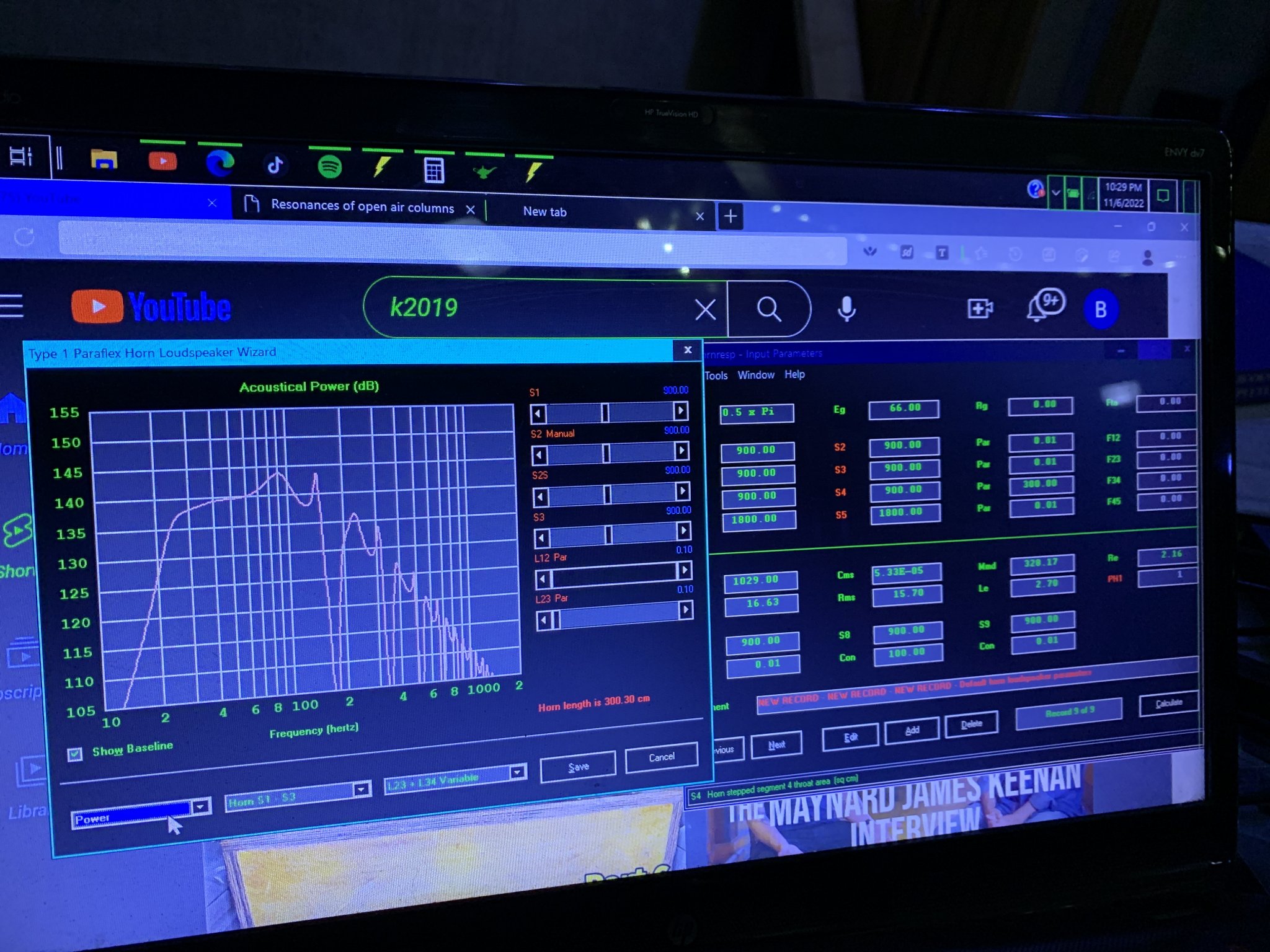

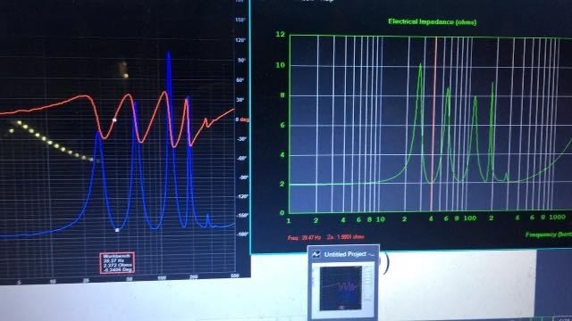

The ‘overlap’ of misaligned resonators?
In parallel or as an ODTL?? what might this cause ?
It shows up in reality (white pic is misaligned and sizes wrong and doesn’t match). (it doesn’t have simple, perfect rectangles lined up at three to one. And it has this hiccup on the 3rd impedance peak and the. The funky freq response in that area is (weird) for lack of a better description ??

They way I see (hear) it is that simulated "perfectly tuned" parallell tuned QW resonators will de-tune and become misaligned based on signal character, power-levels and changing exit environments (radiation impedance). And this will all change constantly during the wildly varying signal character when reproducing music. Some careful damping of the sections and some low pass filtering will lessen the problem, but never eliminate it completely. If you could measure the response while actually reproducing complex dynamic signal at some real life power levels then you would most certainly see this nonlinear de-tuning in action. I know I can easily hear it in the few different high order parallell QW designs we have built.
Series tuned high order QW designs does not have this problem.
We share the same experiences and have built these things to ‘know’.. I wish more people would so these questions weren’t so foreign or sound so ambiguous. Much respect for everything you’ve shown over the years. It was a beacon towards some really exciting stuff.
I end up restricting one side a bit (mass load) and dampen it all lightly to fix the screwed up parallel (paraflex) PA. Versions when using indoors that are quite a ways off or have been sized disproportionally in the past and nobody looks to fix these issues you found , they just damp them away in PA. and ignore Other potential methods (in car audio boundaries for example)
