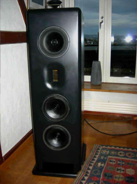

Like this?

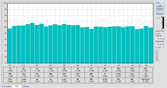

This is a prototype with back loaded horn for the three 8" drivers, wave-guide for the AMT (smaller than the current) midrange/tweeter and 360 degree dispersion for the AMT super tweeter.
Measured in the room in the picture.
