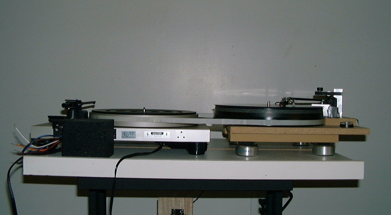

Hi All, first time posted in this forum. I am building a DIY TT and have a Rek-O-Kut K33 plate with the motor and bearing on the plate. I got the replacement gromets for the motor, but is there anything else I should do to the motor as I move forward?
OK, so this isn't the most sophisticated means for driving a platter, but it works for me. 😛 ... Harman Kardon T35C servo-controlled belt drive TT driving the platter/bearing combo from an Immedia RPM-1. I used the HK's pitch control and a stroboscope to dial in the speed. The tape used to drive the platter is a composite of surgical and scotch tape, with the cloth side contacting the platters.
Just need to make it less cosmetically challenged. 😱
Rube Goldberg would be proud.
