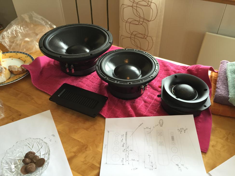

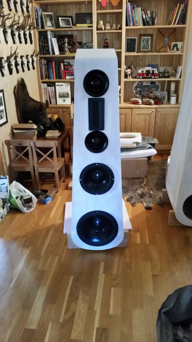

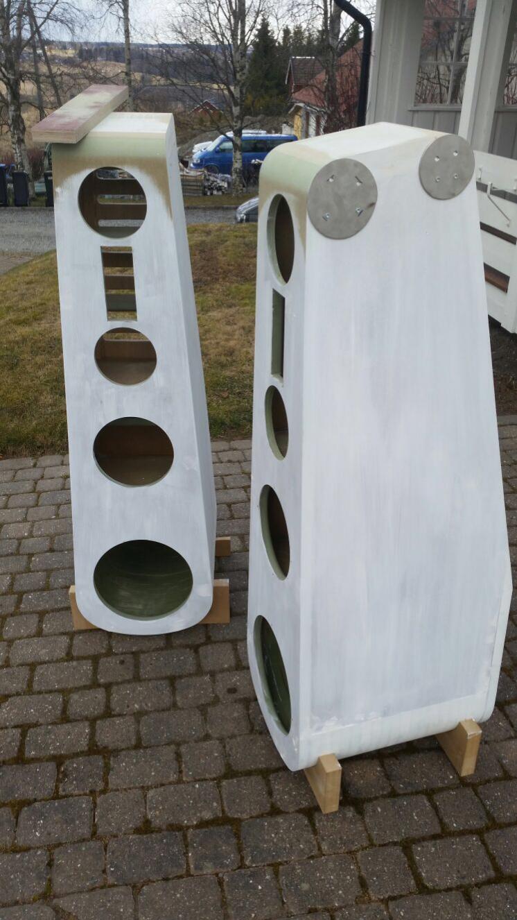

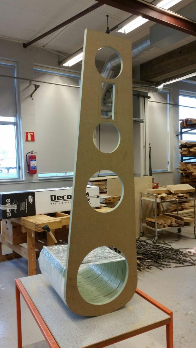

Current project consists of the following drivers:
ATC 12" (SB75-314SC) in BR, Hoges tuning to 35 hz
ATC 8" (SB75-234SC), closed Q approx 0,71
ATC 3" (SM75-150) - Two e.a. in MTM
Dayton AMT Pro4 (open and damped backwards)
The "singers" above will be conducted by Mini-DSP electronic crossover.
I ask for your advices for x-over and slope settings.

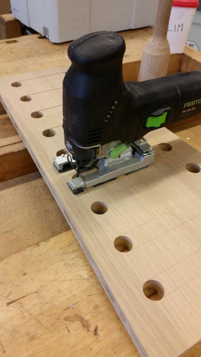

This speaker will be finished with oak veneer sheets.

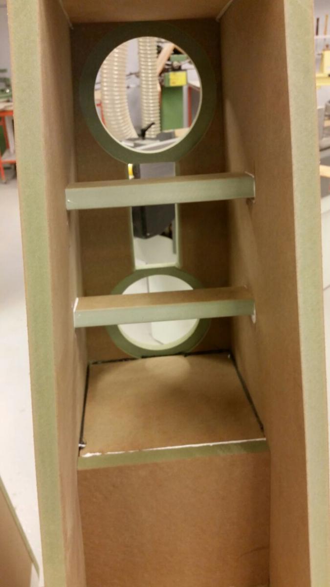

This looks nice. I hadn't seen the ATC drivers before.
I like the overall cabinet shape, and the work you put into that grill, visible in photos 4 & 5. I assume that grill is removable, to allow mounting the mid range drivers.
I have more questions than advice - but how you respond might help generate better advice.
When you say "Dayton AMT Pro4 (open and damped backwards)" do you mean with the felt pads in place? I'm curious why you chose this driver, and why you put so much effort into getting a partial dipole. I'm particularly curious because I recently ordered a pair 🙂
Will the 8" and 12" be covering the same range (playing together up to ~400Hz) or not (e.g. 12" to 100Hz, 8" 100-400Hz)?
Given that your low frequency drivers are low efficiency ~89dB, and the others drivers are higher efficiency (93 and 94dB), why did you opt for two mids? It seems like overkill - one seems like enough, in terms of output capability.
You may find it sounds best with one of the mids operating for its lowest octave, or turned off entirely.
Is it too late to add an extra layer to the front baffle, so you can re-cut your mounting holes and offset the drivers? It seems odd to position them right in the middle, where diffraction effects will be the most pronounced.
Pictures are good: here is a project with a similar spacing between the midrange drivers.
http://www.diyaudio.com/forums/mult...pro5i-ribbon-build-thread-13.html#post2687123
The builder was not satisfied with a few aspects, including the nulls caused by the large spacing. "At just 15 degrees off axis, there’s a 20dB dip at 1500Hz which is completely unacceptable. Things only get worse from there, with a plethora of peaks and nulls as you move farther off axis."
If you measured a similar null, you could try running the upper ATC 3" over a limited range, maybe 400-800Hz, and see if you preferred that. Or remove the upper 3" and use it on a different project.

This is an interesting project with some very expensive parts. The cabinetry I must say is very well done.
I have to agree with others on your MTM arrangement. The Proac you reference, as you can see has much shorter distance between the midrange drivers. That is not to say that your arrangement can't work, but I can say it will work best in a large room with the listener a fair distance from the speaker. Due to the large distance between the mids the vertical window will be very short. Besides that I am very confident that a single SM75 is more than capable of meeting the output requirement here.

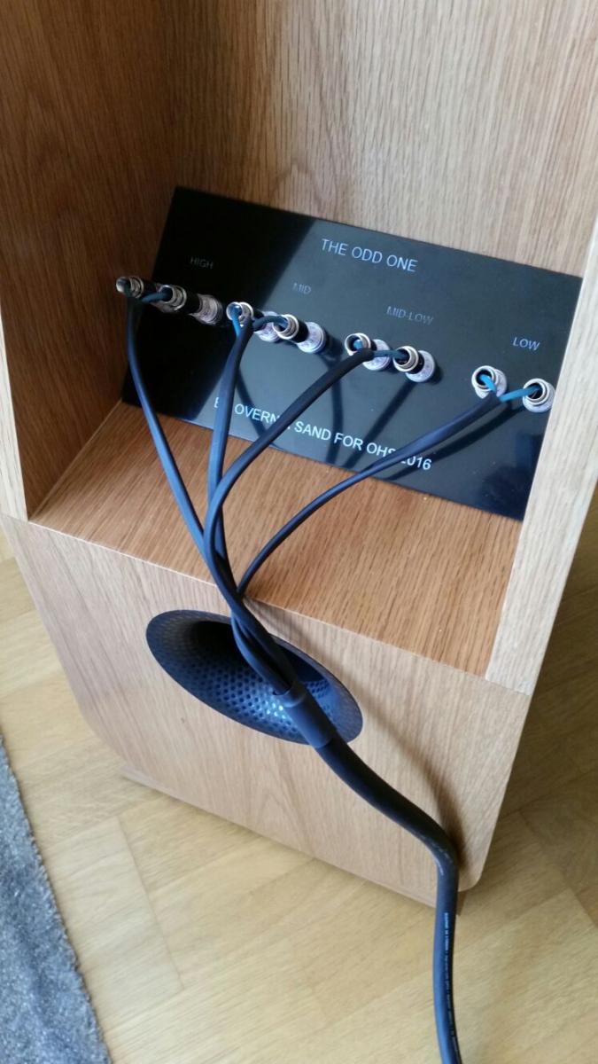

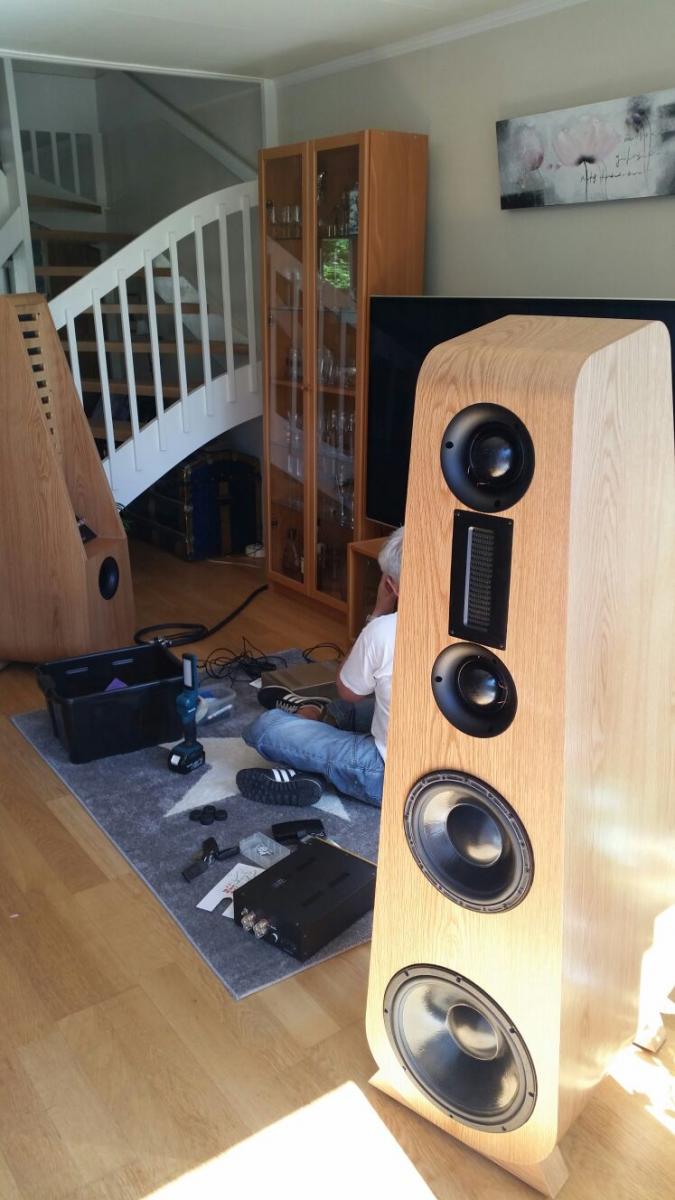

Speakers are finished.
LM3886 for tweeter, Lindsley Hood 15W cl.A for mids, Class D Audio for woofers.
Chain:HTPC w/ Asus Essence STX soundcard - JRiver 21 - Dirac Live software-MiniDSP 4 x 10 HD. To our nightmare there is a challenge make the chain play as the Dirac (?) seems to refuse volunteer in this context.
