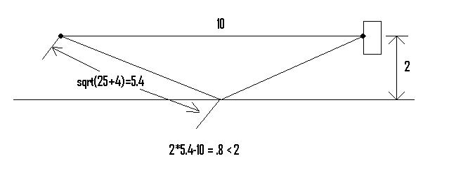

First, when I talk about time delays I mean time DIFFERENCES between direct and reflected, NOT total travel time. A difference of 2 ms or 2 feet IS an extreme issue if you plot out the actual lines. I think that you are missing this critcal point. Putting speakers 2 ft. from something will not necessarily delay the reflection/diffraction by 2 ms. It could be much less.
As far as I am concerned omni-directional speakers are the completely wrong thing to do for all the reasons that I have stated. Please don't take away from this discussion that I am saying anything to the contrary.
As to "diversified opinions", Dr. Toole and I don't really have many major ones, but I do have major differences with most of the others that you mention.

A speaker with well controlled directional capabilities and a smoothly falling off-axis response gives the operator the most flexiblity in terms of their placement and space requirements, room modification, and listening positions. And it's far more accessible to most people, especially DIYers, than the extremely expensive devices produced by B&O and MBL.
A well thought out post. My thoughts (almost) exactly.
Six feet away from any reflecting surface - for two speakers spaced apart - is NOT a small room unless one sits close to a wall.
I cannot do anything about my hearing so I MUST sit away from the walls, preferably near the middle of the room. Now just try and place two speakers in the remaining space such that they are at least six feet from any reflecting surface and each other - the room gets pretty big - probably 20 ft by 20 ft minimum (ouch!). With high directivity the situation is dramatically improved because I can now be as close as 1-2 feet from the side walls and back wall and not have an early refection from these walls IF the directivity pattern doesn't see that wall.
High directivity gives one a far far better channce of achieving good sound in a small room than any other directivity can achieve.
The loudspeaker design is really pretty obvious if you follow through on the thought processes as done above.
