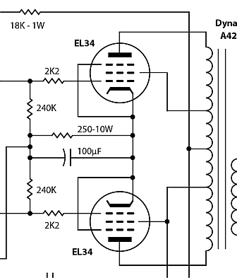

What is your opinion of these two designs?
The basic concept isn't too different between the two designs. The gain distribution is. I have never seen a 12AX7 adequately drive a large output tube with authority where distortion isn't a desired thing (guitar amp), so I would vote for the Dynamull.
Be aware that there is a dot missing in your version of the schematic. The .047 cap and the 1K resistor at the EF86 cathode should be connected. It isn't stated on your schematic but you must use a 5U4 rectifier with a 400-0-400 volt power transformer. Even still you are going to have nearly 500 volts of B+. I get 520 volts with a 400-0-400 and a 5AR4. That much B+ will require a fairly conservative bias point to avoid melting EL34's. Both designs use cathode bias which helps to waste some voltage and makes for a simpler design. I tend to prefer seperate cathode resistors for each output tube, so that perfect tube matching isn't needed.

If you like the Dynamull circuit, then build it. I would leave out the 12pF cap for the initial build since the value of it and the 33 pF in the feedback loop are OPT specific. I would consider a power transformer smaller that 400-0-400 since you really don't need (or want that much voltage).
What is the best way to accomplish that? Just break the connection between the two cathodes and use the same value resistors and caps on each side? (in this case 250R//150uF). Or since they both conduct, use half the resistance? I'm still a lot confused about the AC and DC currents in that area.

For the value of those resistors, just remember Ohm's Law. You want to drop the same voltage for the bias, but each resistor will only have half the current...

What is the best way to accomplish that? Just break the connection between the two cathodes and use the same value resistors and caps on each side? (in this case 250R//150uF). Or since they both conduct, use half the resistance? I'm still a lot confused about the AC and DC currents in that area......... Have you seen this design?.....It claims to be a "Marantz 8B"
www.plitron.com/pdf/702Kobayashi1817.pdf
You want half of the current through each tube, so you would use twice the resistance. Look at the schematic of the Plitron / Kobayashi design. it uses a 667 ohm resistor for each tube, a 680 ohm would be a good choice. That amp uses a 470 uf cap for each tube, I tend to use a larger cap because the ESR is lower. While you are looking, note which tube is used for the first stage, yes......a 12AU7.
