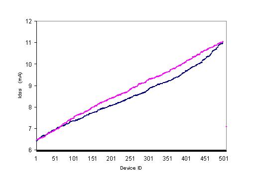

As mentioned earlier, we have recently measured 500 pcs each of Toshiba (not LS) 2SK170BLs and 2SJ74BLs :
http://www.diyaudio.com/forums/showthread.php?postid=1722442#post1722442
The measurement method has already been described there (single point Idss, 9V Vds, room temperature, steady state). Measurement time is about 1.5 minutes per FET, inclusing calibration time every 10 FETs.
Here are some statistical results.
As you can see from the graph, it is more a linear rather than Gaussian distribution.
This unfortunately means that the quality of match only improves proportionally to pool size (or luck).
From the 500, we obtained :
2SK170BLs
83 pairs matched to < 30uA (including measurement uncertainty)
29 triples matched to < 30uA
15 quads matched to < 30uA
2SJ74BLs
93 pairs matched to < 30uA
31 triples matched to < 30uA
17 quads matched to < 30uA
And 12 complementary quads (2 Ns, 2Ps, same type match < 30uA, N-P match < 60uA)
Less than 10 FETs of the same type cannot find a match to better than 60uA Idss (< 1% match).
I guess a pool size of 1000 might yield slightly better results.
Patrick

Thank you Patrick.
I now know, if my math is correct, that 100 would give 25 pairs, but the 30 I recently bought will probably only give me 1 pair. Next time I'll either buy more for matching or even more likely spend the money on prematched devices.
Jim
100 will probably give you 25 - 30 pairs if you are not trying to match to +/-5uA. I said 30uA because I allow for +/-10uA measurement uncertainty. On the calibrated ammeter with 1uA resolution, they were actually matched to +/-5uA. Below 5uA, it is just too sensitive to temperature fluctuation that the absolute steady state value is more a guess.
Maybe you have better luck than that. It is afterall a random event.
You may consider PM me for any needs, like another GB member already did.
Patrick
