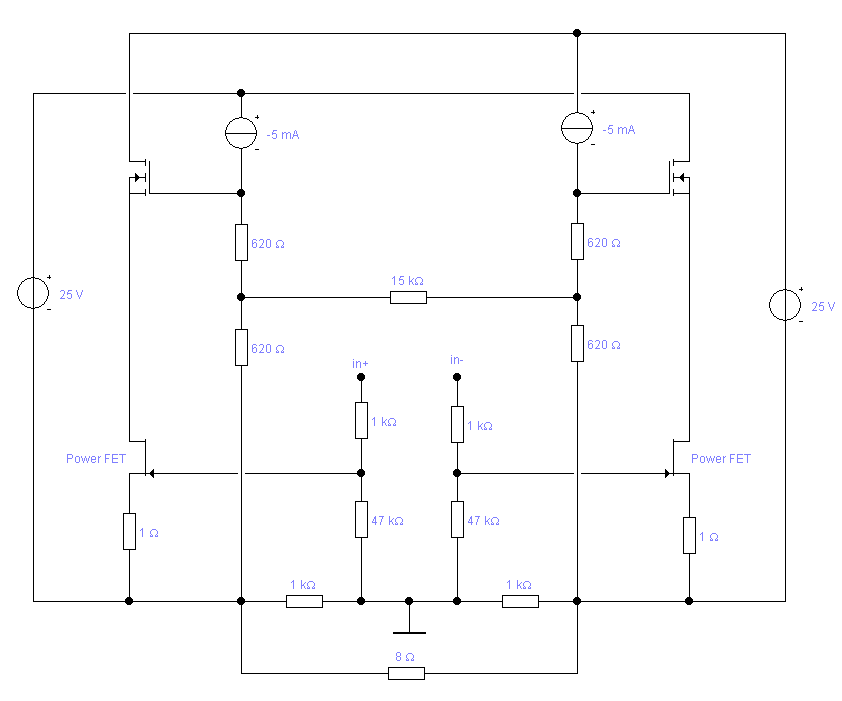

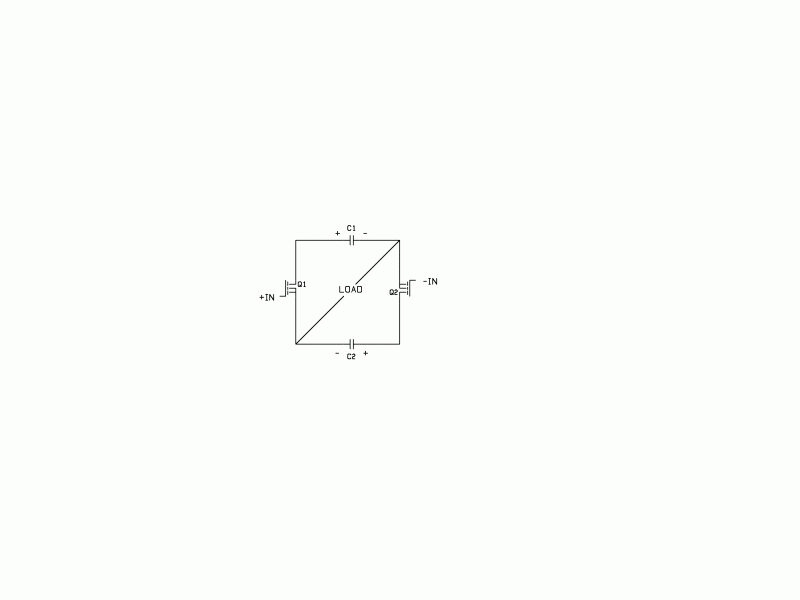

One of the many clever circuits that came out of the tube era was the Circlotron. Since the Circlotron topology has put in only sporadic appearances since transistors gained ascendancy, it is not as familiar as other topologies. Essentially, it is a push-pull circuit comprised of two single-ended amplifiers operated nose to tail. That doesn’t sound too unusual until you notice the power supplies. Plural. There are two of them. In a Circlotron, you have one amplifier circuit, followed in series by a power supply, then by the other amplifier circuit, then another power supply, which in turn leads back to the first amplifier circuit, all in a circle. In the old days the conceptual schematics were frequently drawn in a literal circle to emphasize the series nature of things. Given that modern electronics CAD programs aren't easily convinced to draw circular circuits, nowadays a Circlotron diagram usually ends up looking something like this:

On the plus side, the Circlotron offers a like-device topology. You can use it with all N-ch output devices. It also has the curious property of using the N-ch devices in opposition. As one conducts more, the other conducts less. This lowers distortion because the transfer curves of the devices bow in opposite directions and essentially cancel out.
On the negative side of the equation, the Circlotron requires a little more complicated power supply than most amplifiers. Those two power supplies mentioned earlier aren't the usual plus and minus with ground in the middle that you're used to seeing, they are two identical power supplies, completely separate from one another. Don't panic though, many power transformers these days have two separate secondaries that can be used independently. That sort of transformer will work admirably for this circuit.

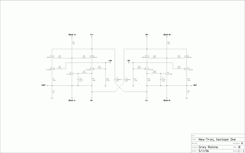

Each half of the amplifier circuit is much like Nelson's Zen circuit. That's to be expected, given that one cascode looks pretty much like another. The difference between my circuit and Nelson's is the way I set the voltage at the cascode's Gate. Simply put, I use a small NPN transistor to watch the Source resistor for the JFET. The NPN sets the voltage at the cascode's Gate such that it sees its Vbe across the JFET's Source resistor. You set the bias by choosing the value of the Source resistor. It's that simple.
After that, it's a question of putting two of these circuits together in a Circlotron arrangement.
Yes, you can take half of the circuit and run it single-ended, if you want. Be my guest.
As far as I know, no one has ever produced a commercial version of a cascoded Circlotron. It's a new circuit. With that in mind, I decided to call this circuit the New-tron. Hopefully, that name will have neither positive nor negative connotations.
For the moment, I am presenting this circuit as a “hot follower.” Built as per the schematic, each cascode stack runs at about Iq=1A. That’s a little more than you might expect to see if you divide the Vbe of the NPN by the value of the Source resistor, but the NPN’s base current drives the actual value up a bit.
At the moment I am using 25V for V1 and V2. Yes, you can run it at higher or lower voltages. To a first approximation, your Vout measured peak to peak will equal one rail. Vrms will be that divided by 2.828. Set your current by adjusting R1, R8, R13, and R19 or add more cascode stacks slaved off of the inside ones. Or both.
Bias A and Bias B are set to 15V. Nothing fancy there, just one of those little Tamura transformers with rectification and a TO-92 case 7815. Would the circuit benefit from more elaborate regulation? Probably. However, my intent was to get the circuit going and that was the first part that came to hand.
Yes, the circuit will tolerate the usual parts changes. I used the IRF644 because I still have some I’m trying to use up. Feel free to use IRFP044s or IRFP240s or whatever. Keep in mind that changing the ZTX450s to another part will alter the bias by slight amounts. In fact, I spent an entire week just playing with different ways to fine tune the bias just within this one circuit. I had to slap myself… “Grey, stop playing. The intent here is to post a circuit that doesn’t require fiddling.” Oh. Right. So I took out all the pots and went back to the circuit as you see it here.
How do you drive it? Given that it doesn’t have a front end, you’ll need a balanced signal that will swing all the voltage that you intend to see at the output. I will be posting an IRF610 differential circuit in the next day or two that will do for starters. Those of you who have a spare Aleph preamp lying about can use that as long as your speakers are fairly efficient. I have other front ends that I will post later. I also have other versions of this output stage and other output stages that are different.
It’s all a question of time, folks. I had hoped to get this thread going back in January. It didn’t happen. Now it’s May and I thought that it would be best to do it on the installment plan rather than try to get everything into one monolithic post.
As always, questions and comments are welcome, but my time is increasingly fragmented and I may not get back to this thread as often as I’d like.
Grey

I suppose it goes without saying that this circuit will take a lot of heatsinking if you intend to generate more than a few watts. Power supplies will need to be robust, also.
I don't have it drawn in the schematic, but you are also invited to add Nelson's "cascode modulation" to the circuit. You'll need separate modulation for each side.

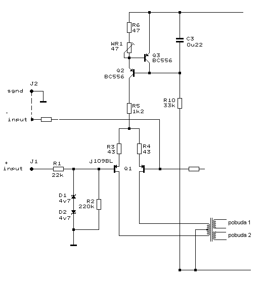

Very interesting Grey.
One quick question: Isn't there a form of cascode modulation already present in your circuit? I've only had a chance to do a quick once over of your circuit, but when a signal is presented to Q4&5, they will modulate changing the voltage of the source resistors, and thus the voltages at the base of the ZTX450's. Won't this then somewhat modulate the bipolars, causing the current across the bias resistors to modulate, thereby modulating the voltage at the gates of the cascode MOSFET's?
As I said, this commentary is based only on a quick once over look, so I may be blowing smoke. Please correct me if I am wrong.
Cheers, Terry

metalman,
At first glance, you'd think so, but as always the devil is in the details. One, the bipolar would flip the polarity of the modulation signal, thus increasing distortion, not decreasing it. Two, it's a moot point because the RC filter at the base of the NPN takes out nearly all the signal, leaving only variations less than 1Hz.
Incidentally, the values of the RC filter can be fiddled around according to whatever you have in your junkbox. All that matters is that you get the cutoff frequency really, really low. I chose to use a relatively high value resistor expressly so that the base current would bump up the bias a bit. If you use a larger capacitor and smaller resistor, you'll get closer to the .65V/Rsource=Iq formula that you would expect.

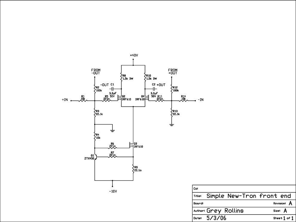

P.S.: Oh hell, just when I thought it was safe to go back in the water...I just thought of another way to bias the circuit. Blast and bother!
I stole a few minutes this afternoon and scratched out the schematic for the simple front end I've used off and on during my fiddlings. This is not a be-all, end-all front end, just a decent one. In its favor: It's simple and relatively cheap.
In a pinch, it might make a fair-to-middlin' medium gain line stage.
The rail voltages are specified as +40V and -10V. A couple of thoughts:
--Use matched devices for Q2 and Q4.
--It would actually be better if the positive rail were closer to 45V, 40V was just a convenient voltage for me at the time. I didn't need that last few volts of swing on the output; you'll get more symmetrical clipping if you use a slightly higher rail.
--The negative rail is specified as -10V. Feel free to make it -40 V or -45V if it makes you happy, but be sure to heatsink Q3 accordingly. The device can take it, as long as you make arrangements for the heat.
--As always, the rails are important, but since both the positive and negative rails sum to DC, it will take some of the worry out of the power supply end of things. That doesn't mean you can be a slacker, just that you don't have to lie awake at night worrying about five decimal places of accuracy for the rail.
--It draws roughly 30mA of current, total. Call it 15mA per side. Q2 and Q4 will dissipate about .6-.7W each. I'm comfortable running TO-220 devices up to about half a watt without a heatsink. This is slightly over that, and although I'm sure things would have been just fine without, I went ahead and put heatsinks on them. Nelson would, no doubt, run them naked--he ain't happy until he smells burning flesh. I prefer my steak medium-rare rather than well-done.
--Q3--assuming a 10V rail--is okay without a heatsink. If you use a higher rail, use a heatsink.
Just hook this circuit directly to the output stage posted earlier. Note that the output stage is a follower, so it does not invert phase. With that in mind, the negative feedback comes back to the same side of the front end. It does not cross over to the other side like it did in the Aleph-X. If you do swap it over, you'll have positive feedback. This is only recommended if you like listening to the old Chicago track "Free Form Guitar" or live Jimi Hendrix recordings (e.g. "The Star Spangled Banner"). You will not actually need the recording--the circuit will provide all the sound effects you can stand.
Don't say you weren't warned.
Grey
P.S.: I've had complaints about the resolution of the schematics. I feel your pain, as the expression goes. DIY doesn't allow anything over 1000 pixels and I'm at wit's end trying to get a readable schematic in under their limits.
My schematic program exports BMP files. I am resizing and converting them to GIF in another program. There may be better ways of doing this, but &%$)!@# I've got better things to do with my time than sit around trying to convert files all day long. As it is, I was frantically pounding the keyboard this afternoon, running late getting to work, all because of all this file size/format/conversion nonsense.
Grumble.
