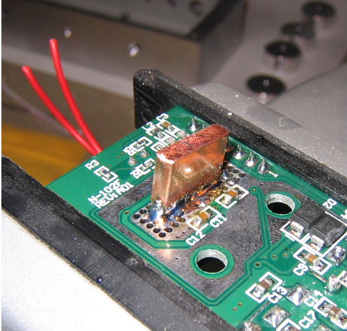

The holes definately dont provide enough airflow to cool the chip. Heatsinking is a must if the amp is operated much past a watt or two. My solution has been to flow solder on the top of the board and onto the copper tap that protrudes from the sides of the chip. One side is blocked by the power/input wires but the other side is open. While the puddle of solder is still hot, I attach a piece of copper to it which is about 1/2 x 1/2 x 1/8" . This piece of copper bar pulls the heat from the chip nicely and dissipates it well. I recently started attaching the copper heatsink to the bottom of the board by filling the holes under the chip with solder. I keep a 20lb piece of aluminum chilled in the freezer to pull some of the heat from the board once the soldering is done, since it generates quite alot of heat. All my amps have been built this way since the slug was eliminated.

Well heres a shot of the copper heatsink. First I heat the copper and tin the attaching side. Then I flood the bottom of the board, making sure solder reaches the chip and has heated it sufficiently to attach. Then I place the copper on the board, re-heat the puddle so it attachs and then add additional solder to the joint.
This has to be done quickly, so the copper and the puddle dont cool down to the point of requiring complete re-heating. Once done, I contact the copper to my frozen aluminum chuck, off and on, until I feel the plastic case cool to what would be warm operating temp.

Thanks for the pic - and explanation. I have just been taking a closer look at my SI's. I take it that there are no circuit board traces running beneath the 2020 chip otherwise these would be shorted out by soldering through the holes.
As the SI boards are not the best quality (so I have read!) should it not be possible and easy to cut out the 'holed" part of the board thereby exposing the base of the 2020 chip onto which a heat-sink could be attached? Anyone attempted this?
CambshireGordon
Ive done that too. Its more work and adds another risk of board damage. Pulling the heat out of the chip slug with solder is very efficient and easy. You avoid damaging the integrately of the cheap board as well, by just flooding the holes directly above the chip. If you want a traditional heatsink, just attach a piece of aluminum, to which you can affix a small finned sink. On my amps, the copper sink is actually on the top of the board (boards are flipped so chip/components are facing down) and within a few mm of the chassis. So heat is radiated to the chassis and convection through the vent holes draw out the heat. You can feel the copper sink getting much hotter than the chip case as it absorbs the the heat. If I were to go for the maximum sinking possible, I would attach larger piece of aluminum, in which a couple of threaded holes have been added, and then a large sink could be screwed to the plate or it could be attached to the chassis.
