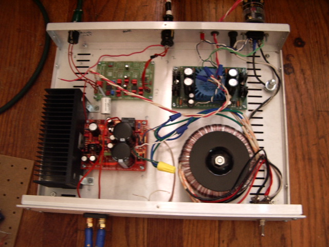

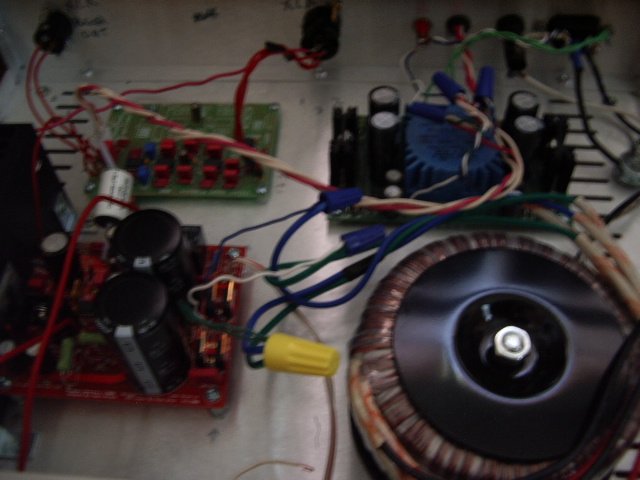

Yesterday was terribly hot and humid here, so I spent the day/evening in my cool and humid basement, assembling this conglomeration of gear. The amp is from the latest Ultimate BOM group buy. I built it several months ago but just hooked it up now. All is well: one, yes one mV DC offset, absolutely quiet. In fact, even with all this stuff inside one enclosure, it's more quiet than when everything was spread out. Sound is a little closed-in yet because it takes a while for that BG to loosen up!
This is a MyRef (of course) and active xover with its power supply. The active portion separates bass from mids/highs at 350Hz, LR 24dB/octave. It is a PCB from ESP.
Sorry that I'm not a good photographer (Bob is much better), but I build a pretty nice amp.
Wiring needs a little cleaning up, but I just wanted to get the thing all put together and try it before spending too much time doing that. Besides, tidy wiring is overrated. The important thing is what the wire is hooked up to!

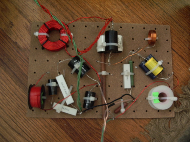

Also, just for the heck of it, here is a pic of the passive portion of the xover, which separates tweeter from mids at about 2.9k. This was designed by Madisound, built by me. The long, skinny tube in the center is a Duelund resistor, in series with tweeter. Tweeter caps are Sonicap bypassed by Mundorf SIO. The rest of it is pretty standard.
