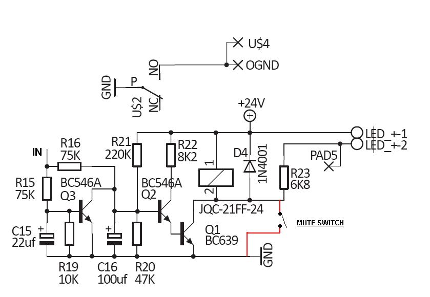

MUTE - Is there anything wrong with taking signal to ground via relay?

Sorry, only just read this post.
Why not forcing the protection relay to kick in? I have added a switch to the MyRef_C protection circuit schematic. Anybody see anything wrong with that?
QUOTE]
Am I being a bit dumb here but ...
The switch you propose causes the relay to energise (and kick in). But for mute don't we want to de-energise the relay?
Would putting a switch across R20 have the desired effect?
Cheers
Geoff
You are right, Geoff, you have to cut the current. I thought about that when you asked me by PM, but because nobody got interested I didn't concern.
Maybe the way you propose across R20 will work, I don't know. Someone knowing more about transistors could enlight us.
What we could do is placing the switch between the lower leg of Q1 and ground. You will only need to not solder that leg to the pad, and solder to a wire instead. Take it to the switch, and the connect the other end of the switch to the pad.
That WILL WORK 😀
That WILL WORK 😀

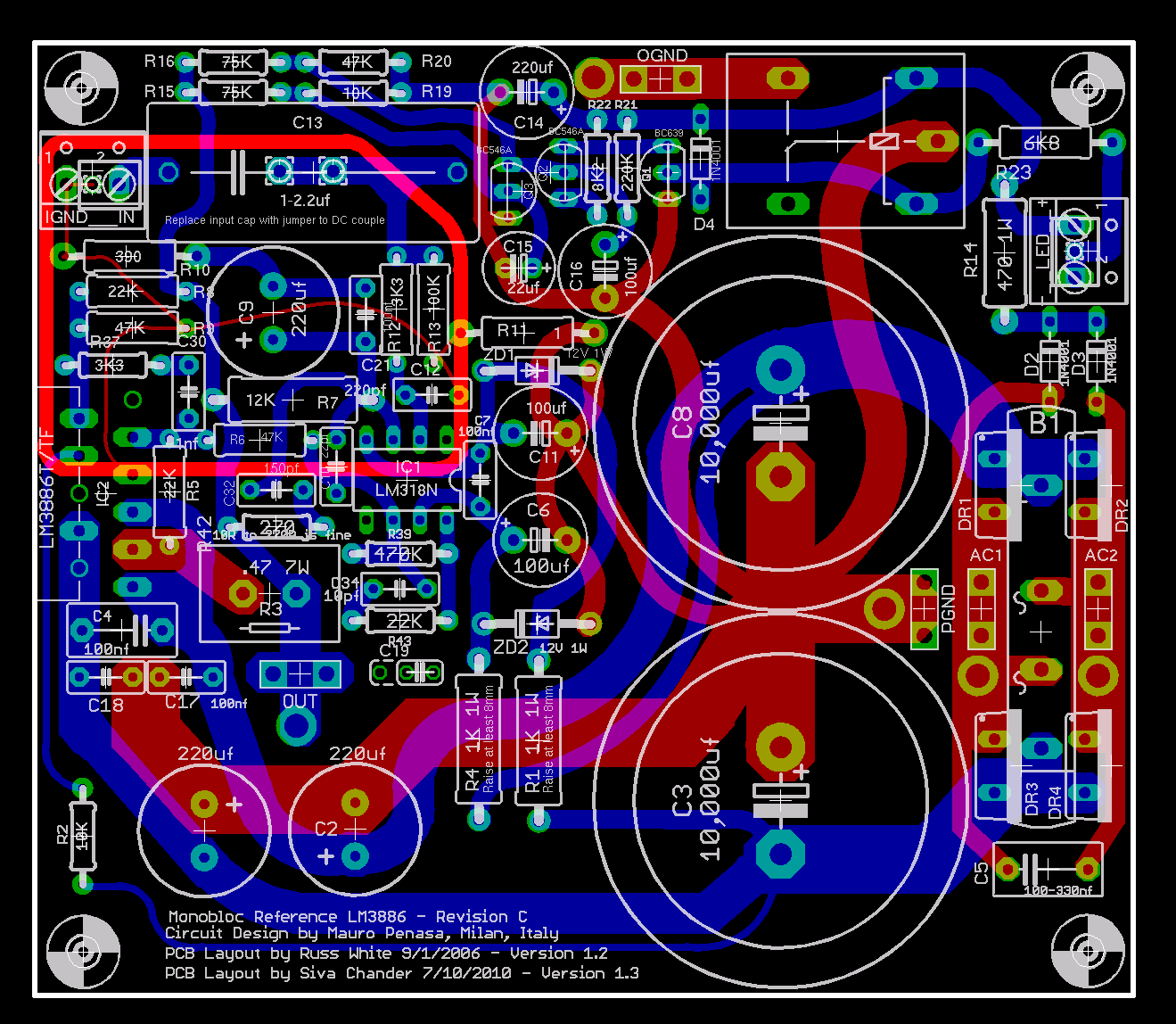

MyRef Version 1.3 layout
Not sure if this is the right thread to post this at, but it's not directly related to the MyRef build thread, so I decided to post it here instead.
Using the Twisted Pear Version 1.2 PCB layout posted here by Russ White in 2008 as the starting point, I made a lot of incremental improvements to the layout, now at Version 1.3. The changes are mainly in the following aspects:
1. Allows the use of larger-dimensioned electrolytics at several locations. This is particularly important for C1, C2, C3, C8 and C9.
2. Allows the use of a larger dimensioned input cap C13.
3. Allows the use of larger-dimensioned resistors at various locations, including R5, R6, R7, R8, R9, R10, R11, R12 and R13.
3. Improves placement of several components, notably in the region around IC1 (LM318). These include C6, C11, ZD1, ZD2 and the ground and power routing related to these. C19 and C20 have been dropped.
4. Improved ground and power routing at several locations, including separate star grounds for the power and LM318 sections.
5. Improved isolation of the signal ground plane from the chipamp power traces.
6. Numerous minor improvements in placement and signal routing in the small-signal input and LM318 compensation areas.
The schematic is exactly the same as before, with the same parts designations as Version 1.2 - so all the existing BoMs should work without modification, on the Version 1.3 layout as well. However, the board will be physically larger than the Version 1.2 board, which may be an issue with existing case/cabinet mounts and stand-offs.
Here's an outline of the layout, exported from Eagle. If there are any other changes/modifications that are considered desirable, feel free to post a request in this thread. I can't guarantee that I will implement it in this version, but it may make its way into future versions.
