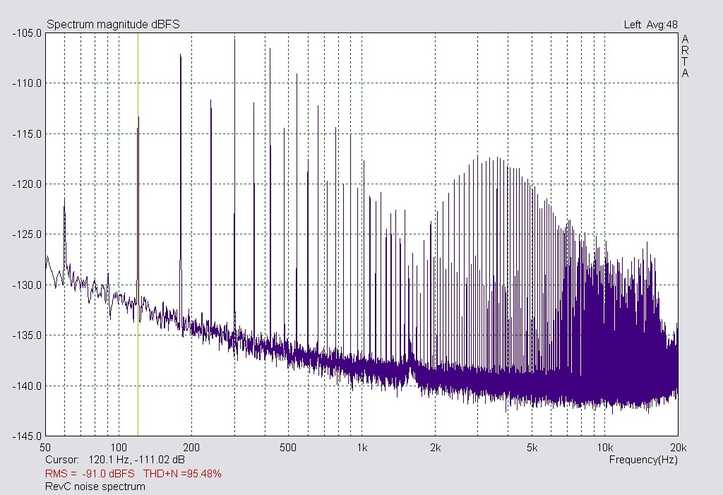

Got around to taking some measurements
For those who care about such things... I took one of the boards of my very first build and measured it in a mono configuration (just one channel) using the excellent ARTA software. Bottomline here is that thing measures really well. The one thing that I continue to have (minor, really; but it bugs me no less) trouble with is the rectifier hash. It is at -100dB on the output but it is there in all it spectral glory for many many MANY harmonics to go... ARRRRGH.
Below is the overall distortion at -5dB input (my measurement chain; going to -4dB on a pure sine wave makes it go into clipping; boy... NASTY waveform) and a picture of the noise spectrum with no input. All the spikes are neatly arranged at 60Hz intervals. Still at -100dB (or there abouts). My measurement chain (if the loopback test is to be believed is at -130dB noise floor).
More pictures at Picasa Web Albums - Peter - RevC Measurem...
Peter

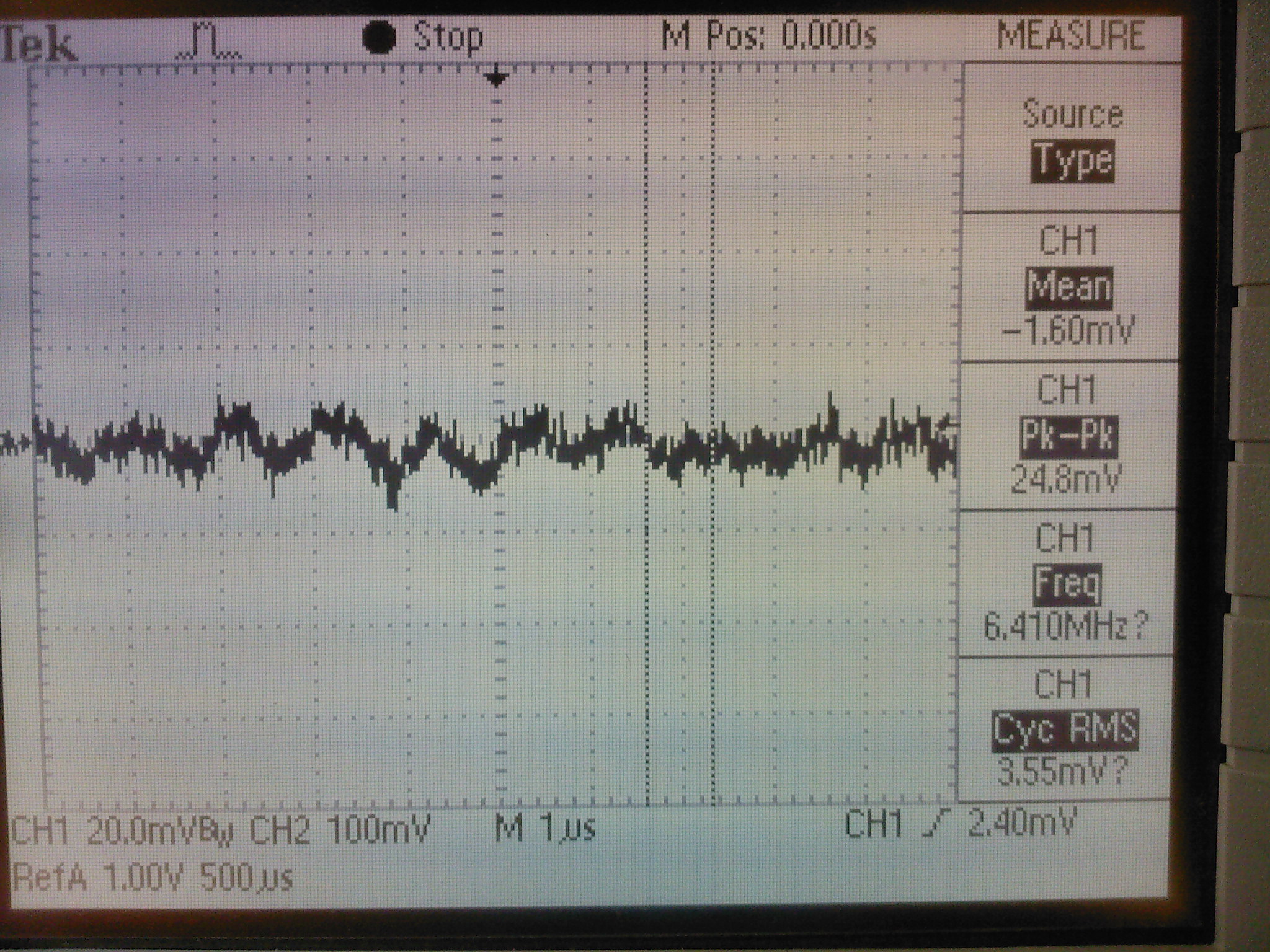

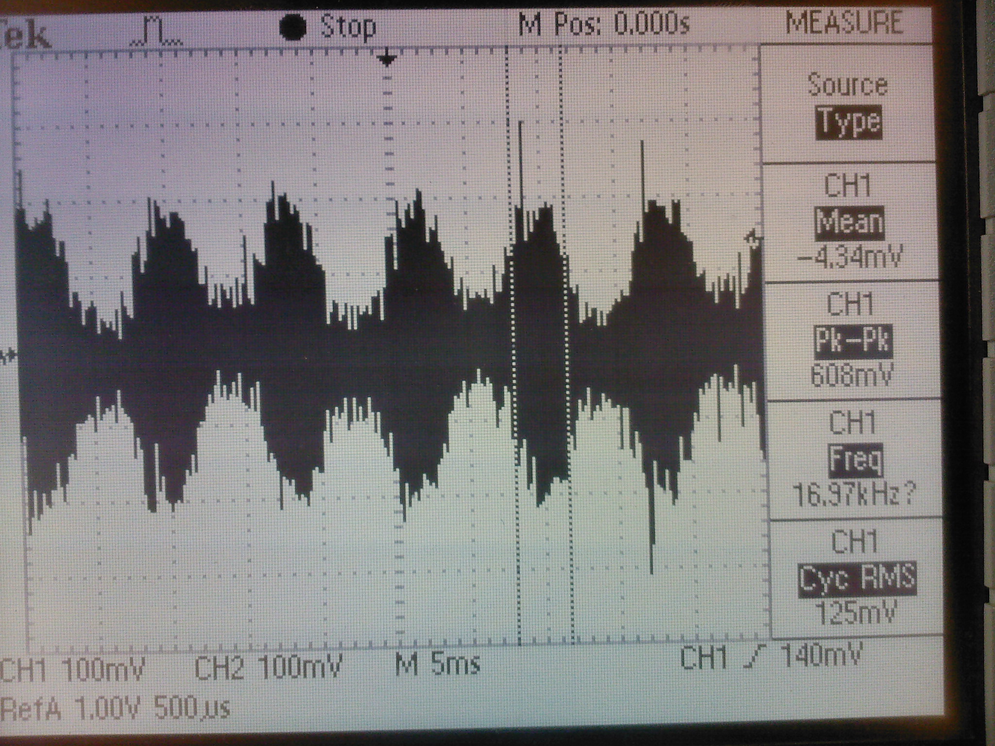

Attached are scope traces with open input and with shorted input. This is ch1 on my scope; horizontal and vertical resolution are stated below. This is measured across a 8 Ohm high watt resistor on the output.
I wish I had a scope like that.
But is it misleading you.
The noise bandwidth should be restricted to ~20Hz to 20kHz using low pass and high pass filters.
I cannot do that, I just use my DMMs (both have a 200.0mVac scale) which probably has a 10Hz to 500Hz bandwidth one of which I know still reads quite well to 50kHz, but is probably 10dB to 20dB down at that end of the frequency range. I am therefore reading Hum and LF noise.
Try clipping probe and earth leads across a 50r resistor or even just to each other.

surely that is with the probe open circuit.A fraction of a mV? Wow! At audio frequencies? How do you measure that? My scope picks up that much noise from the air...
Dear Andrew,I wish I had a scope like that.
in what sense is it misleading? The high amplitude trace with open input shows high frequency crap AM modulated with 120Hz. The result with shorted input shows something outside the audio range (though what I hear on the loudspeaker is "white" [probably more "pink"] noise).
You mean to learn what the scope itself contributes?
