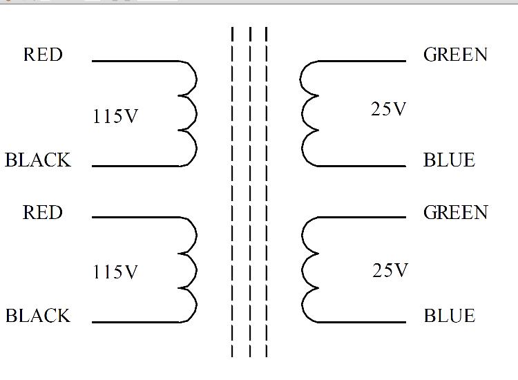

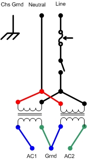

I have a question about wiring an AnTek AN-2225 toroidal transformer to the Rev C board. (toroid wiring attached)
I am using a filtered IEC C14 connector. I have the two red input wires from each toroid (4 wires total) attached to the 125V hot and the two black input wires from each (4 total) attached to the 125V negative. I have a separate green wire to the power ground.
I measured continuity on the secondaries on each transformer and combined a non-connected green and blue pair to PGND. I then have the other green attached to AC1 and the other blue attached to AC2. AC1 and AC2 now measure as continuous through the combined PGND.
Is this the correct wiring? I plugged my input, switch and toroids into my dim bulb tester sans boads and the 15 watt bulb glowed dimly. I measure 22V on each toroid between what I have labeled AC1 & PGND and AC2 & PGND.

mhconley said:I have a question about wiring an AnTek AN-2225 toroidal transformer to the Rev C board. (toroid wiring attached)
Thanks,
Martin
Red+Red------0000------Green
.................. 00000-----Blue+Green
Black+Black---0000------Blue

mhconley said:........................
Thanks,
Martin.................
OK - I have it wired correctly. Thanks Jericoh & Troy.
