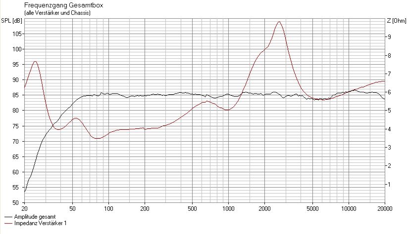

Hello guys
I have the same question for my Ref-C amp because my speakers have a small dip to 3,5 ohm between 50-100hz.
I have attached a pic with the simulatet resitance.
I hope this is not a no go for this amp.
If this so, i change the crossover. I dont want to make partys with this amp, its only for my workingroom so i dont need much power.
But the question is what is the best secondary rating for those speakers with this amp.

Edit: Sorry, wrong picture. This is the right one.

Hi Frog,
I think that impedance plot is telling us that the manufacturer used a 4ohm bass/mid and an 8ohm treble driver to create a 4 to 8ohm speaker.
You should design the amp to drive the 4ohm part of the loading.

The manufactor are myself, the chassis from Visaton. Bass are two 13cm 8ohm in parallel,mid one 13cm 8ohm(the same as in the bass) and treble are 8ohm too.
The crossover createt by myself with Boxsim(simulationtool for Visatonchassis).

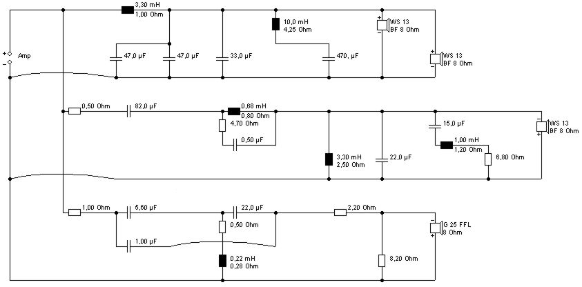

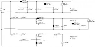

Here a pic from the crossover.
Udo
P.S. The speakers not finished yet, and changes in crossover are no problem.

the two bass/mid drivers in parallel is the problem. They are an effective 4ohm load.
If you drive the whole crossover with that 4ohm load on the other side then the amp must be designed to drive a 4ohm load.
If you can remove one of the bass/mid drivers then the crossover has two 8ohm drivers on the other side and the amp can be designed to drive an 8ohm load. But you still need an amp to drive the extra 8ohm bass/mid driver. This can be added to make a 2.5way speaker or it can be added as an identical bass/mid as the first with an identical low pass crossover driven by it's own amp.
There is yet another alternative.
Keep the parallel bass/mids and design a parallel chipamp to drive the combined 4ohm load. Each chipamp sees an effective 8ohm load and is designed as such. This is my least favoured solution.
Are the 3 BF8 drivers identical? Why roll off one of them to roll back in two drivers lower down? Throw away on BF8. Keep one as a bass only and the other as a bass/mid, this gives you that 2.5way mentioned earlier.

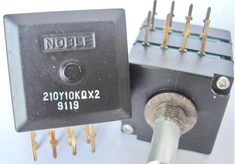

Re: Potential Potentiometers
Mauro suggests a 10KOhm potentiometer, parts you'd linked are 25KOhm...
I've read yesterday on the italian forum audiofaidate.it that Alps blue line of potentiometer are not in the same league of MyRef.
widman said:I'm planning to use a potentiometer at input for volume control. I'm considering the following options:
Any opinions on these or other suggestions?

This one seems nice and with reasonable cost: 😎
DACT Type 23 Stepped Attenuator Potentiometer 10K
Or if you really want the original: 😉 😀
Original DACT 10K
PS
The 'precision' potenziometer with 10%
tolerance is no so precise, IMHO
