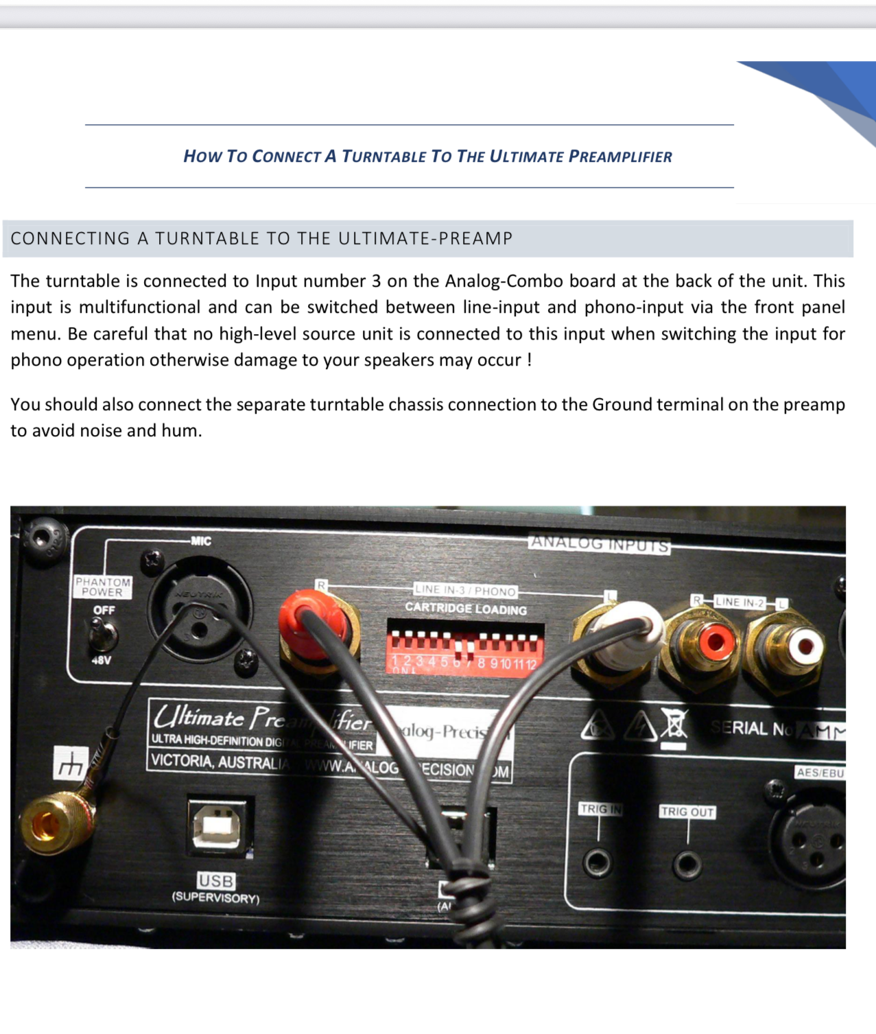

I think that is how Analog Precision does it in the Ultimate Preamp.
It does have facilities for optimal cartridge loading.
https://analog-precision.com/home/up2/
I clicked on your link and couldn't find any mention of optimising cart loading???
There are multiple DIP switches for that. They used to have a photo and a brief blurb on their website with a PDF guide. I think that it must have all moved to their support forum.
Aah, OK. 👍
