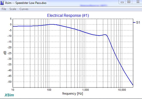

I've been listening to the Napoleon's for a few years now and they are a solid design. I've gotten alot of enjoyment, but have also replaced the tweeter a couple times due to inappropriate volumes.
I recently heard the speedsters at a local record shop Denovo Audio Speedster Kit
and they were impressive. Same tang band woofer, but slightly larger enclosure with the fountek ribbon. I built a pair and did the pepsi challenge (Sonus amp, same room and location) and am now going full speedster. Can't say one is "better" or not, but the ribbon definitely added some more midrange force, and the larger enclosure offered a little more punch. The other thing for me was that I'm using the Napoleon's as an outdoor speaker on my patio, and they lacked volume at parties (granted, not their intended purpose). The Speedster's definitely play louder and clearer at volume, if you're into that.

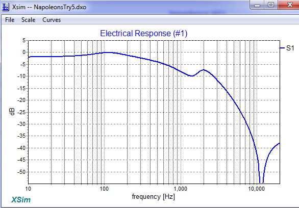

Glad they worked out Ok for you. I'm a bit surprised because they were specifically designed for the exact opposite use to outdoors: a small lively room (why I chose a tight directivity tweeter, back before waveguides were generally available), near field listening, tiny box, and use with a sub (purposely limited the bass).
The Speedsters would definitely be better for outdoor use, or a large room: wider dispersion tweeter, much bigger ported box that digs deeper. The Fountek is probably a better tweeter but I needed tight dispersion.
If you still have the Nap's, the last xover gives it better power handling and ability to play very loud.
To give the Nap's some credit, in my testing I found they have a better low pass crossover for critical near field listening. They do a bit better job getting rid of a W4-1720 peak just over 1k (it's not diffraction, its in the driver) and notch out the chaotic behaviour around 10 kHz better. This really improved clarity in my testing (I tried a crossover similar to the Speedsters).
I think the Nap's low pass with a wide dispersion high quality tweeter would be an interesting speaker. Hmm, maybe time to design an MLTL for the 1720?
"I think the Nap's low pass with a wide dispersion high quality tweeter would be an interesting speaker. Hmm, maybe time to design an MLTL for the 1720?"
I wasnt trying to start a throwdown, but i like where you're going. I think eeking out some more performance from the TB/enclosure and going with a wider dispersion lower XO tweeter to cover bigger rooms and more dB is a worthy challenge. Call them Waterloo 😉
