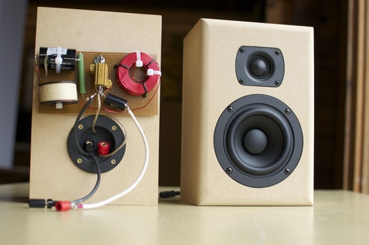

The Napoleons are a small DIY loudspeaker designed to deliver a natural tonal balance and clean loud playback from of a small box suited to both small and large rooms, at a reasonable price. This write up was in response to requests from the 2013 Ottawa DIY fest, where the speaker was first shown http://www.diyaudio.com/forums/clubs-events/223294-diy-ottawa-winter-2013-a-17.html

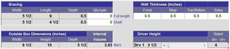

The sealed box is simple and was built using hand tools and a flush trim bit. Half inch mdf kept the box small which in turn keeps panel vibration under control. The box was made shallow to allow true shelf mounting. Woofer center is 3.5” from bottom, tweeter 7.5”. Drivers are centered horizontally.
A different baffle shape (for example due to thicker wood) would change diffraction and affect the response. This could require a crossover change and this design is expressed for 0.5” wood only.

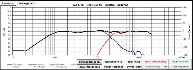

Crossover and Frequency Responses

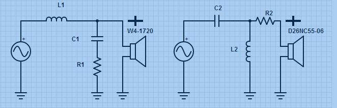

The crossover is a 6 element second order electrical, in phase driver connection. Special attention was placed on smooth on and off axis response, and a smooth response when standing while listening.
Low pass
L1: 1.5 mH inductor, 0.7 ohms dc resistance (18 gauge air core).
C1: 15 uF cap (not electrolytic)
R1: 1 ohm power resistor (10W or greater)
High Pass
C2: 2 uF cap (not electrolytic)
L2: 1.1 mH inductor, 0.5 ohms dc resistance (18 gauge air core)
R2: 15 ohm resistor, high power (25W or greater)
The full project write up is attached and includes system box tuning, material plan, numerous measurements from 20 Hz to 20kHz, along with design rationale and more detailed build information.

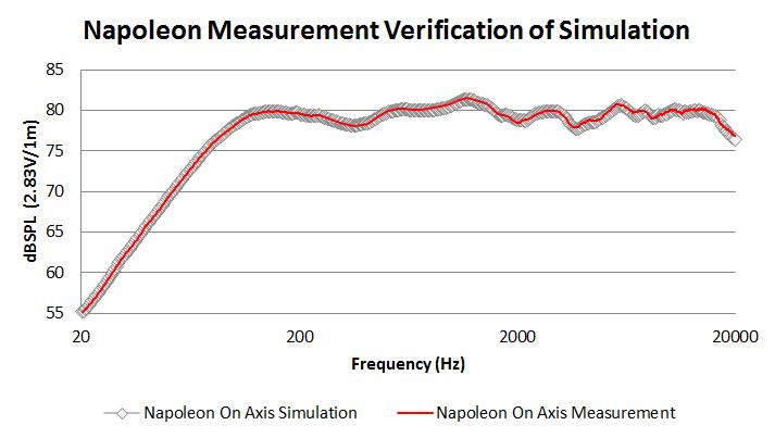

The frequency responses shown in my earlier post were crossover simulations using real quasi-anechoic driver in-box measurements.
I measured the system response tonight just to verify the accuracy of the simulations. As seen attached, they're dead on. I've also updated the pdf with this information.
