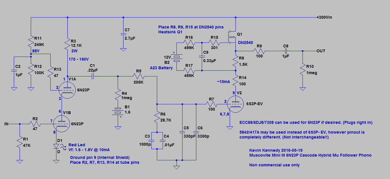

I have one minor change that I thought I would pass along to the few people I know are building this design.
I have changed C9 in the mu-follower from 0.1uF to 0.33uF because increasing the size of this cap seemed to improve the bass quality slightly. The original value resulted in an F3 in this stage of about 1.6Hz, but nonetheless the larger value seems to provided some limited benefit.
Likewise the design would probably benefit from an increase in the value of C1 to 0.33uF or even 0.47uF, provided the turntable used does not produce excessive rumble.

Referring to post #24 I used TRW metal glazed RN70D resistors I had on hand for R3 cascode plate resistors. I don't know what possessed me with a desire to replace them, but I just replaced them with 2W Mills I originally purchased for this project (they've been in and out) and a mild high treble coloration that was becoming irritating with the very forward sounding Windfeld is now gone. (It was always there, but the other cartridge I use on this table is much more laid back sounding/less aggressive) I'm at a loss to explain, but I generally don't use those TRW resistors in very low level audio applications.
Also after repeated experiments with other EQ caps the Russian teflons mentioned elsewhere seem to be a good choice for this design.
