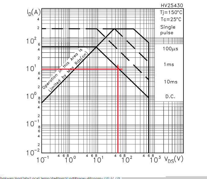

I have IXFN140N20P in my hand,using to build pass 50W SE amp.can I use this guy for the output?
recheck the IXFN50N120SiC datasheet,strange to me that it does not provide the Pd - Power Dissipation
IXFN140N20P - yes, with care of not exceeding 6-7A in any moment - take a look at SOA graph in datasheet, observing conditions for DC
