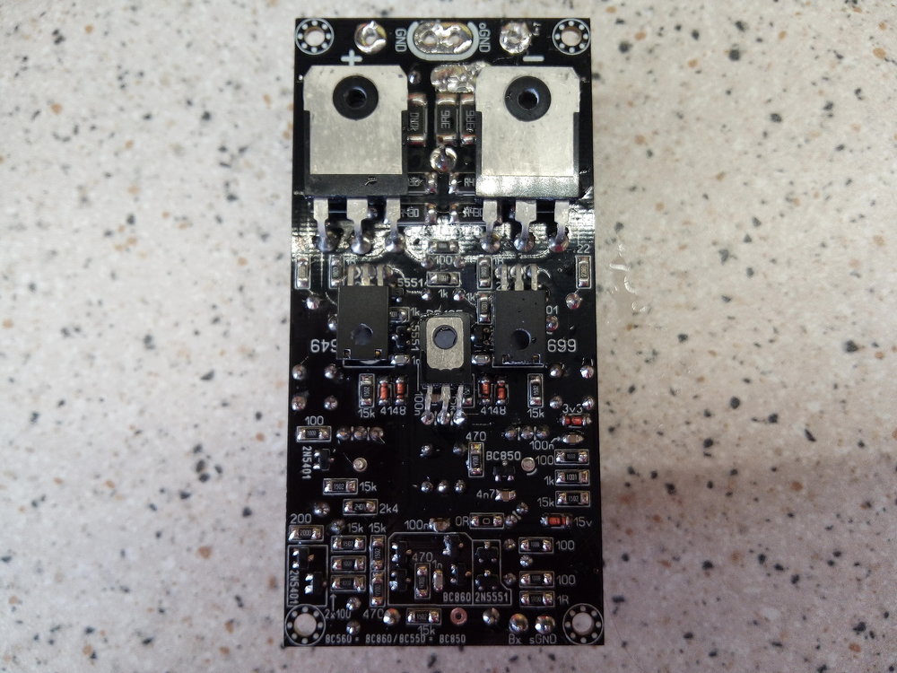

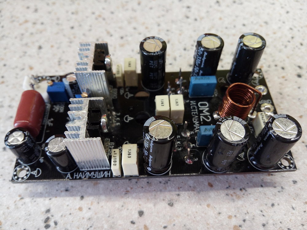

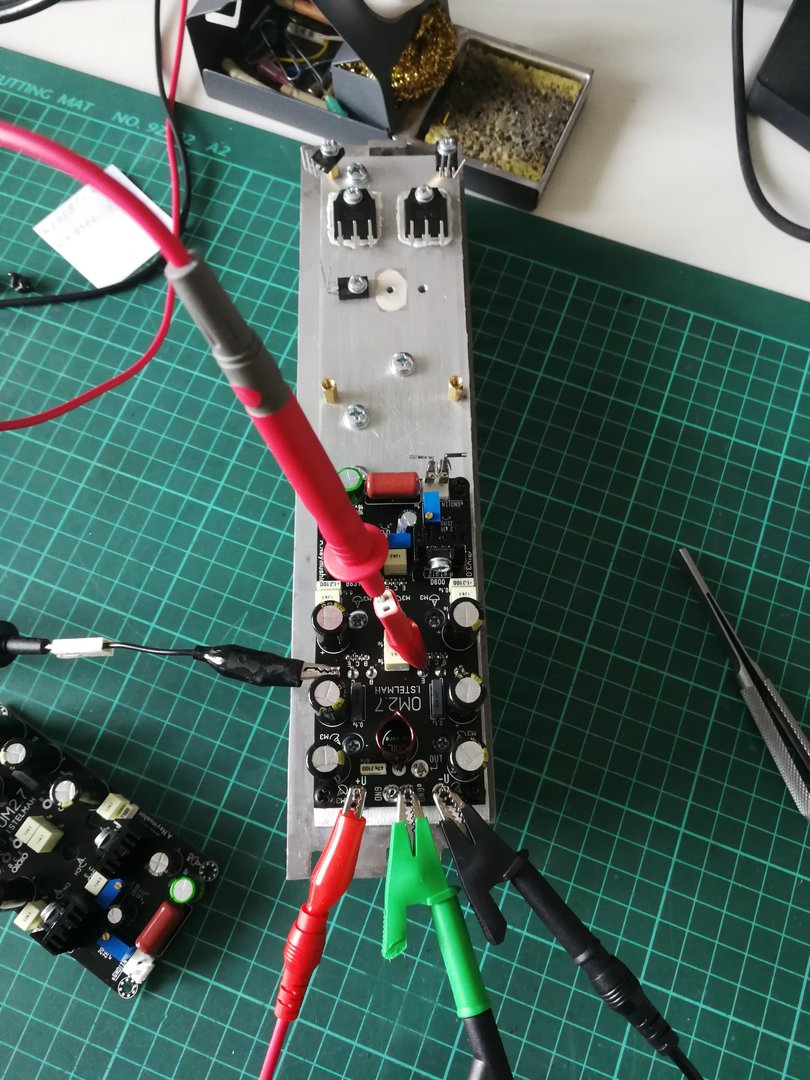

I didn't want to offend anyone, these are just my subjective impressions from the first listening. Later I will try to take measurements using my personal computer, although I am not sure of their accuracy.

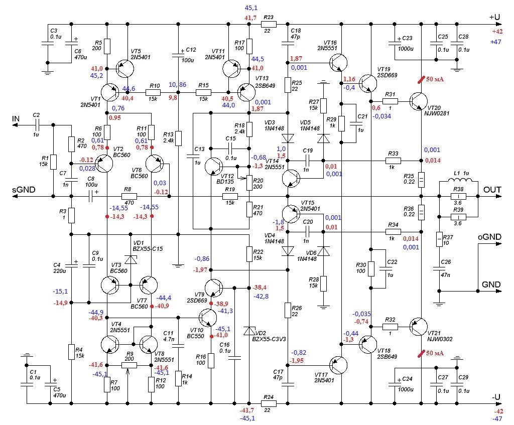

Here is a link with an article and measurements of this amplifier. Use Google translator from Russian, everything is there in detail.
Усилитель мощности Only Music 2.7 (ex "оплеуха микрухам") [2018]

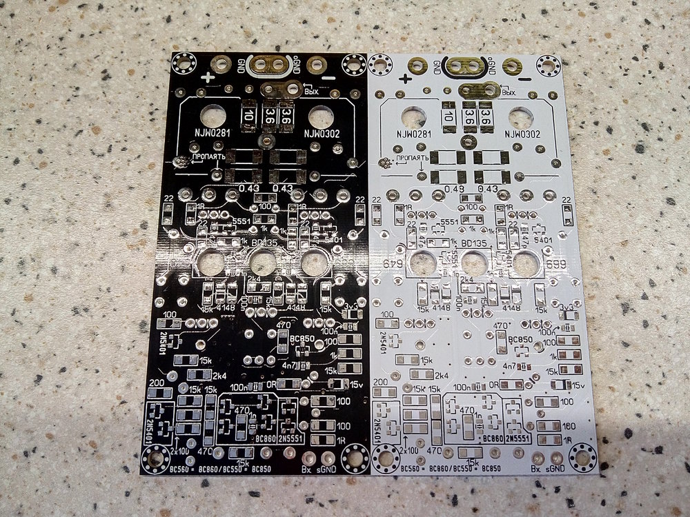

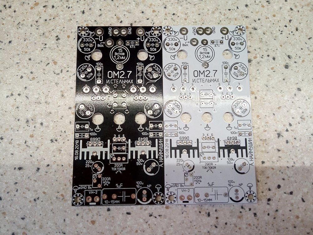

And there are boards there with a more correct wiring...
