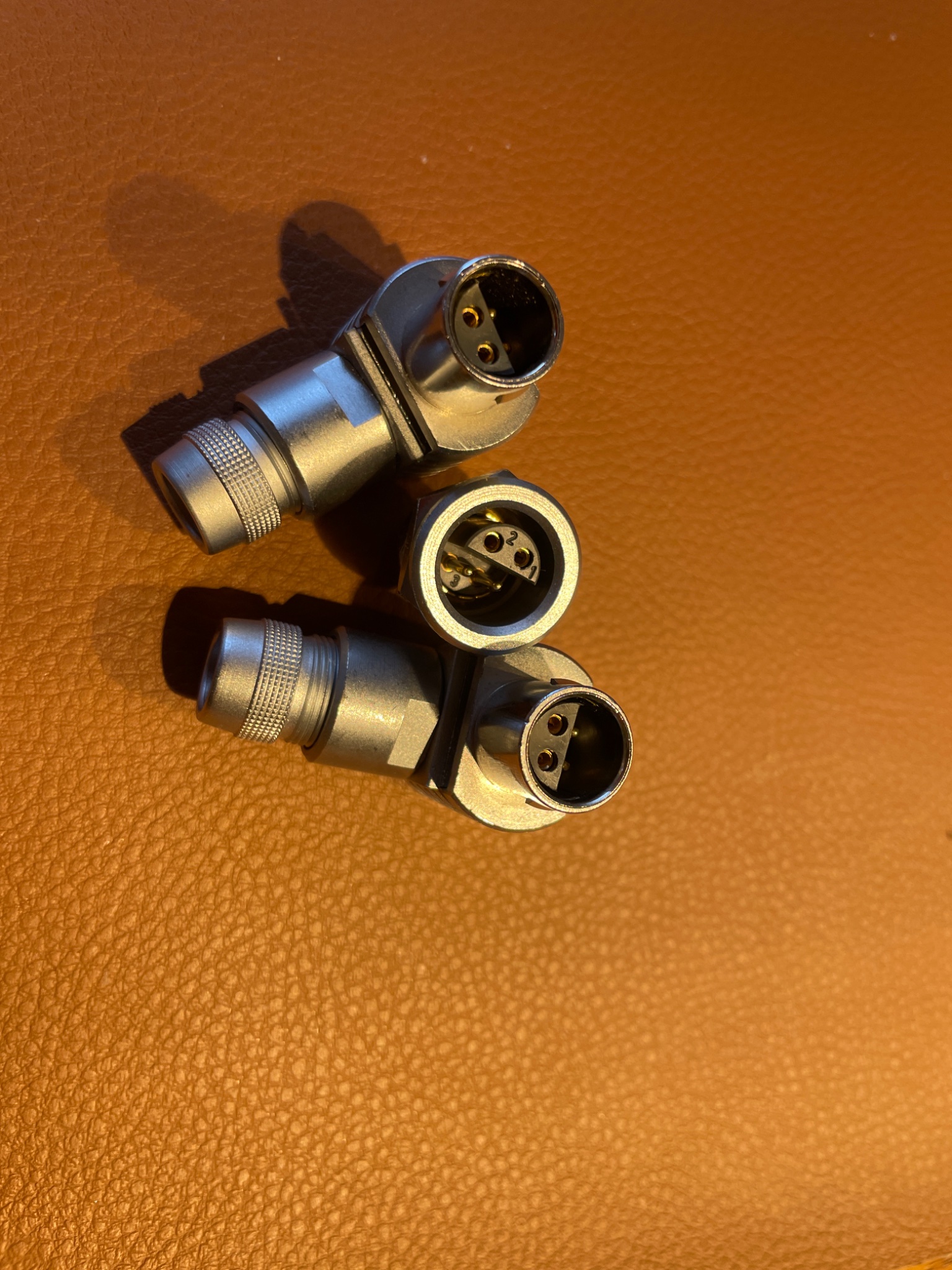

You could choose your own desired standard as all the stuff that is commonly used has low cost as key parameter. Not a headphone man myself at all but when I have to try such stuff it always strikes me that crackling because of the connectors is often fully accepted as being unavoidable. What about 4 pin Lemo? It would require the headphone to have the connector too of course but it will pay off. You will not regret choosing a good connector set with non crackling contacts.
Reactions: SonocusEric
As OP correctly wrote standards seem to have become flexible (except for key parameters low cost/low quality/plastic fantastic). XLR being the exception but it is bulky and what when that super super headphones of 2025 has a 4.4 mm jack? Please don’t say “adapter cable”.
Be free, earmuffin. There is no substitute for freedom. Also not for quality 😀
