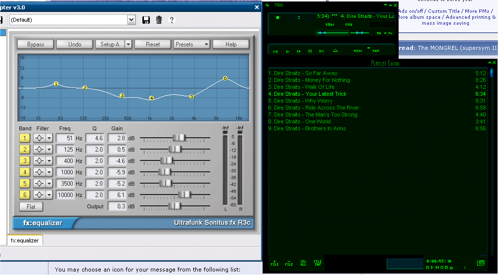

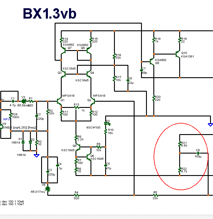

Now that my powermad listening tests are over , let me clarify the results (turning on winamp-below 1).
What I compared was a "blame ES like" voltage stage with a TRUE "blameless" compensated with TMC. I said the ES could hold it's own against a much faster blameless (1mhz unity gain point / 75v/us slew). The ES has a natural rolloff and slew limiting thanks to the bootstrapped current source. This gives a natural sound with smoother bass.
Uncle charlie.... Do you know which will stay in my living room ?? .. the "ES" type. Even as the highs are a little more pronounced on the blameless's , I like "mellow". You notice on (pix 2) the BX is different from the ES , even as it probably sounds VERY similar. I actually had to go to the Blame ES schematic to see the order of the 2 bootstrap resistors (smaller one goes to negative rail - pix 2) ... I am not a "bootstrap man" , you are !! :eek: I had 100mv offsets with the larger resistor at the rail. Had to calculate the 2 resistors for 75 volts as well (6.8k
+ 4.7k =11500 75/11500= 6.52 ma VAS). This is another drawback , the "ES" type is not scalable without actual component changes. The CCS'ed "blameless" will hold 6.25ma (AX) from 40 -75v easily.
So each way ...CCS or not , if used properly , has advantages. Both sound AWESOME.

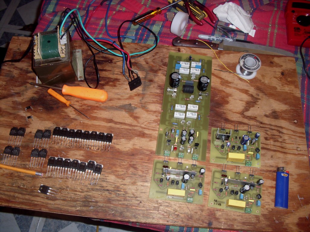

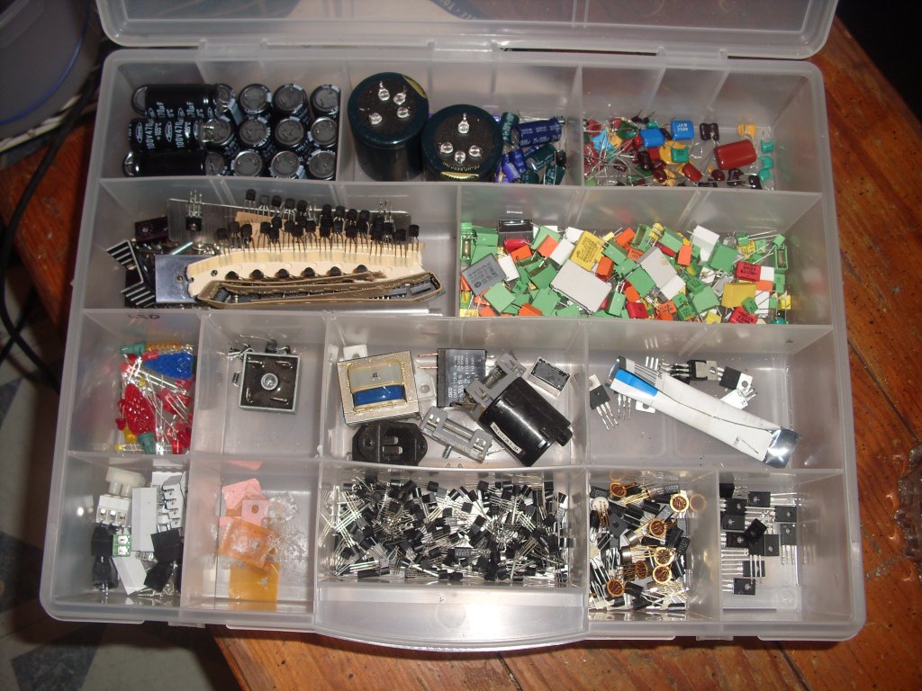

(last attachment - 10th power board.. for neighbor) Simulation is nice , but you have to build to get the final "bugs" out , both electrically and soundwise. :D
BTW , 12 OPS boards (6 stereo pairs) , 6 power supplies and softstarts ,14 bx/ax's .. 1 1/2 gallon HCL 1/2 gal H2O2 8cu.ft FR-4 and 2000 freakin' holes later .. lots of amps ... MERRY christmas , Hugh and Charlie :) :xmastree::xmastree::xmastree: I will unleash these tested and wonderful things soon with pictures,current/ voltage readings (45 -75v). They have every "trick" in the DIYA land thrown into them ... reliable, over rated and safe.

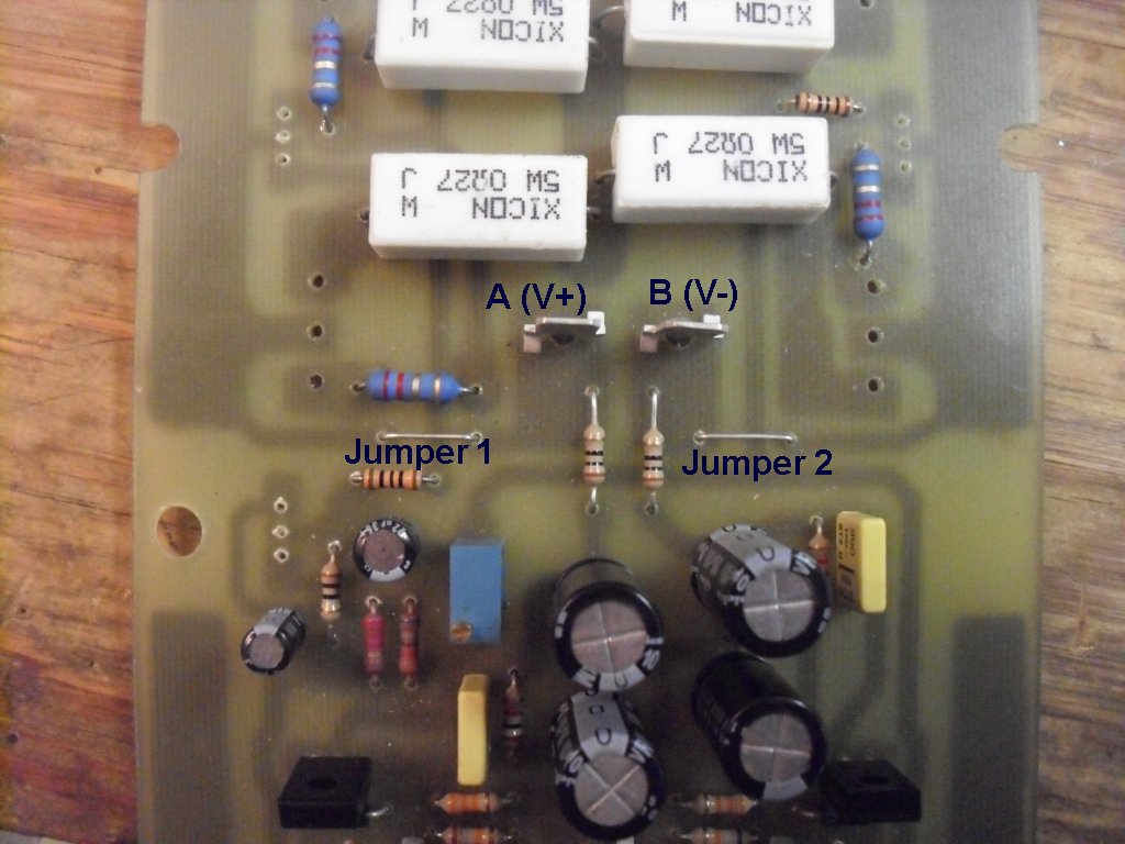

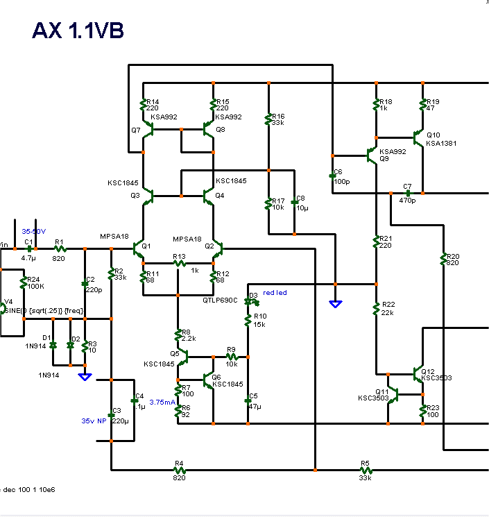

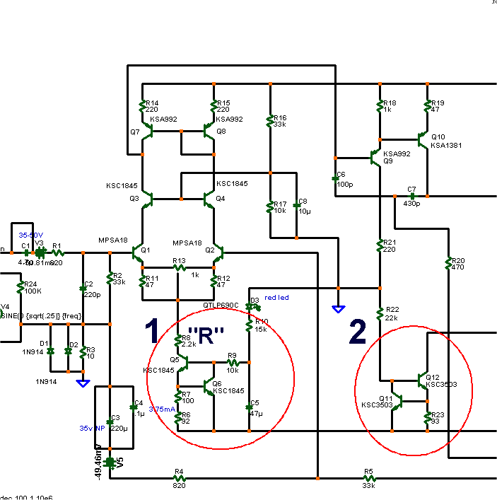

I have tried all the different CCS's , each will have a different sound especially when used on the LTP. RED LED or double diode is nice , but will be offset by poor PSRR. Double transistor CCS's have the best simplicity to performance ratio. With a 2 resistor feed/cap (below 1/ #1 - R9/10 - C5) , 70db or more PSRR is available. When combined with even a first order capacitor multiplier , stereo separation is quite stellar :) . R8 ("R") on the AX CCS is the one that doug self said to eliminate , it does increase distortion slightly but decreases H3 and adds H2 at 3.3ma tail current , also it allows a handy measurement point to adjust the CCS (CCS adj.) , 7.5V / 2200 = 3.4ma (my suggested setting).
(#2- pix 1) is a fully separate high gain 2 device CCS for JUST the VAS. This really drops the THD in simulation to make even a un-TMC'ed amp have .3ppm
at 1k /50w. Both these CCS's are fed from the negative rail cap multiplier , I have seen no more than a couple uV ripple in the sources while going full out nuclear with the Mongrel PB250/AX combo ... truely a "lab amp".
I have scoped the left channel while blasting the right , NO wave at all , even at the uVolt CRO setting. Some would do the fancy regulator , this would improve things ,but would you hear it ??? A couple uV's versus .01uV @ .001R output impedance ???
I will explore this with my setup also (pix 2 - A/B) Those are separate taps (clip jumper 1 and 2).Imagine dual 80v salas shunt regulators running the AX or BX - one PURE amp "sippin' on some clean "juice". LABAMP , for sure.

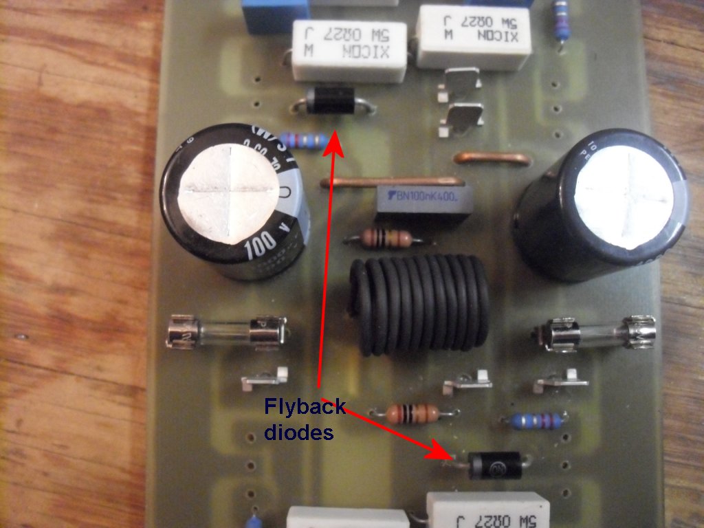

Oh carlo's .. a suggestion , Add some "flyback diodes" to your amps (MUR - 460 3A -PIX 3), a nice safety factor , especially for woofers with massive magnets/ voicecoils :) The "supercharged" running 4R massive woofers would benefit greatly.
edit: , as far as a lack of trebel w/ bootstrap , the TYPE of bootstrap cap is VERY important , a cheap chinese 63v/100uF vs a panasonic ultra low ESR EE series can be easily heard. I'd love to try a "blackgate" , but they are discontinued , and i will not use obsolete parts in my amps :nownow: .

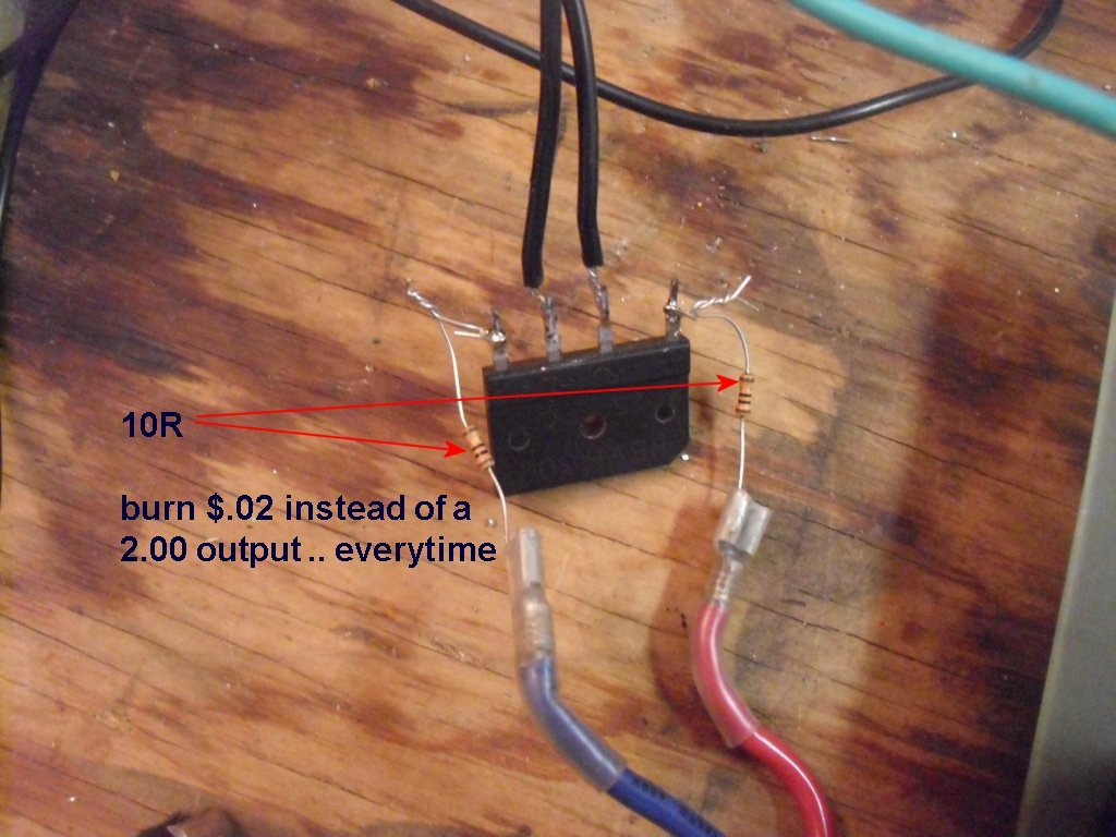

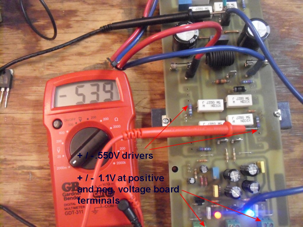

I also Fuse the bridge rectifier (PIX 2) with 2 1/4 watt 10R resistors , these can even be used as a safety factor with the "1 pair output test" (main outputs). You can also set your V BIAS (Vbe) until you reach + and - 550 millivolts (pix 3) in preperation for the first pair main outputs, this will bring most outputs into an unbiased, (class B) state. :)
At this point you are ready for 1 pair of main outputs .... stuff them and attach to a temporary heatsink (larger of course). After doing the steps above , you should be slightly below the class AB point (Class B) ... 0 mv/ma. A couple turns on your Vbe you should see a millivolt or two across your .22/.27R emitter resistor(s). I bias to 17-18mv on my .27R's and 15mV on any .22R ouput stages. From here , I stuff all my output devices (after doing a Hfe test for a "raw" match. On my 8 device boards , Re readings within a millivolt on all 8 devices assure me of good current sharing. The basic Vbe operation can be tested in "test mode" with a lighter.. 1/2 second "flick of the bic" :redhot: , should drastically reduce the bias ... blowing on the Vbe tranny will bring it back up just as fast. :D
A final test on the permanent heatsink is simple , After thermal greasing and running/inspecting the amp ... run a hairdryer on the heatsink. 60+ C is a good upper limit and If you live in a cold climate , put the whole amp outside in the subzero (-10C). The PB250 in the pix will stay between 15 -18mv per Re ALL THE WAY from 15C to 60C. When heating from the hairdryer it will "overshoot" 17mv Re then go back to 15-16 as the hairdryer brings it up to 60C. A much worse scenerio than anything in the home or even what the great outdoors could subject it to. When I last listened to the old PB250's , they were at 17mV Re .. the same as I set them to 4 months ago. Thermal issues and durability are among the most important issues , NO burning amps around here !!

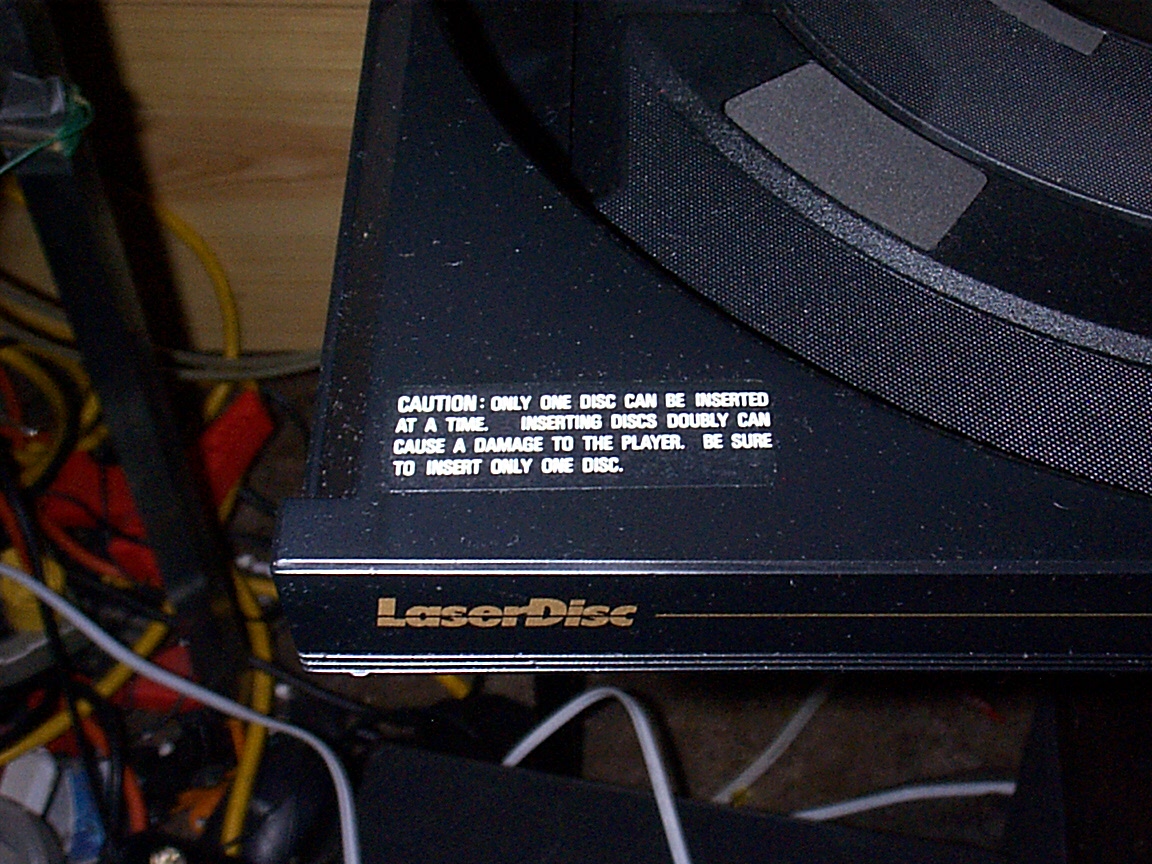

OT, but I got an awesome laserdisc player. I am SO happy. I got a laserdisc titled "Lee Ritenour and Dave Grusin, Live from the Record Plant". AMAZING. It's a Pioneer CLD-1030, from 1989, I demo'd all the other players and this was clearly the best... For $20, in fine condition!!! So even if I lack good laserdiscs, it is still a CD player, which costed half as much the players at walmart but is many times more valuable. Now I need to get my Soraya working. Hugh, are the TO92's important or can I use the KSC1845/A992 for the Soraya boards you gave me?

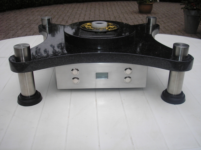

The last few weeks I have been following the treads here on the Forum in order to build an Amplifier
First it was the Goldmund tread then I order the boards in the hope that there are some people build these Amplifiers so that I could learn something from you all here to build this Amplifier.
Now I follow this tread of OS and hope that there will now a final product comes, so that we can order here the printed circuit boards.
As I have already reported I am not an Electro engineer but with a little help from you all for example, how I should measure the circuit, surely it should be feasible in order to build this amplifier myself.
It seems to me in any case a challenge to build this amplifier.
There are several designs but my feeling says that this should be THE Amplifier.
I also build the Shigaclone CD Transport myself with a little help from other diyers.

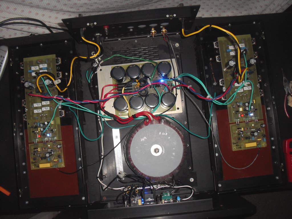

Both BX and AX (wow!!) are approved. (winners and losers)
I have both final (new PB250-H) channels done (PIX-1). Yesterday I ran my AX/BX's on one old one and the one new one.
I don't care if carlo's (DX) gets mad on this one , but the current sourced, TMC'ed blameless's really exceed any "ES" style amp. In other word , the mighty AX blows the "ES" away :eek: ..
Don't get me wrong , but the BX/ES was tried with multiple compensations , I can even adjust the tail current while in operation. Matched pair with .5mv offset BEFORE adjustment , faster devices...
They scoped perfect , no ringing or errata ... and they sound better than any symasym or even the luxman clone. All these VB's sound better than my discrete OEM receiver (I still have one :eek: ) , but the bootstrap restricts slew , (amp is slower by design). A strange thing about the bootstrap , it sounded better after it was ran hard ( bedding down ?? :confused: )
Me and a few musician friends (lots of them in pigeon forge , tenn.) listened to the BX's with a variety of music (classic , classic rock , jazz) for hours. they had "strong emotions" and wanted to buy some.. :)
I said "wait !" ... screwed the AX's in and cranked it up AGAIN. WOW !!! :eek:
was the response. They were astounded that the same amp could even sound better. I told them these were the idea of a dead english guy (Baxandall) , who had his papers released by another english author (D. Self).
So , as an audiophile , and designer who has built them all (pokemon) , the AX is the "holy grail" .... it's sound won't just give "strong emotions" but will absolutely "knock your socks off". I "fine tuned" TMC to MY amp (100/470p - 820R{Rtmc} ) , the bass is even better than the BX/ES now. (absolute final schema below - PIX 2).
I really like the BX's (PIX 3) , they will go to the "doghouse" (barn/lab) hooked into the NEW 2XPB60 (dual modular 60w test board) , I still have "strong emotions" for these ... but they can't match the AX. Another thing , the AX really ran away With the ball at high volumes (massive sound stage - impressive bass) , this must be TMC correction.
I will work hard now to turn all this work into concise projects , a few updates are required since these are REAL now. :)
OS
