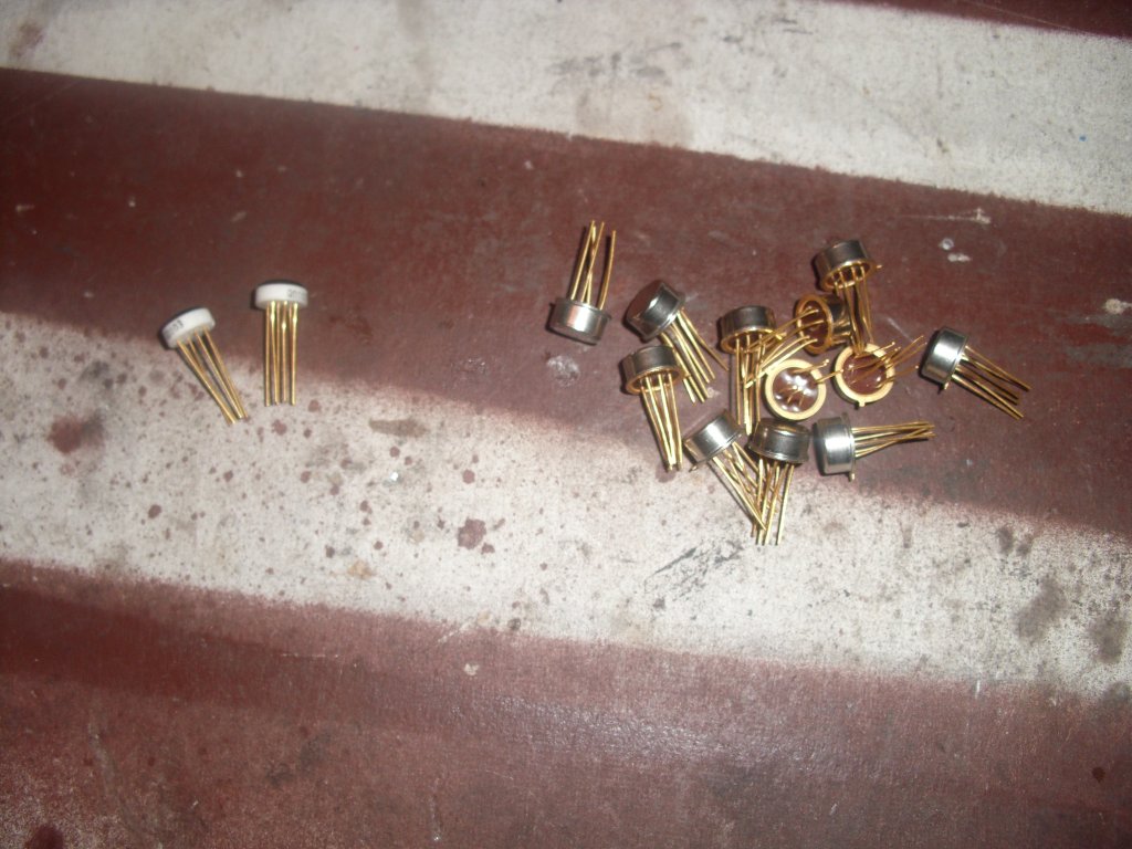

BTW , the "goldmund killer" (CX1.3) gets stuffed tommorrow AND lookie what I gotz .... (BELOW)
OS

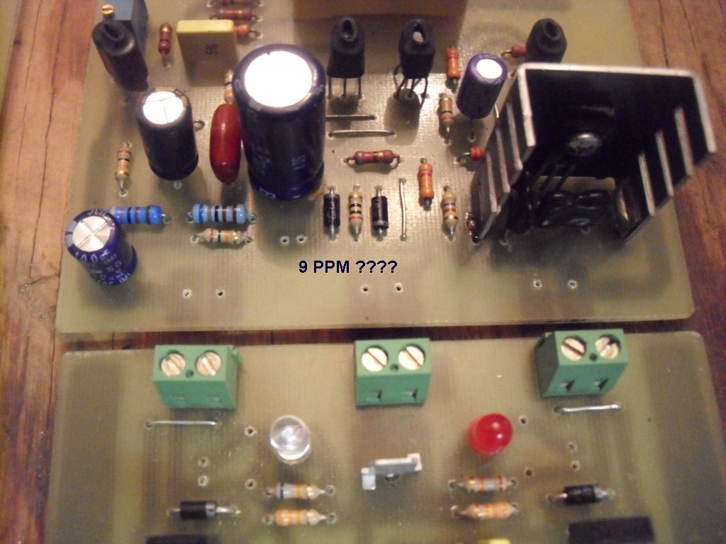

9parts per million is 9/10^6 = 0.000009 = 0.0009%
I see 0.000009% as the simulated/predicted distortion on Ost 900 pic.
So what I have is .9 ppm ..WOW! I was basing from .1% not a full 1%

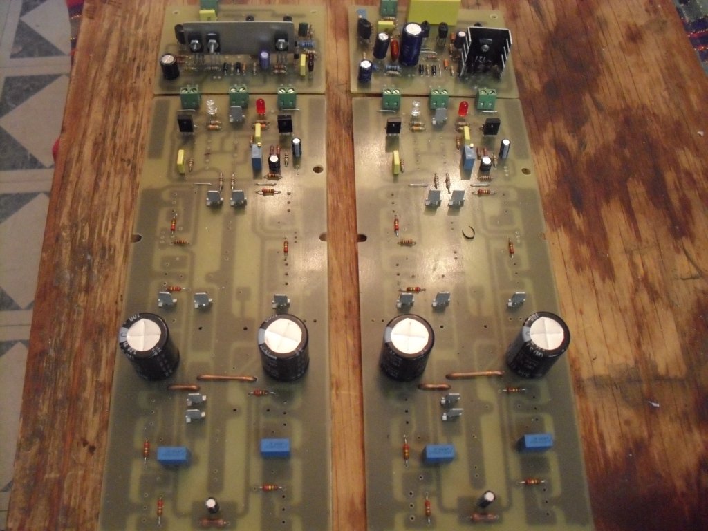

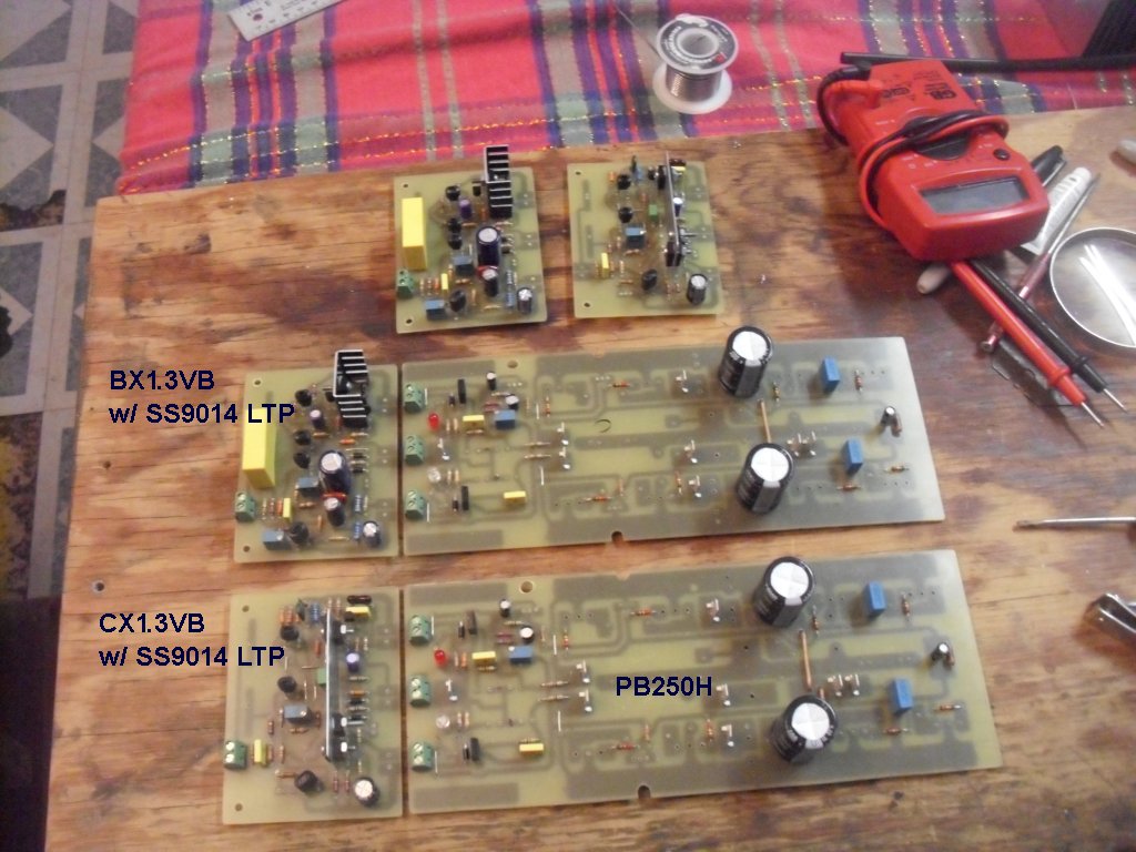

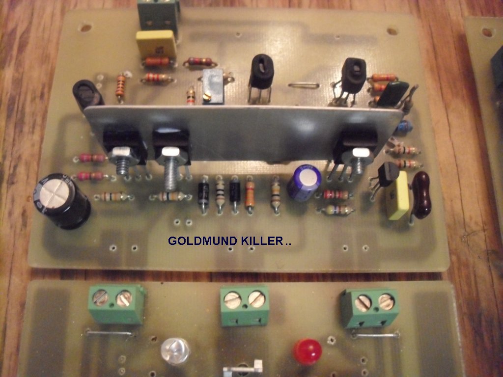

ALL READY NOW... my "frankensteins" will LIVE.. ah haha
Finished the "goldmund killers" , much harder / more parts than the simple blameless's. I know they will not blow up , ampslab's bi240's (very similar) are proven. I know they are more stable and faster than the infantile goldmund designs . This is the 3' rd pair of "symasym" type voltage stages I've attempted , If these don't impress , I guess I'm a blameless man. I still have the "leech" (LX) to perfect/design/build ... so there is more to come. PHOTO's of perfect builds below !!!
OS
