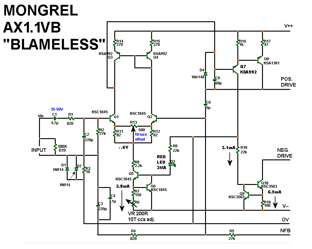

The AX1.1VB is nearly finished. You can print it out..
A really nice "blameless" based amp , phenomenal sub .002% THD20 at 1/2 throttle (65-70W) and .0005% @ 1KHZ. I got there by NOT referencing the 2 CCS's to the "isolated ground" (PCB also has these changes). I also changed ALL small signal devices to KSA992/KSC1845 (ECB). ALL these devices are oriented for "face to face" thermal coupling.

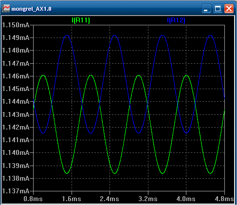

Another factor in the exceptional performance of the AX is the LTP's "CCS ADJ." I adjusted it until my LTP currents were within 10uA !! (below) 500 HZ was not as good as 10KHZ (3uA) but still pretty tight. 🙂

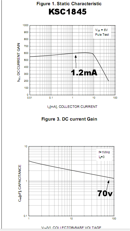

The KSC's "sweet spot" seems to be at 1.2 - 1.3mA with this amp , making for the best THD figures. BTW , the datasheet shows the highest gain and lowest Cob @ 70V / 1.2 - 1.5mA (below).

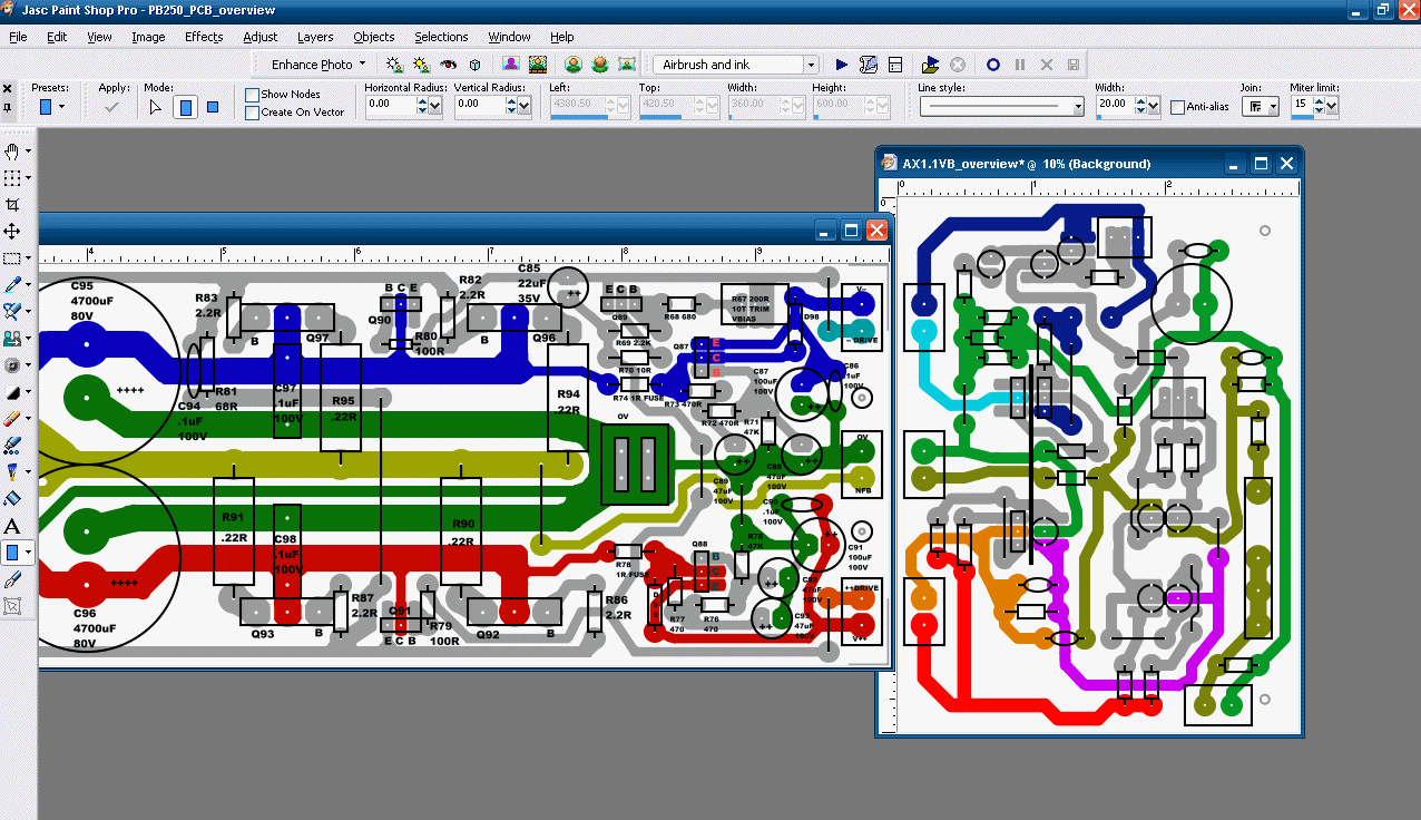

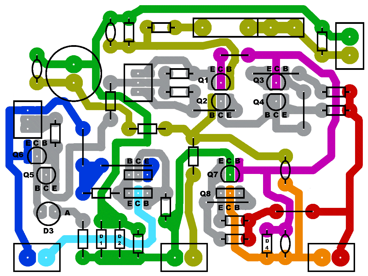

The board overview is below as well as the new schematic. Please look for any semiconductor errors (they are marked). Power lines and grounding were hopefully optimized.
Green= ground (both "dirty" and "clean" after D1/D2).
Red= V+
Orange=positive drive to power board.
Blue= V-
Light Blue=negative drive to power board.
Pink=drive to the EF VAS
Yellow = both the input and NFB signal path(s) .
Red= V+
Blue= V-

Anybody that downloaded the AX board (15 DL's), it is not faulty electrically ..BUT , I messed up 😱 😱 ... the spacing on the interface w/the powerboard .. re-download - all fixed , even nicer layout (below).
