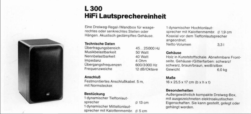

I think you refer to Braun L300. I believe it is the smallest 3-way speakers : ).

When @wolf_teeth made a tiny 3-way, I thought it was a novel concept. I had no idea it was done 50 years ago!
Machine Learning translated:
"This is a three-way shelf/wall speaker that can be placed horizontally, vertically, or even hung up. The housing is acoustically damped for better sound performance.
Technical Data:
A remarkably compact three-way system with excellent electroacoustic performance, offering versatility in placement—standing, lying flat, or wall-mounted"
It was around this time that David Wilson released his first speaker using Braun and KEF drivers and Crown crossovers
Technical Data:
- Frequency response: 45–25,000 Hz
- Music power handling: 50 watts
- Nominal power handling: 40 watts
- Impedance: 4 ohms
- Crossover frequencies: 600 / 3,000 Hz
- Crossover slope: 12 dB per octave
- Built-in 5-meter cable with a standard plug
- 13 cm dynamic woofer
- 5 cm dynamic dome midrange
- 1.9 cm dynamic dome tweeter
- Coaxially mounted in front of the woofer
- Wooden core encased in plastic with a removable front panel
- Available color combinations: black/black, brown/brown, or white/silver
- Weight: 6.0 kg
- Dimensions: 16 × 25.5 × 17 cm (W × H × D)

I had not heard of the Braun 3ways either. Really, it is an advantage to not need the chamber for the midrange.
