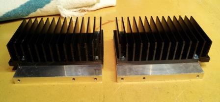

While waiting for the chassis to be anodized I made up a pair of mounts/heatsinks for the Rod Coleman filament regulators. They are built from a 10mm thick 3.5"x 4" aluminum block, with a salvaged heat sink from an old subwoofer amp screwed on. The filament regulators screw to the side of the block opposite the heat sinks. The blocks are drilled and tapped to mount snugly to the underside of the chassis top plate, so between the block, the heat sink and the top plate I ought to have enough thermal dissipation (hopefully, since I don't know the degC/W of the salvaged heat sinks).
The heat sinks look to be about 10x15x5 cm or so. They'll probably have a thermal resistance around 1.5 º/W if mounted with the fins vertically. That's my guess based on similar heat sinks.
If you really care, you can always measure the thermal resistance.
Don't forget to use thermal goop between the top plate and the heat sink and aluminum block. Thermal sandwich... 🙂
~Tom

The sinks are 11x6.5x3cm, so a little smaller. They are also located near the fan intake so hopefully the 33cfm of the fan will boost their heat dissipation somewhat. I used boron nitride heat sink grease between the sinks and the block, and will repeat that at all locations with thermal interfaces. I also plan to use an aluminum clamp to hold down the transistors so that ought to add some dissipation from the other side of the chip as well.
The vast majority of the heat will flow through the metal tab of the package as the thermal resistance through that path is much lower than through the plastic package. Unless the clamps make assembly easier, I would probably stick with the normal screw + shoulder mounting method. If you want to get really fancy, you get a torque screwdriver and tighten the screws to the torque recommended by the manufacturer of the thermal washers.
~Tom
~Tom
There is an additional wrinkle here, in that the Coleman regulators will be floated at approximately 250VDC in order to provide the appropriate bias. Rod Coleman himself advised me not to use a metal mounting screw with shoulder washer in order to avoid a potential failure. The way I look at it, I have a couple choices:
1) Ignore Rod's advice. I'm inclined not to.
2) Use a nylon screw. Since nylon doesn't melt until 220C, and the chip would be toast well below that point, it should work...unless it comes loose over repeated heating/cooling cycles. Loctite might help there.
3) Use a clamping bar across the chip package, and maybe a nylon screw through the TO-220 tab as well.
I'm leaning toward #3.

Hi Magz, you could also use ceramic insulators under the TO220 packages:
Insulators - heat sink interface material
You can also get longer and slightly thicker insulating bushes for the screws. These need the top of the threaded hole in the heatsink counter boring slightly to allow the bush to sit down on the tab.
I have used these before on floating HT regulators and they work fine, certainly better than mica or silicone insulators. i am not at home at the moment but I can post a photo later if you like.

It is possible to use the screw-fixing method across 250V, but a high degree of care is needed in cleaning up the hole (dia 3.5mm please, be sure to allow the shoulder-washer to enter the hole). The finish and flatness of the surface must be carefully inspected.
other considerations:
- the 833 cold filament is probably near zero ohms at turn-ON. The Coleman Regulator soft-starts the filament with a gentle ramp-up of voltage, but the startup interval still applies heightened thermal stress on Q5. The thermal interface must be in good shape!
- The materials of the heatsink, transistor, screw and shoulder washer are all different, so differential expansion may be at work, and a flash-test on a cold assembly does not guarantee that warmed-up, the insulation integrity will be maintained.
- screw method is not preferred in any event. It applies the clamping force to one end of the TO-220, unlike clips and clamps acting on the insulated portion of the transistor body.
- spring clips are purpose-designed to apply the correct mounting force to the body of the TO-220, and are superior to screws in this respect. In addition, there is no insulation weakness at the screw hole.
- for this purpose, I like the Aavid heatsink clips, or the Laird Technologies version that can be screw-mounted next to the TO-220:
TSC607-ZP - LAIRD TECHNOLOGIES - CLIP, 2 X, TO-220 | Farnell United Kingdom
there are many other similar types.
If these are used, there is no need to use any TO-220 screws, and a plain Silicone pad should be used in place of the Mica insulators I supplied. Thermal grease is not usually necessary with sil-pads, provided the interface surface is smooth and carefully cleaned.
3223-07FR-43 - BERGQUIST - THERMAL PAD, TO-220 | Newark
- if the heatsink spreader-bar is hard-anodised, there will be extra insulation safety (anodised heatsinks often present an insulating surface - it's the oxide!).
The only other precaution is to monitor the transistor body temperature during first-time use, using an IR gun-type instrument.
Use a nylon screw.
The common white nylon screws will lose their heads after a year or two of thermal cycling....just say no.
