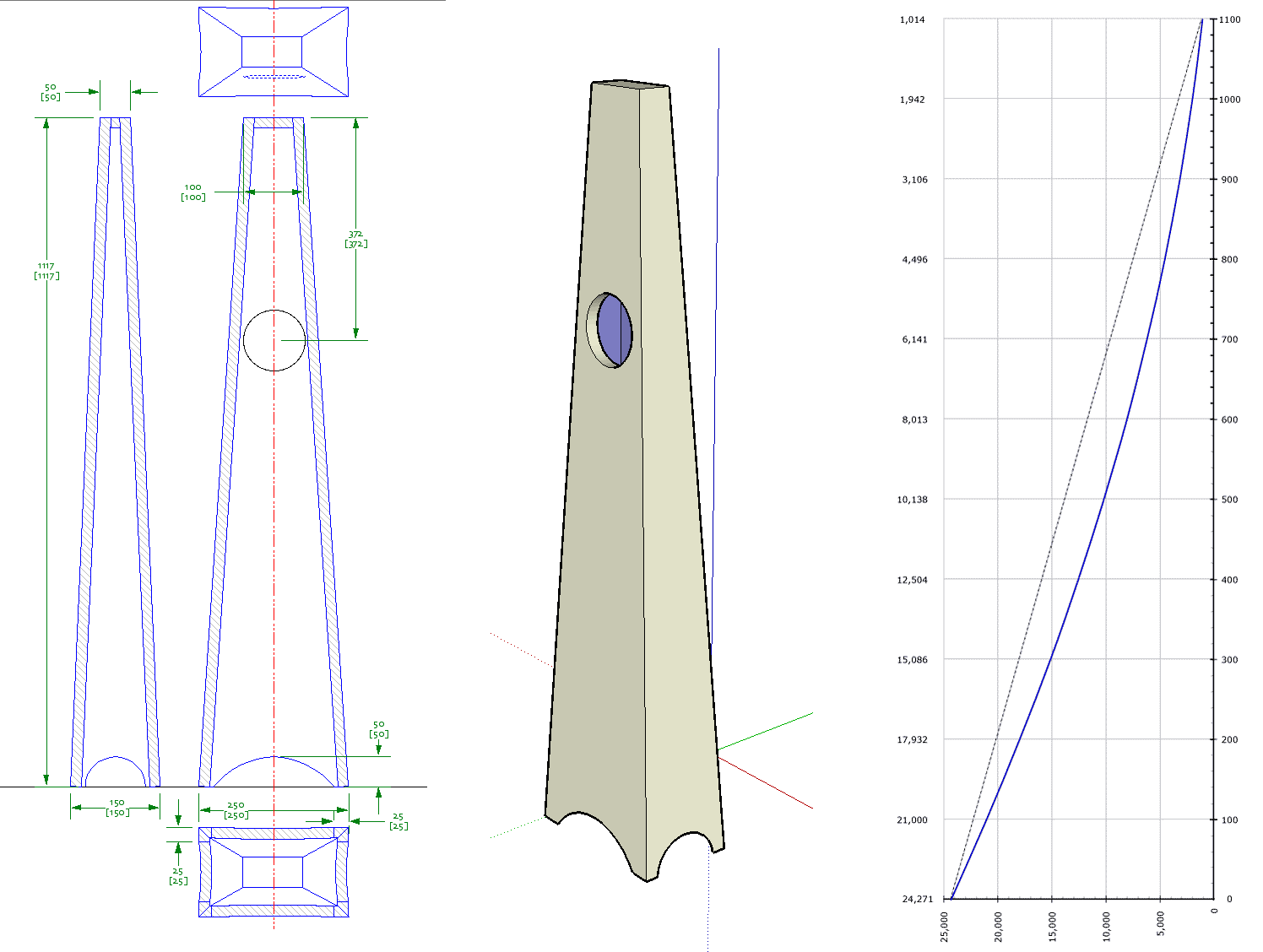

But there's a vent at the bottom, which makes it a ML something-or-other, no?
It is a Mass Loaded line with an exponential taper, but is close enuff to an ML-Voigt (ML-Horn) to use that model for simulation purposes.
Here the drawings of the original (not ML) FE108e∑ Metronome which shows the quadrartic curve (Met) vrs the linear curve (regular ML-Voigt).
dave
