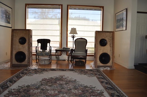

My old Fostex FF225WK Mets in their new home.
A friend bought them off me.
His cat approves
why did you sell them?
I sold them because, my omnidirectional folded Mets outperformed them in my room.
As I only have a 12 x 13 ft listening environment, the OmniMets were just a better small-room solution.
The big ones are now in a much larger room chez my friend, and doing serious biz, so everyone's happy.
