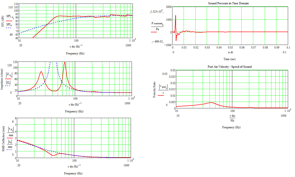

everything seems to point to the 208eZ as the best choice for me, so at this point the plan is build Met with 208eZ - There are specs on the Metronome chart for it - are they accurate? or have you re-modeled it since? I assume the 0 measurement in S0 means the front and back just meet there. Could look cool if mitered well.
Thanks again for your help.
Assuming a high output impedance amplifier, revised Met. for the 208ESigma.
L = 68in
St = 4in x 3in
Sl = 12in x 10in
Zd = 34in
Vent = 4in diameter x 1in long.
Line top, back & one sidewall with 1in acoustic fiberglass or similar & adjust this & duct length to suit. Stock it's a flat alignment tuned to Fs as you can see. The downward firing vent will give some damping effect depending on how large you make the legs & the surface it's standing on.
