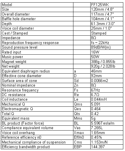

I had the Fs wrong- Its 32hz, not 35 according to the spec sheet. Of course, the numbers I supplied are insufficient. Did you use the numbers from the Faital website?
Yes, Fs is actually a little lower using Mms, Cms, though it's all academic since your drivers will measure differently, hence my suggestion to oversize the cab a bit.

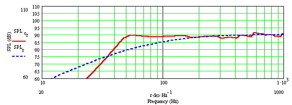

Given my druthers, I'd make it 84" i.d. with a ~404.86"^2 i.d. base area, 10" dia. x 0.75" reflex vent, driver down at 42" and put any super tweeter below it.
Sims are minimally damped:

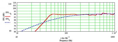

Excellent. I was going to ask you about the height. Thanks for the help. now all I have to do is build them…
The response curve in the right shows the longer line? They look almost identical, except for a small dip or shelf in the response about 200hz for the longer line… Is there another performance aspect that makes us prefer the longer line?
Correct. The longer path-length increases loading on the vent, i.e. better damped as noted in the lack of a 'saddle' in the ~45-135 Hz BW [slightly under-damped] and 10" dia. Vs 8" dia. vent. Ideally we want the vent area [Av] to = Sd = ~12.61" dia., but it would be long enough to require folding it, which would be a lot of extra work for a relatively minor amount of increased damping that can be done by increasing damping at the closed end.

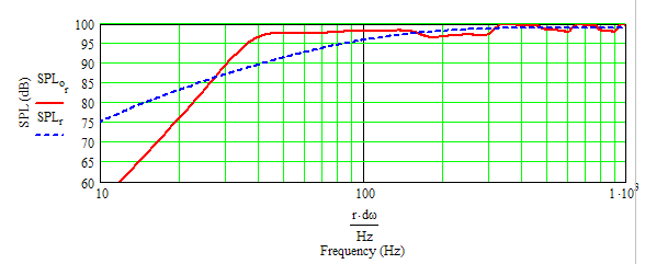

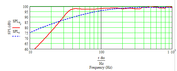

I ran MJK MathCAD models of the FF125wk Met using the dimensions for the FE127e. It does work, but can be improved with a little tweaking. AFAIK there is no single, absolute solution for cabinet dimensions--there is always some wiggle room. The dimensions I settled on look OK to me, but someone else may find a slightly better solution.
I decreased the internal volume a bit, increased the length of the port, and increased Zd by 2". Changing Zd resulted in a bit less ripple in the SPL plot, but leaving Zd at 20" works OK--the ripple is then about what it is in the Mets I have built. So you can choose between higher driver placement and a little less ripple in the response.
Plotted response is for enclosure dimensions:
L= 48"
So= 2 x 2"
Sl= 7 x 5"
Zd= 22"
port: D=2", L=3"

Jim, many thanks for these dimensions - I will go with the increased Zd.
Just to make sure that I am going to get the damping right: from reading the posts I gather you only line the back wall with 0.5" undercarpet and have some acoustic fluff above the drive if needed?
