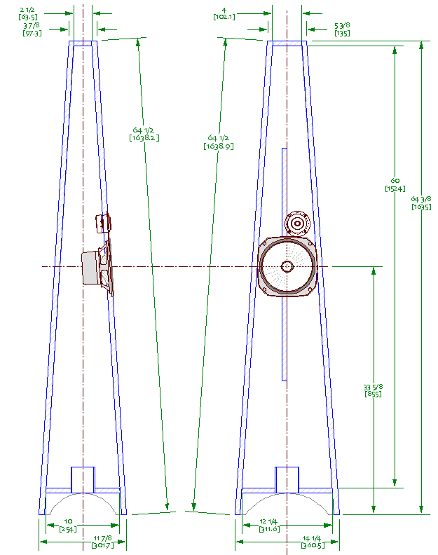

Hi, I was wondering, how critical is the placement of the driver in the metronomes? is the total length of the chamber the important factor, or is the ratio at which the driver divides it equally important? I notice for most metronome designs, the driver seems to be placed at around 700-800mm off the ground.
Would it be possible to mount a driver around 1100mm off the ground? For example with the Fostex 168eS design - it would be tall enough to encompass a driver mounted so high, but would that ruin the design?

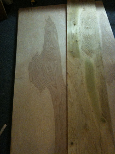

Starting a fe207e Met
I got the urge to build to use my old saws lately and decided after remodeling the bathroom cabinets I should take on making some speaker cabinets. At first I was thinking of using the fe166en and building angular spiral cabs they are small and seem that they would sound good. http://www3.ocn.ne.jp/~hanbei/eng-angular.html Helix-AG200BS. I could not find much info about anyone who have tried building these. Regardless I set out to make them. Then the miss of my life decided something tall and cool looking would be better. So I went looking for plans for a fe166en met and found they would probably fit in the cab for the 166e nicely. I accidentally clicked on the FE207e plans and had transferred all the measurements to the wood before I noticed. I had not ordered my drivers yet so I decided it was easier to just change that then erase. So here I go 2x fe207e are on their way and I will start cutting wood this weekend. Wish me luck Im excited about my first DIY sound project. Included for your viewing pleasure... very low quality cell phone pics. Showing my use of plywood as a straight edge and my lovely 2 pieces of birch 5 ply 4x8s. Flicker shots for full quality. Advice and comments welcome.
Would a pair of small mets that fit on top of the 207e maybe a 1in driver be possible, design wise, to fill out the high end. Think of it as a double decker met. That way I could still match the style. Or would that distort too badly or any other holes you can poke in the crazy idea.
It would be elegant, but you want the helper tweeter as close as possible to the 207. The usual candidates are the Fostex FT17, FT96 or a set of the Foster horns out of the Radio Shack add on pods if you can find some (i have a stash)
With some aforethot (in particular placement of any holey driver braces), these can be retrofitted if need is determined.
dave

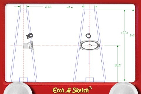

So it would be better to put a FT17 or 96 in the metronome with the main driver?
A-la the poorly altered diagram. Pardon the quality of my diagram Im computerless right now. Is there any magic math for the placement of the tweeter or design principals I do not know?
