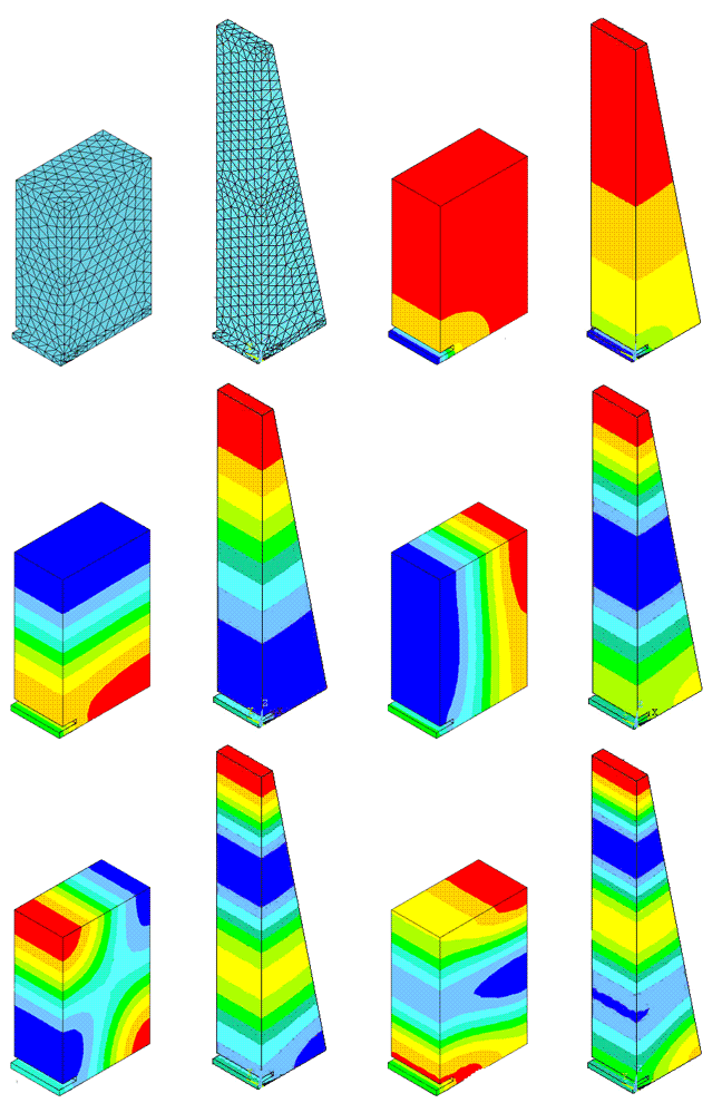

Can one of the Metronome fans please explain why this cabinet is not just a simple Bass Reflex?
Sure looks like one to me, (single chamber box, tuned port) but I must be missing something in the tuning. Does it have to do with length of the cabinet, driver placement, stuffing, something else?

The BIB is obviously a different beast, so are the TQWT that I've built and heard. But I'm still skeptical of the Metronome. (Not skeptical that it sounds good).
That sealed bottom with a port. Hmmm....
Gotta think about this one... :scratch:
Illustration based on ANSYS simulations by Martin King for the article cited below..
For the whole story:
Design and Construction of a Mass Loaded Tapered Quarter Wavelength Tube (ML TQWT) Using the Fostex FE-164 Full Range Driver. By Martin J. King, 4/21/01
here http://www.quarter-wave.com/Project02/Project02.html
They show a BR box and an ML-TQWT resonance behavior. These pretty clearly illustrate the different behavior of the 2 boxes.

Just to extend that a bit; here's the short version.
The Metronome is (now!) a Mass Loaded Quarter Wave Resonator. All pipes that are open at one end and sealed at the other resonate at 1/4 wavelength of a particular frequency. The frequecy at which they resonate is determined by both line length and the taper ratio. The traditional 'take a frequency and /4 to get the length of a QWR' only works for straight, untapered lines. A positive tapered pipe (i.e an expanding line, which really is a variation on the horn theme, when all is said and done) needs to be considerably longer than a straight pipe for the same tuning frequnecy, while a negative taper pipe (i.e one which starts wide and gets progressively narrower) can be considerably shorter. See Martin King's Classic TL alignment tables for more detail.
When you mass load a design; you restrict the area of the terminus; usually with a slot port, or a circular port of the type used in reflex cabinets. The air-mass in the choked off terminus places an additional load upon the quarter-wave resonance generated by the enclosure. This in turn lowers the frequency of the fundamental resonance, and also, usefully, dramatically damps down harmonic resonances. You can tune the response to an extent by adjusting the size of this choked terminus -longer ports provide more damping, shorter ports less. Ditto for diameter: the narrower, the higher the damping applied.
On a graph, the response of a well designed MLTL (I actually prefer the moniker ML QWR, but most people are more familiar with the TL, even if it's not a particularly accurate description of this sort of cabinet) can look fairly similar to a well designed reflex cabinet. However, the fundamental approach to creating the response is very different; in addition, they rarely sound the same; the MLTL having a cleaner presentation in the bass and midrange; helped by the stuffing, and the careful tailoring of cabinet resonances.
Hope this helps

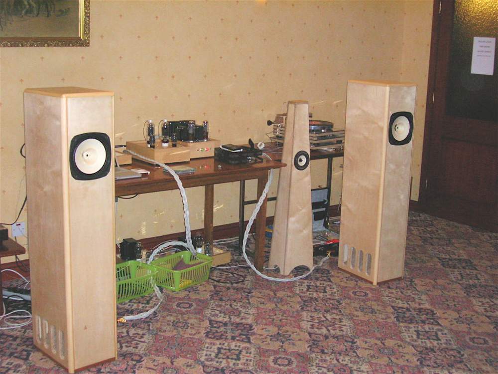

Hi Guys
Reading the posts concerning Ed Swift's (Vitalstates) big Fostex TQWTs I thought I'd bring this topic to the top again.
Below you can see a picture of Ed's speakers at EggFest, along with my Metronomes, being driven by my PT15 SE amp setup.
Playing Robin "Trower's Bridge of Sighs" on vinyl they kicked butt like few other speakers I have heard.
Just a note on the Metronomes.
Dave's phase plug mods have worked superbly on the drivers giving a lovely sweet, open sound.
I'm also currently in correspondence with a guy in London who is building a pair from English oak with the phase plug mod.
That's nice because soon there will be two Metronomes on the planet instead of the current one.
Along with Ed's TQWTs things are moving in Blighty!

Regarding the sub issue. These speakers integrate so well with a good active sub that when they were being demoed at EggFest not one person detected the prescence of the subwoofer.
A couple of people could not understand how such a small speaker was putting out such low frequencies until I pointed out the sub in the corner.
The only time it was detected was when I was doing my sound check at the beginning with a bit of Joss Stone and it was quite obvious that the sub was far too loud. Once it had been adjusted for the room it disappeared.
